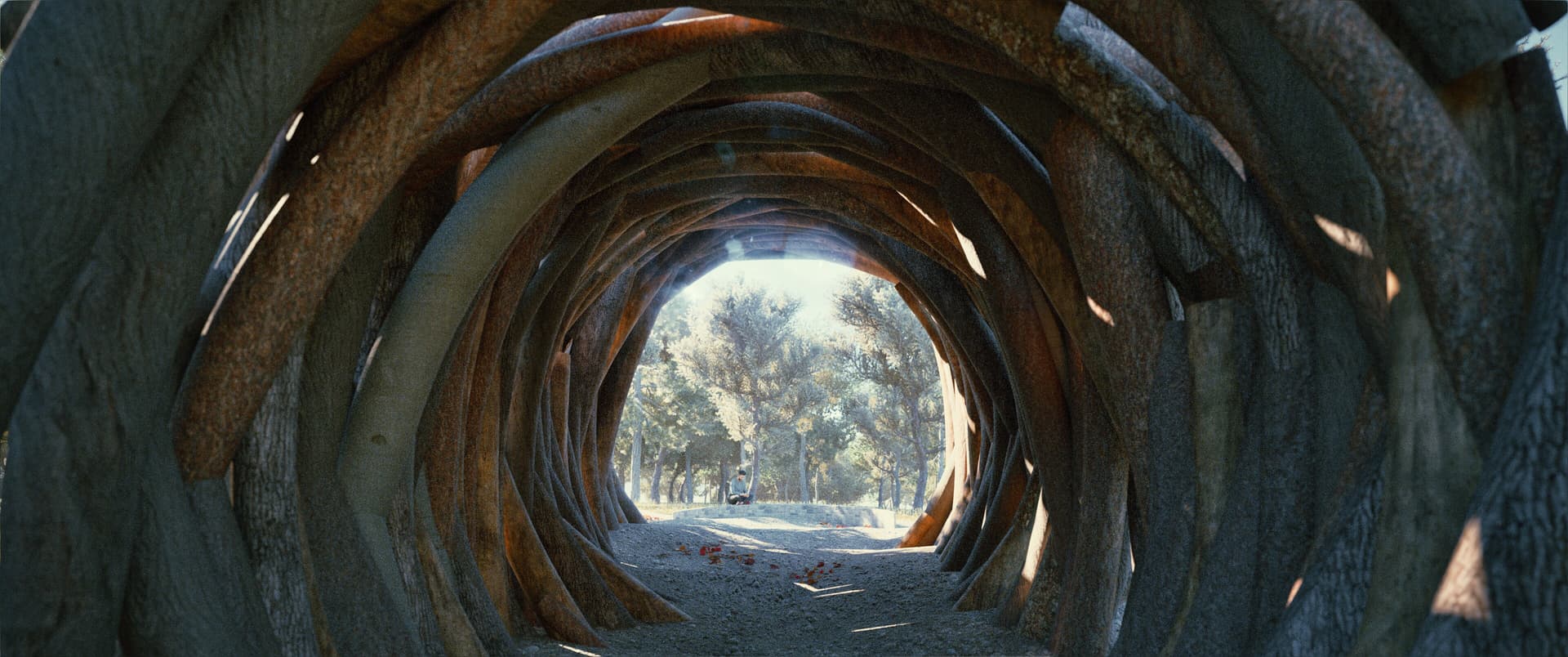

I have this cylinder-shaped closed poly surface. When I UV-mapped it in Rhino and saved it as a .udatasmith file for Twinmotion, the materials were not applied correctly. Is there a way I can fix this?
Below is a part of the file I’m using

Actually @Nate_X , after looking deeper, the texture mapping issue exists in Rhino too. Where did you create these custom UVs? The fastest partial fix here would be to select all of the objects and switch the mapping type to Surface…
There will be some misalignments still because the tube walls are often several separate surfaces but it’s better. The only other solution I see is to Unwrap each with the long edge and ends selected as seams.

I am unsure of the best way to make the final render look realistic. I think it may be best to unwrap along the seam and fit the UV to the tile.
This is how I’d Unwrap these objects. If you have a texture map that tiles seamlessly it will work best. MatchMapping will use the UV meshes of a source object but this won’t work in this case as the objects are not the same size and in the same location. I think you’ll either need to unwrap each or model the objects as single surfaces to then use surface mapping.
Thanks I’ll give that a try because the renderings I’ve made so far have not been as realistic as I was hoping for.

You might try if you haven’t already, is use some assets from either Quixel (now fab) they have some nice logs and branch objects or sketch fab they both have direct links within Twinmotion.
You could mix some of them into your project to make it more realistic. One thing is to try to cover the junctions where your logs meet especially where two different logs with different textures meet.
The ends of your logs in some areas seem too regular, too similar in size, you could try to add a few logs with different end cut styles instead of one cylinder cap for every log, maybe try displacement or hide the obvious areas with Quixel scanned logs.
Nice project looks like a public sculpture or installation. We have similar projects being done in some of the park districts in Chicago where kids get to help build or make there own from smaller cut wood that would be otherwise be landfilled.

Thank you for the recommendations. I was using 2K materials from the Megascans library, but I haven’t tried any Quixel assets. I will give that a try.
