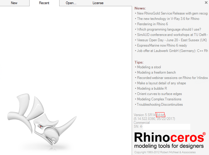

Hi Charles.
When it comes to Rhino 5, both Heron and Elk work only on 64 bit version of it.
Gismo supports both 32 bit and 64 bit version of Rhino 5. Did you try to install Heron and Elk on Rhino 5 32 bit?
Hi djordje,
I found only 1 grasshopper folder on my PC. I suppose the folder is for the Rhino 64bit. So I have no clue how to install elk and Heron for Rhino32bits
Hi Charles,
You can check your Rhino 5 version by selecting “Help -> About Rhinoceros” and then check what stands in the following window:
Rhino 6 does not have a 32 bit version.
