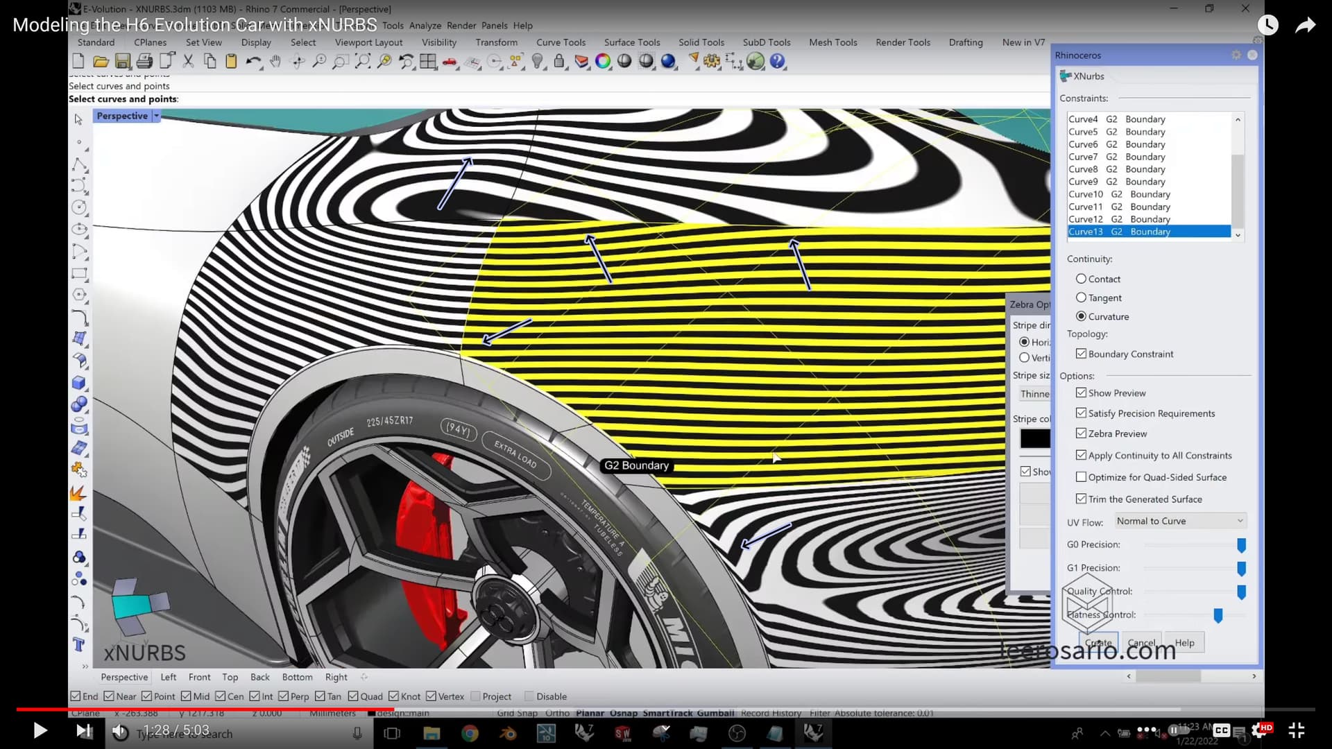

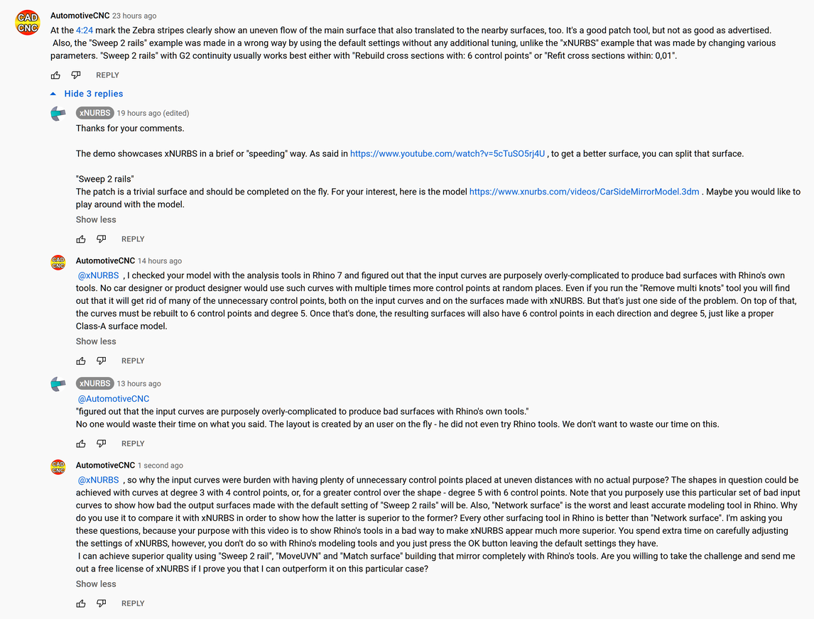

Take this video, for example. It shows a bunch of low quality curves populated with an unnecessary amount of control points placed at random locations to make the modeling more difficult.
We are having a nice civilized conversation with the gentleman on YouTube under this particular video and he is yet to answer why the geometry in his videos is always setup to perform very badly with Rhino’s surfacing tools prior capturing the videos where xNURBS is eventually shown as the proper solution for these fabricated “difficult cases”. He also tends to compare xNURBS with “Network surface”, which is not a correct way for comparisons, because the latter uses approximation of the input geometry, heavily depends on the user’s settings (which he never does and just clicks the “OK” button) and is widely known as the least good surface tool in Rhino. He also makes some quick comparisons with the “Sweep 2 rails” tool, but again, all he does is to immediately click on the “OK” button with the defaults settings, rather than trying some proper settings prior that. Again, xNURBS is a great tool, but I think that it’s unfair to use such fabricated tactics. I know that it’s a business and companies or sales individuals why try hard to present their products as the best of the best, but at the end of the day, there must be some degree of honesty. It’s like taking a Ferrari on an off-road trip and claiming “That car performs really badly on that rough surface”.

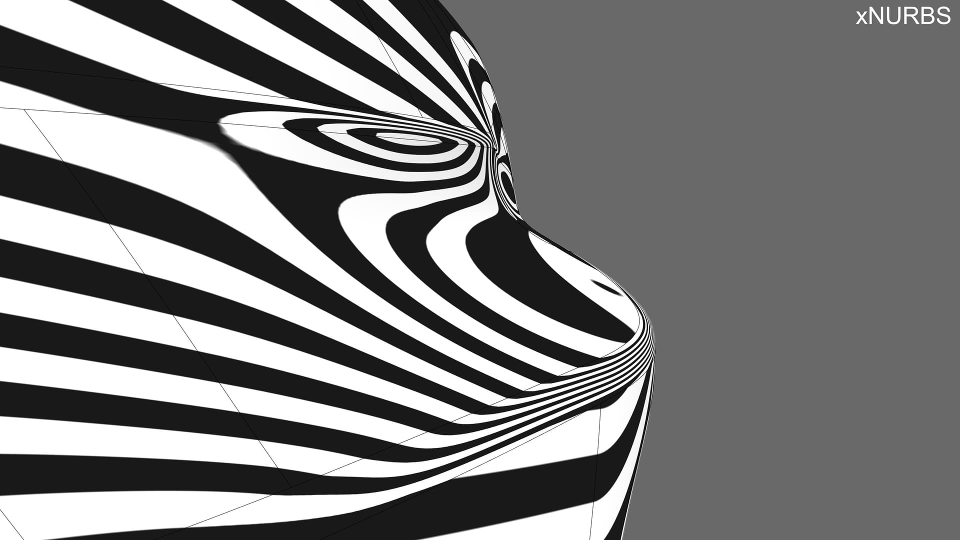

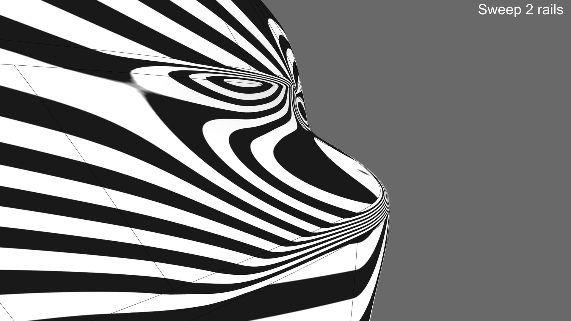

Looking at a more extreme angle make reveal wavy shape in the middle of the surface:
This particular angle also reveals some minor imperfections in my surface, too:
Since the xNURBS patch uses more dense surface fillets as input geometry at the top and bottom, naturally it has a more dense array of control points. Still performs relatively good around the edges, despite the wavy middle portion:
The “Sweep 2 rails” surface was additionally simplified via the “Rebuild surface UV” command, this is why it’s much smoother. However, it’s also optimized with the “MoveUVN” tool to better control the highlights:

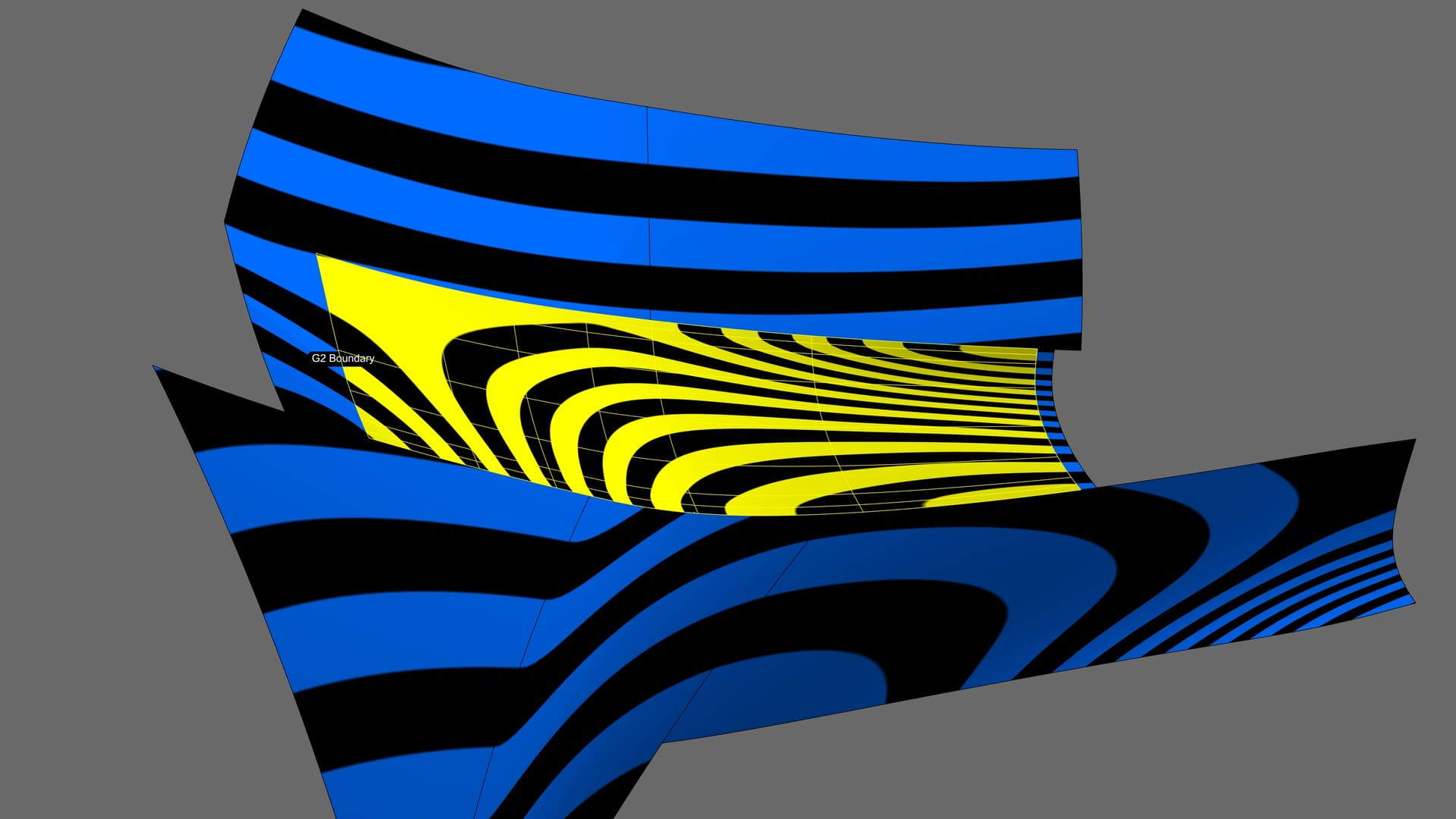

xNURBS was incapable to solve that simple 4-sided transition, despite using G2 continuity on all edges:

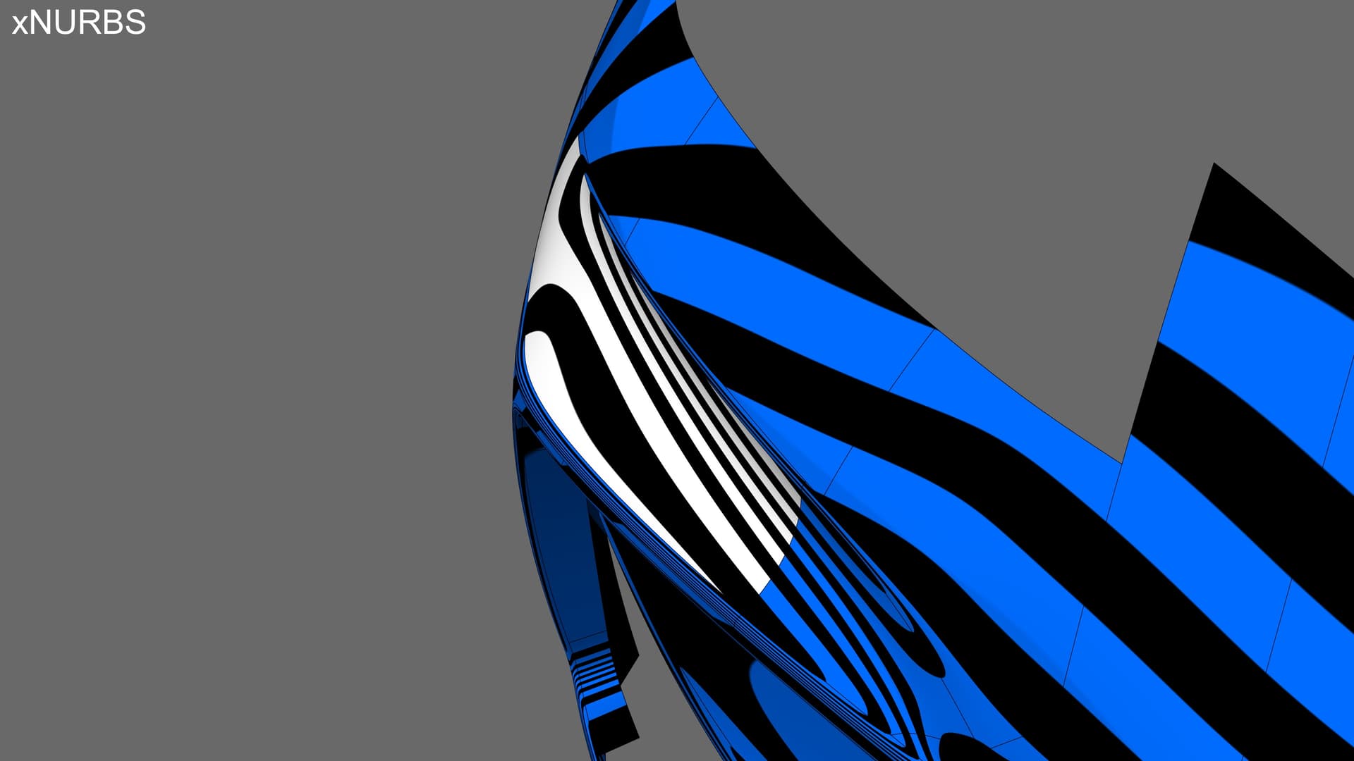

Another extreme angle that reveals the unevenness of the “optimized” 4-sided surface patch created by xNURBS:
“Sweep 2 rails” also showed some minor unevenness at the middle, but it was still much smoother:

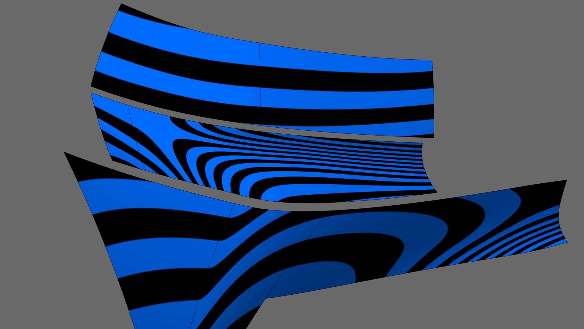

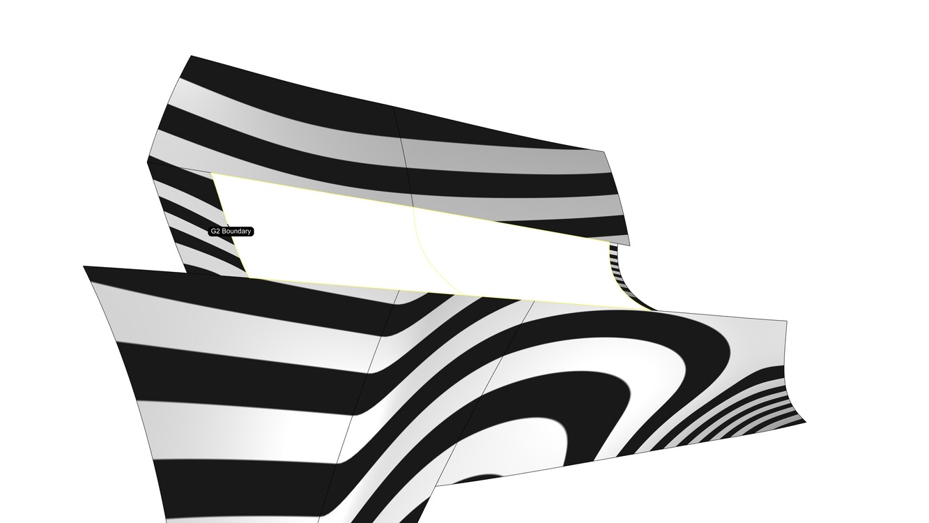

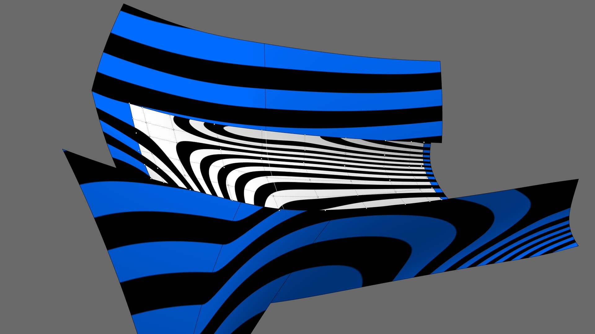

Lets use the original, untrimmed surfaces to build a 4-sided surface with xNURBS. Zebra analysis is used and control points are shown to check the surface topology:
With hidden control points:

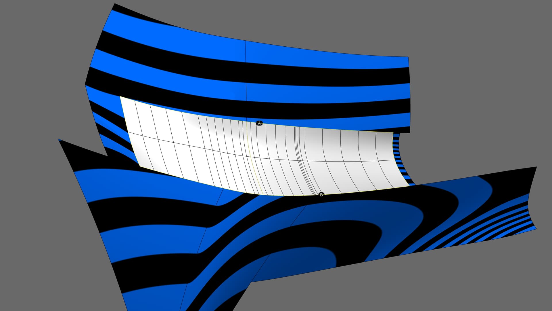

xNURBS fails to build an optimized 4-sided surface IF the non-boundary curve in the middle (note: the curve appears “invisible” due to the while background) is being selected, despite that it’s snapped to the upper and lower surface edges. No matter which settings combinations is used, it fails. Upper and lower edges were set to G0, while the left and right edges were set to G2. Setting every edge to G0 also didn’t help:
However, turning off the “Optimized for quad-sided surface” option allowed to build some surface reminiscent of the Alps mountain system, despite the fairly predictable and simple input geometry:
An interesting shape, but not one that could work on this model:
xNURBS refused to build a 4-sided optimized surface, no matter what settings I tried.
I was forced to NOT use the profile curve at the middle, in order for xNURBS to at least build an optimized 4-sided surface. As seen in the picture, it was unable to follow the design intent since the curve remains unused:

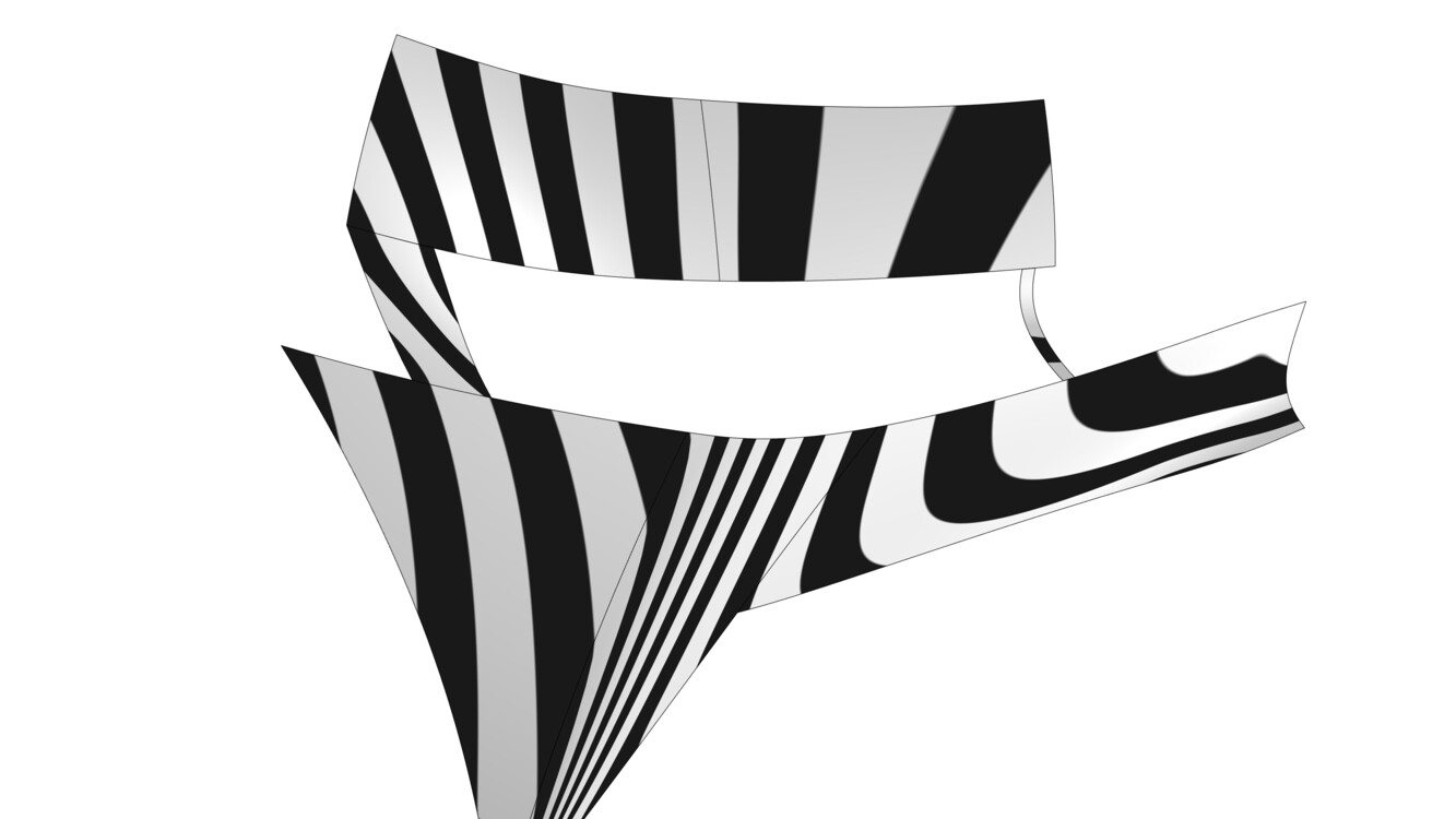

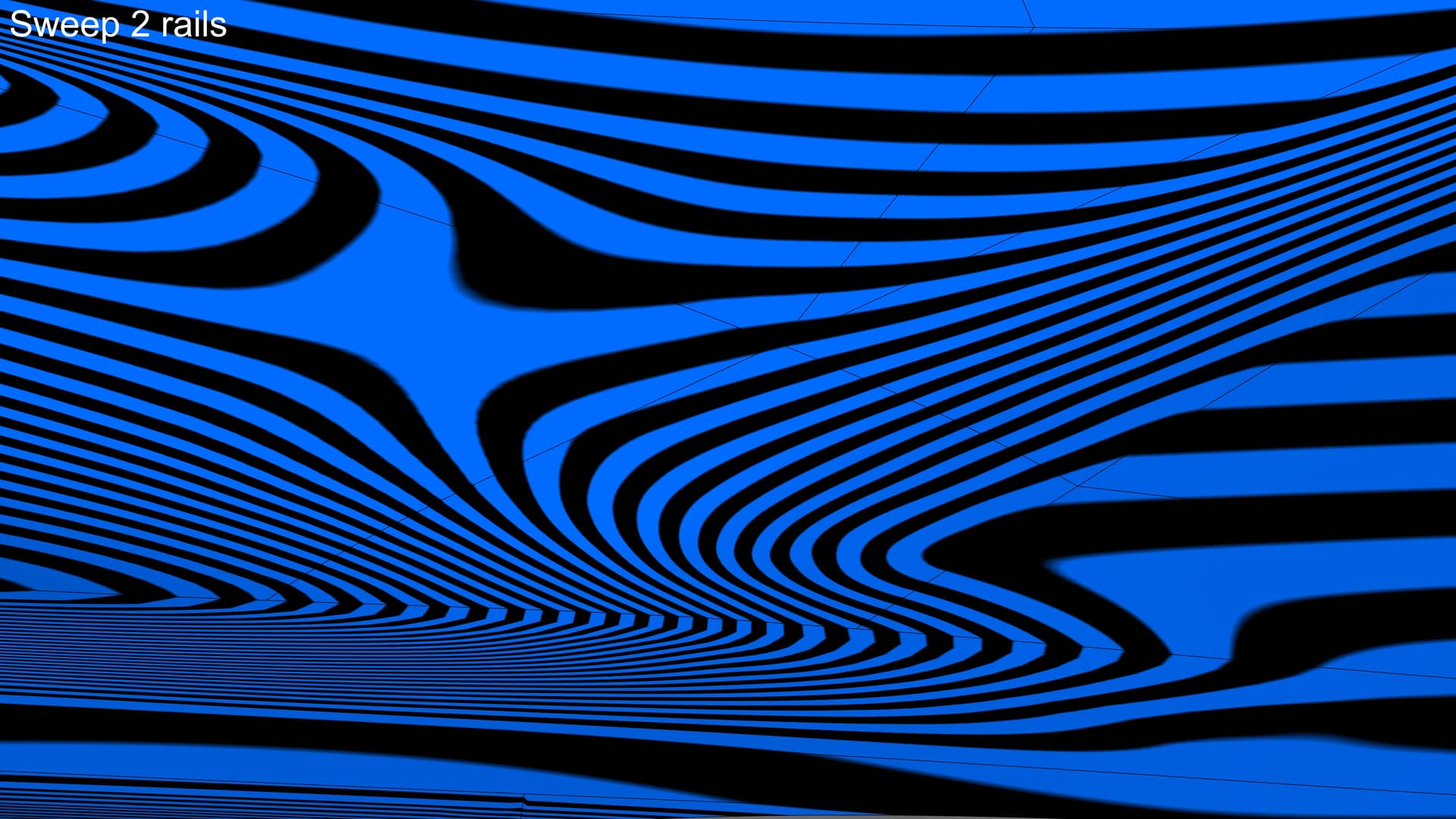

“Sweep 2 rails” in action:
The Zebra analysis reveals the unevenness of the resulting surface. No problem at all, since Rhino has two magical tools called “Remove multi knots” and “Rebuild surface UV”:

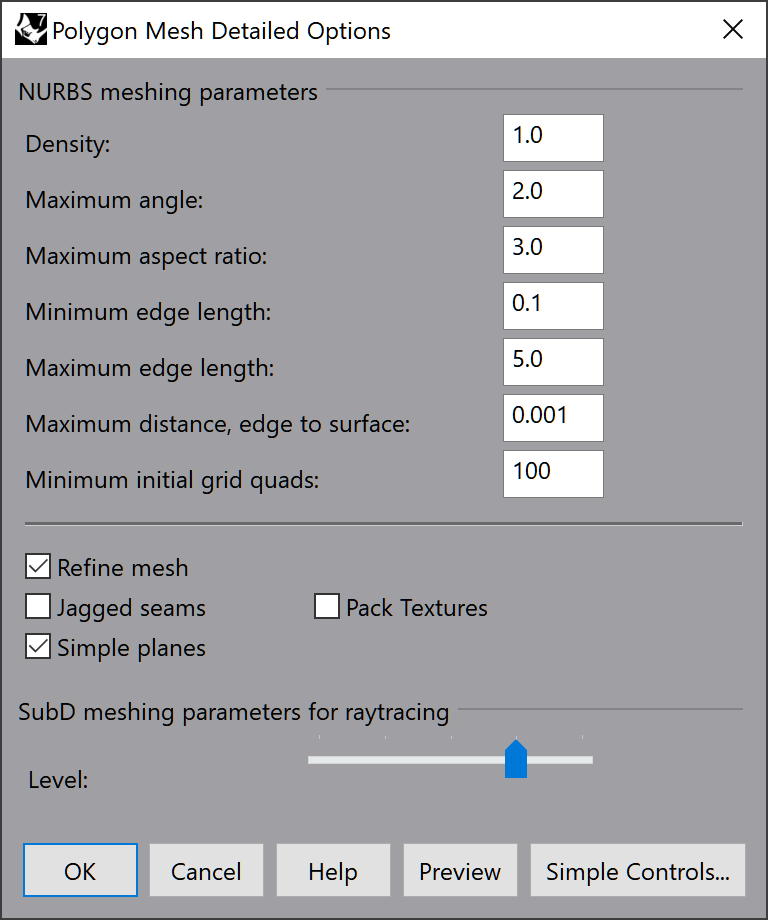

I suggest to use the following settings for the analysis mesh, because the ones that come with the file you provided were too dense and heavy for my poor video card: Nvidia GTX 1660Ti.
This is a quick fix of the geometry and some basic filling of the hole, but it’s not optimized and has plenty of flaws. I can’t stand G1 models with sudden change of the zebra stripes. I much prefer smooth blends. :sweat_smile:

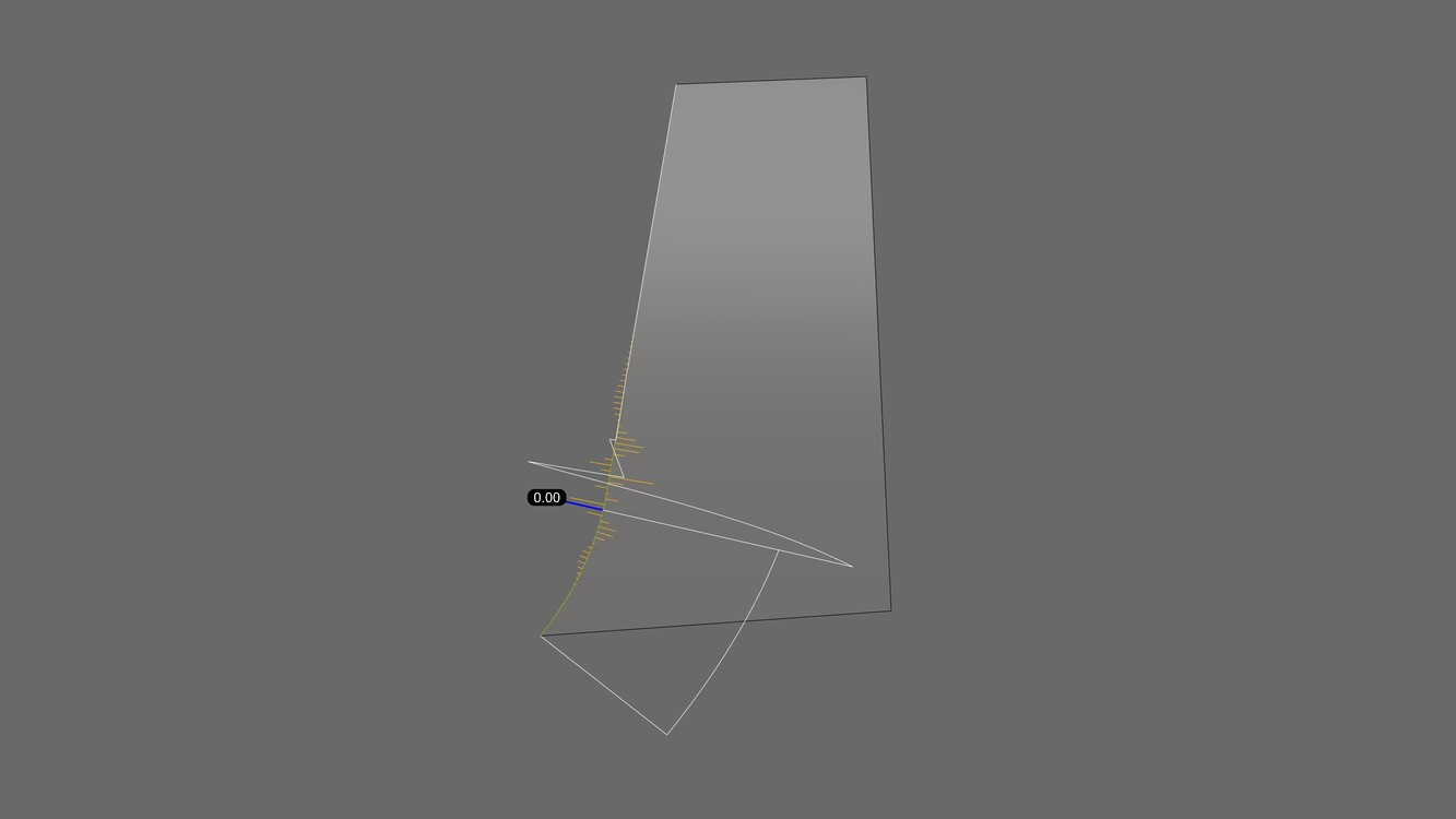

Another example where xNURBS for some reason fails to do its job, despite the clean geometry with G2 continuity across the input surfaces and curves. Before the video, I tried picking the curves and surfaces in any combination, but no matter which way, it always refused to build a patch surface at the moment I changed the tangency for the input edges from G0 to G1 or G2.
@XNurbs I modeled a similar surface that Bobi is showing in his video, see attached. How would you recommend building the tip in XNurbs? I tried to make it work but got similar results as the ones you see in Bobi’s video. Also the top blendsurface that connects the two sides, can’t be exactly built with XNurbs, the transition becomes more abrupt:
lofted_tip.3dm (2.3 MB)

We did not reply “Bobi Rhino_Bulgaria” because we think he/she may be a troll: When we added xNURBS to Food4Rhino, someone immediately used a fake ID to give 1-star rating on Food4Rhino. After the troll was identified and 1-star rating was removed, “Rhino_Bulgaria” came into our sight. We have no idea how many 1-star ratings “Bobi Rhino_Bulgaria” contributed to xNURBS on Food4Rhino (anonymously or using fake IDs).
Quote from the xNURBS manual: “When selecting the Optimize for Quad-Sided Surface option, no internal constraints is allowed.”
The manual clearly explains why. If “Bobi Rhino_Bulgaria” did read the manual, then I would say “Rhino_Bulgaria” intentionally did this.
It makes it very difficult to understand what “Rhino_Bulgaria” did. We figured out what’s going on from the following picture. Why didn’t “Rhino_Bulgaria” change to the 100% white color?
The car side mirror demonstration only shows a quick rebuild. The curves are quickly extracted from an existing model by a designer and then projected to a plane so that they are on a plane. This may be the reason why the curve quality is not ideal. We did not even check the curves. So how could anyone intentionally “create” the curves? During the speed design, no one want to spend time to carefully design or modify the curves. For the final production design, designers generally cannot modify the existing geometries. For a student design, you can easily ask ideal “input”, but for anyone who worked on complex products, e.g., automotive model or airplanes, it may not be the case.
Again, the car side mirror demonstration only shows a quick rebuild or speed design. If you really want to see the model created by professional designers, please see this model.

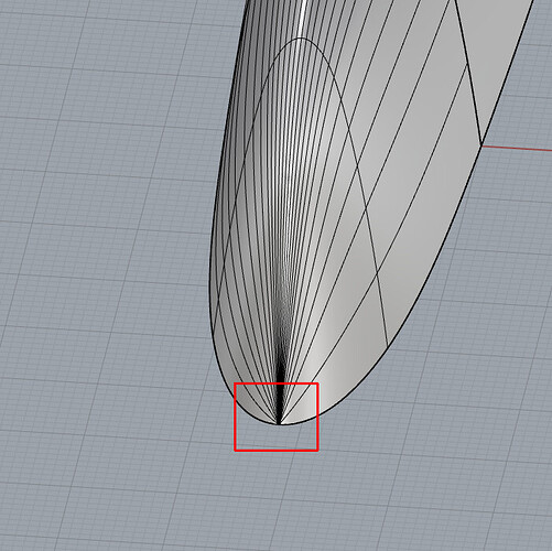

@Gijs, There is one mistake in your model:
This is called a singular point, where the surface normal disappears. Singular points cause many troubles, e.g., the screenshot below, and software developers and professional designers try their best to avoid such a design. I am sure you are a professional designer and won’t present such a design to your customers.

I’m sorry, but your false assumptions about who is a troll are completely wrong. That must be another person on Food 4 Rhino, not me. I would never rate someone’s work or software with 1 star, even if I’m not satisfied by the results. :slight_smile: I much prefer to invest some time to explain the pros and cons of some product rather than voting with 1 star. I started this topic, because xNURBS is advertised with huge amount of hype and overpromising, but in practice in many cases it clearly underdelivers.
I recommend you to focus on improving xNURBS and advertise it in a more honest way, which also includes proper comparison with Rhino’s own tools. In your videos you (or someone related to you) often tend to use purposely bad geometry (split edges with tiny jaggies, curves overloaded with unnecessary amount of random control points etc), in order to make Rhino’s tools perform badly and make xNURBS shine in comparison in those wrong situations.
Also, as I mentioned in my original post, you always use the very basic default settings of “Sweep 2 rails”, “Blend surface” or any other Rhino tool and don’t invest time to try their other options, because that’s another easy way for you to make them perform less effective in comparison, unlike the time you devote to optimize the settings to build a surface with xNURBS. It’s like driving a sports car like Ferrari on a rough off-road terrain and then claiming that it performs poorly. Of course it will, because you purposely drive it in a wrong way. This is why the topic is called Unfair and set-up comparisons by xNURBS. :slight_smile:
Looks like either your Rhino is rendering this area badly, or my Rhino does it nicely, because the model uploaded by @Gijs looks like this in my Rhino 7.
bobi, you are extremely confrontative and i dont see many reasons why you would do that, other than being a double spy for real :wink:
many of his user cases are generic, not specifically done purposely to show how bad rhino performs. seriously calm down.
Why would you use the word “professional” while you write about that particular 3d car model? Send it to me and I will easily point at least few dozen areas with bad surfacing on it. Many of them are easy to spot even in the YouTube video, but I can show you all the wavy areas and lack of good continuity using Rhino’s analysis tools, in case that you wonder how professionally made is this particular model.
As for the curves on your mirror model that were overly populated with random control points in uneven distances, a simple use of one of the several tool in Rhino to simplify and rebuild the curves witinh the desired tolerances will give you much nicer input curves to build better quality surfaces with xNURBS or any surfacing tool in Rhino. It just takes a few seconds to press the proper icon in Rhino to fix those improper curves. The surfaces made with xNURBS on that mirror have several wavy areas and inconsistent flow.
I watched the video several times, but I’m unable to see a single xNURBS surface that’s able to achieve even G1 tangent continuity in some areas. Every single surface in the video tested with the Zebra analysis has a certain amount of waviness and inconsistent flow, as well as noticeable lack of smooth transition between the surfaces. Don’t get me wrong, I’m not trying to say anything about the professional designer who created that model, I only comment on your bold claims about the quality, because the Zebra analysis clearly reveals deviations that are in contrast with the promise. If you try Rhino 7’s Edge continuity tool to examine that particular model, it will conveniently show you where the greatest deviations are located.
