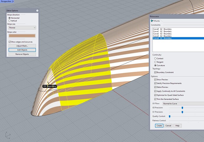

@XNurbs I don’t get that weird zebra on the surface I sent either, and yes, I am well aware about singularities. I know when it is a problem and when to avoid them. In this case however, it is not the point of attention. The surface can easily be over-modeled and trimmed. This discussion is to get the best possible surfacing with the tools we have. So far the loft gave the overal best result in the shortest time, which is also an important factor. This is what I like about XNurbs the most: that in many cases you can have a very good result in almost no time where manual surfacing might be able to take it a step further but at the cost of a multitude of the time needed.

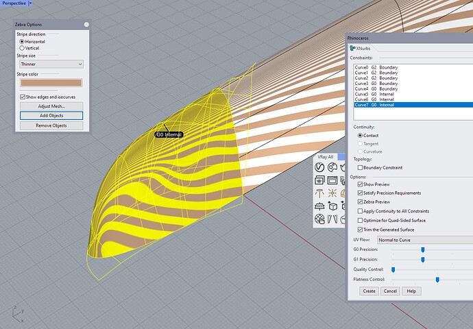

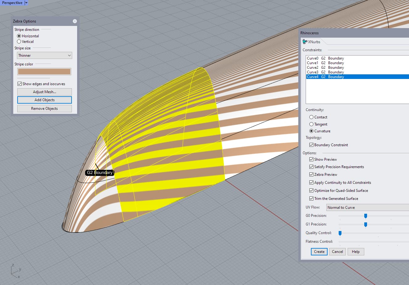

The method you propose gives an non symmetrical surface and with neither setting I can get a good flow:

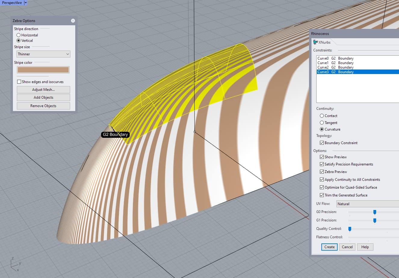

I did try other ways though to get a better result with XNurbs. This one is quite interesting where the lower surface is a blend surface and then trimmed, then filled with a Xnurbs with an additional guide point:
but the result is not 100% good flow.

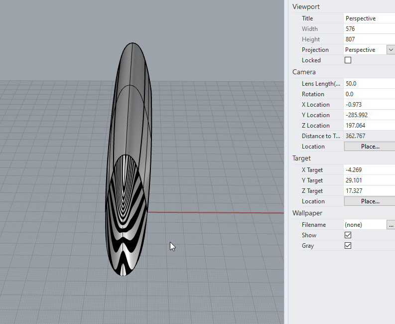

This GIF shows the weird zebra of singularities. Because of singularities, the quality and shape of the surface can be unpredictable and unreliable. I don’t think you could find such a design in the final car body for production.

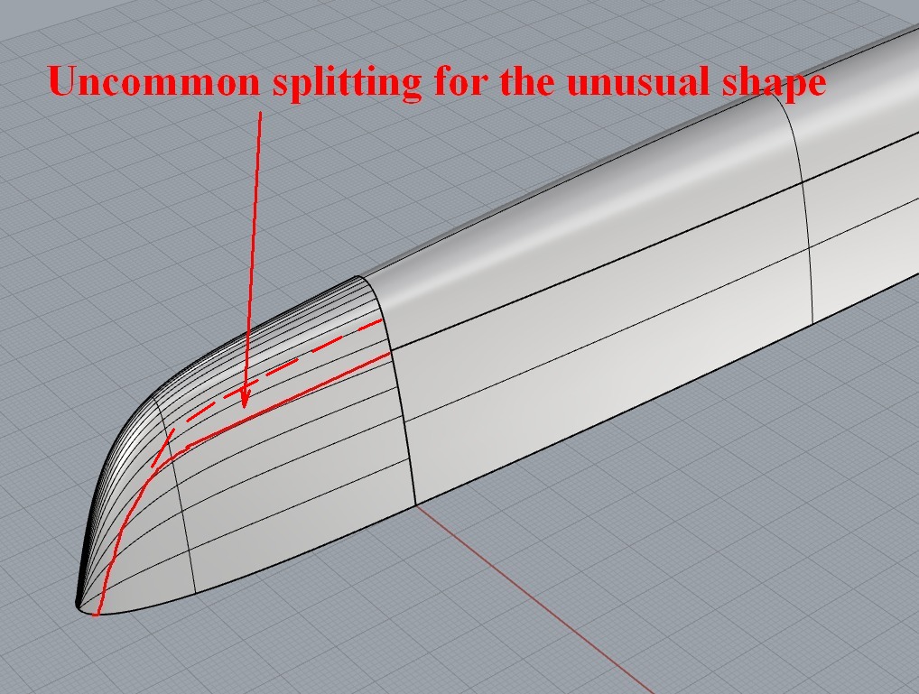

To get Class-A model, I suggest that you split the surface based on curvature. However, this is not a typical surface like a car body. The slitting is useless for common surfacing.
