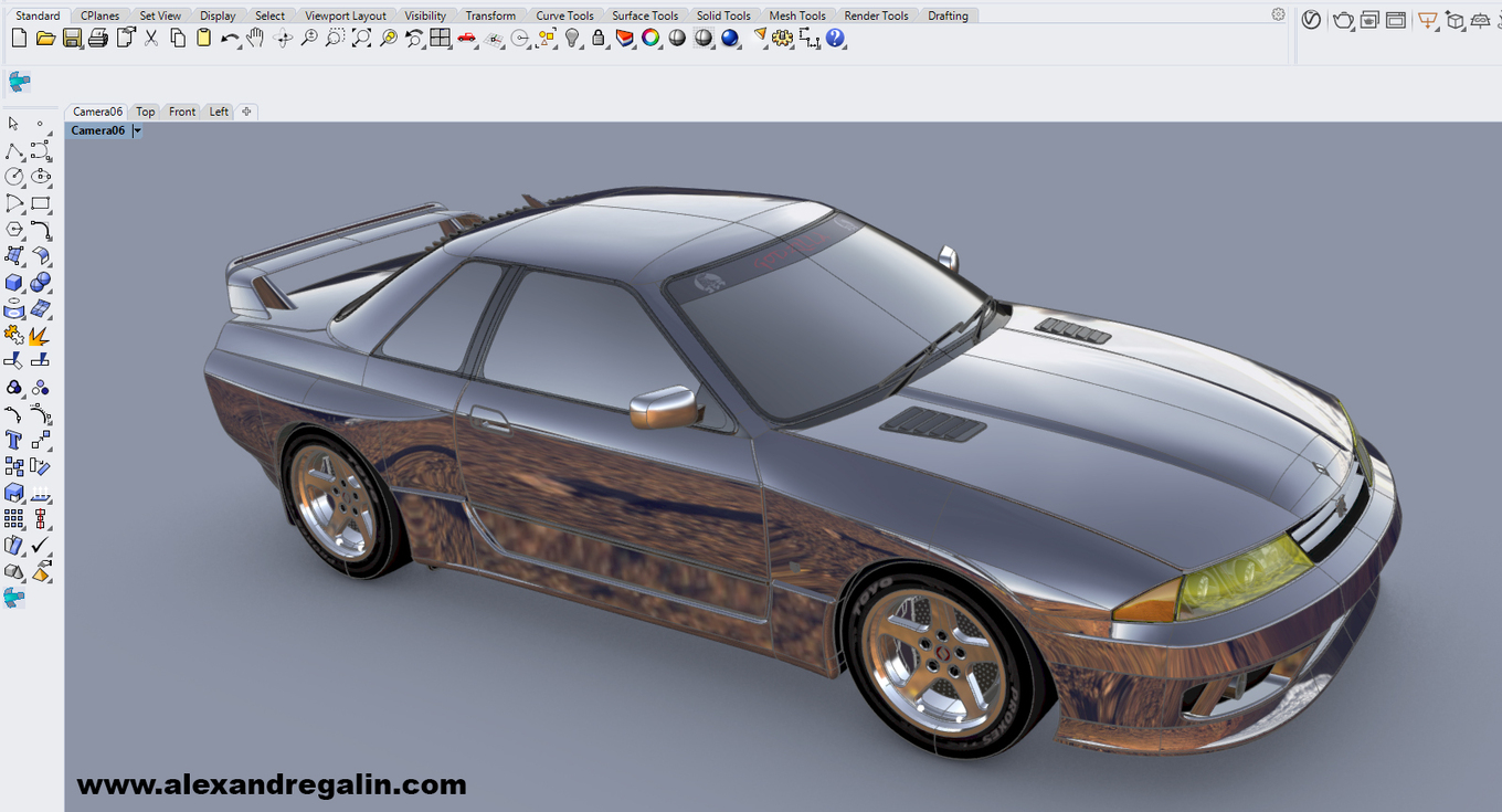

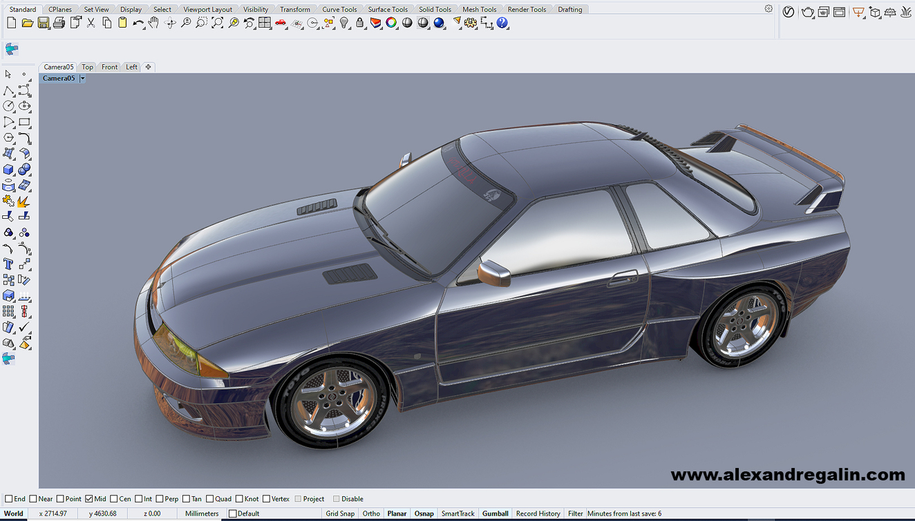

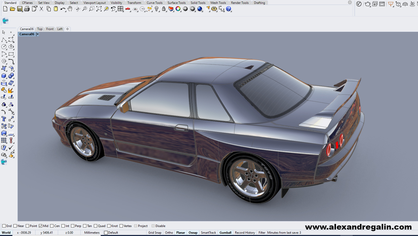

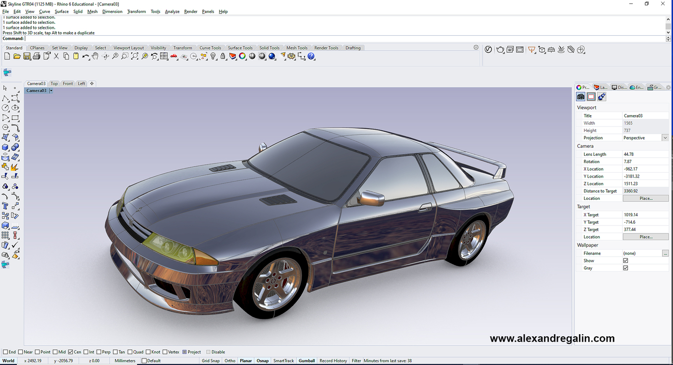

WIP Nissan Skyline
well done!!
nice! and what is the purpose?..
Thanks a lot Kyle,

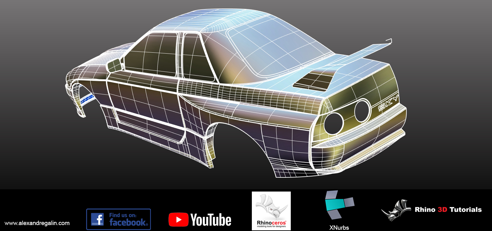

Have you tried XNurbs ? It s a pretty good plugin that complements well Rhino I think
Take care
Alex
Thanks Mikey, quarantine was the cause of this
Cheers
Pascal has been using it, I haven’t dipped my toes yet- Where are you finding xnurbs to be the most useful?
Keep up the always awesome work!
( i restored and currently own a 71 240z, so I’m a datsun fan as well)
Hey Kyle,
I find XNurbs particulary good when dealing with more than 4 edges. 5, 6, 7 and even more allows me to create nice, clean surfaces and I find it many times superior to the Patch function. I wouldn’ t say I would discard Patch as I see it work better in certain situations. But XNurbs is more than a patch function, It can be a substitute to sweep 2 rails, curve network as well. Transitions are nice and clean. it works in G0, G1 and G2 and that s about it. But that s good enough in many cases. They re working hard it seems on bringing improvements to the plugin as well, I hope this tool will have a brighter future with Rhino compared to VSR,
Cheers and looking forward to your excellent videos on Rhino V7.
Alex

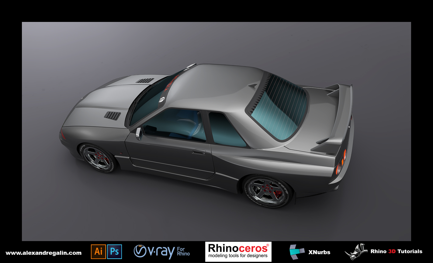

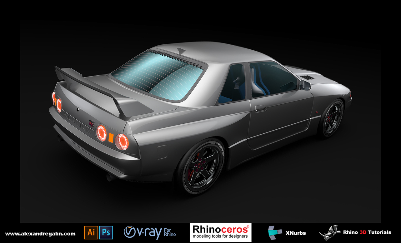

Completed work. Thank you all and have a great one.

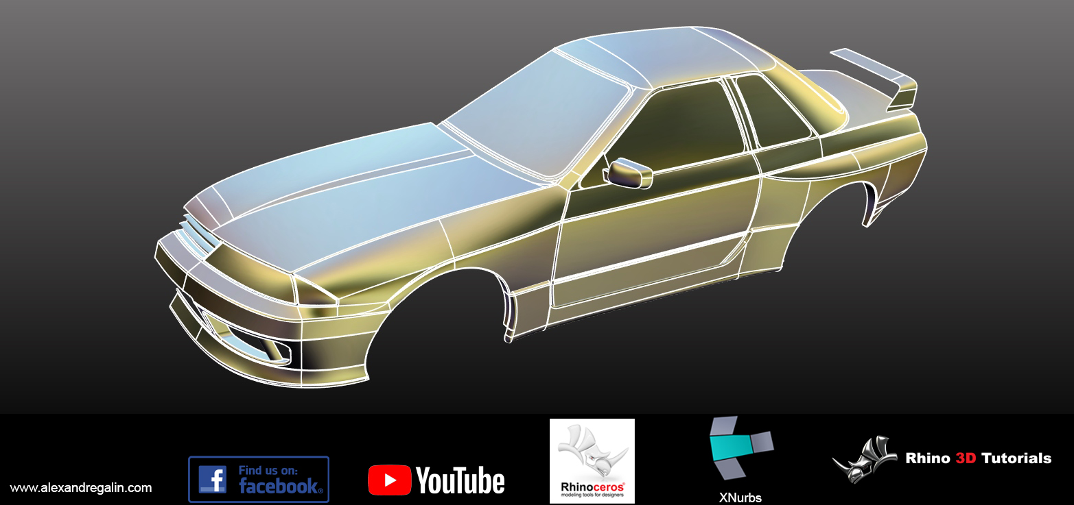

Delicious!! Few areas have irregularities and controversial patch layout decisions but A Class wasn’t a goal I assume plus V-Ray makes everything look better as always, so well done sir : )
Do you do class A work with Rhino? If so I’d be interested in picking your brain a bit as to how to make it easier/ better to do class A stuff in rhino-
I believe that it’s possible in theory but haven’t had an access to V6 or V7 to check if it so, for now running our good old fashioned V5 and it’s not even close to what one calls an A Class -surf :frowning:
First of all this is really great work! But as Mikey said its not class A. And why should it be? I don‘t think this model is going to be used for production. Any Software capable of doing Bezier/Nurbs surfaces can output class A in theory, practically its a pain in Rhino. True Class A car models are not created within 3 days but rather within 3 to 9 months by dozens of engineers
In addition to my recent post:
There is a even a big misconception about class A in the automotive industry itself. Some car designer even create design models under class A principles, some even can do this in 3 days. They call their work class A. They even think their surfaces are used for the production model later on to a certain extent. But this is actually really ignorant and arrogant. In reality all production models are completely remodeled from the design sketch, a clay model or a 3d design model. Designer could also create polygon models or non class A surface models much quicker if they would accept this truth. What a designer usually does not understand is the technical and functional component a production model must fulfill. This is also whats making the modeling process so difficult and time consuming.
