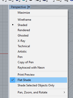

You can also tell the Rhino display pipeline to ignore the mesh facet weld angle by turning on “Flat shade”. It’s a display option or can be togged on/off by right clicking on the viewport name:
Thanks John, in this case my goal was to create an asset in this low-poly aesthetic, so unwelding is what I need. Changing the display would affect other stuff in a scene.
That’s true.
I use Flat shade a lot when I’m slogging through mesh clean up so I can see what’s going on better. I also usually set an ugly backface color.
