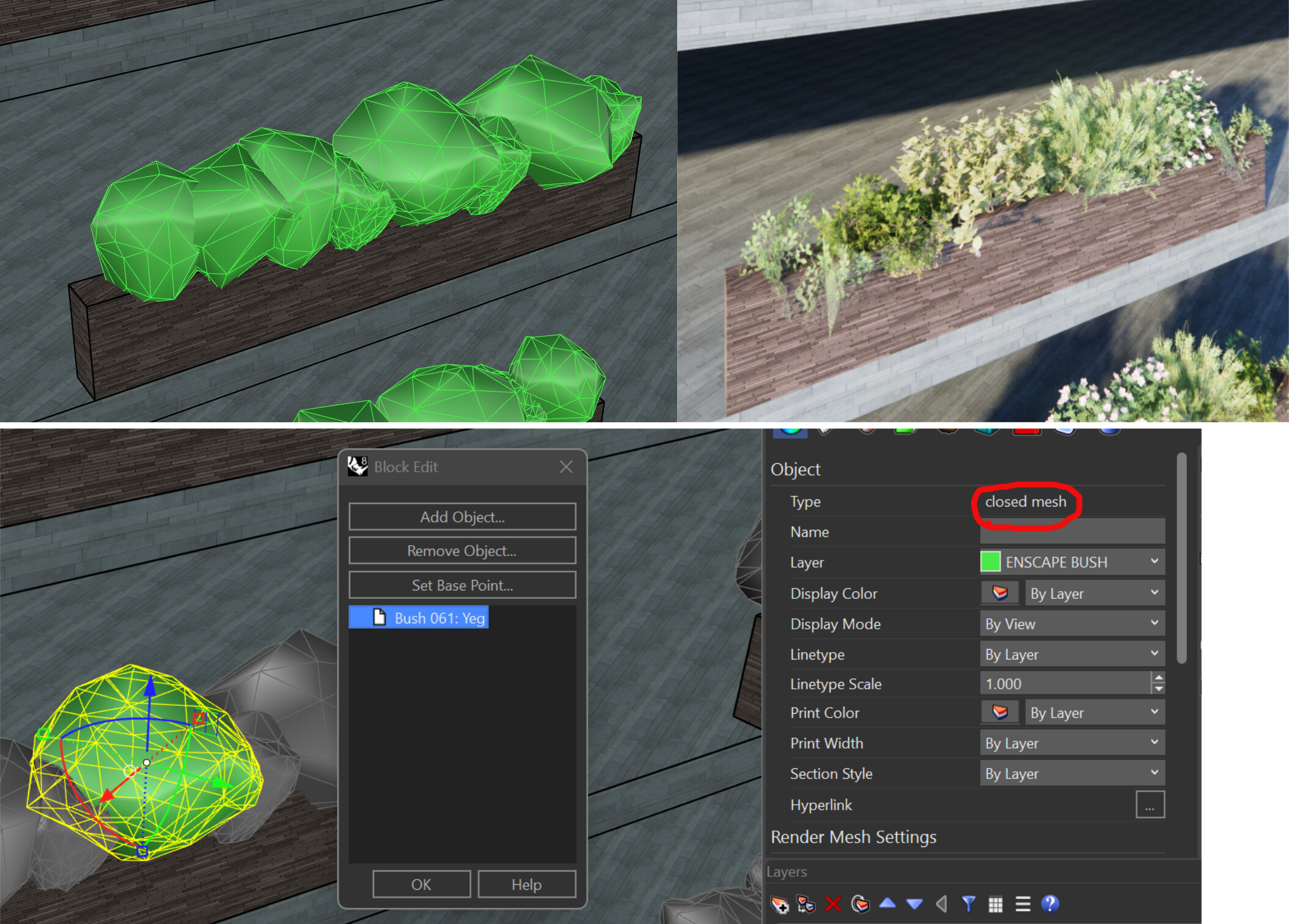

The way Enscape does it. Inside the block a lowpoly represetation of the actual geometry.

Like I said, the content of the block is a lowpoly representation of the actual content geometry from Twinmotion.
The user does not have access to the real geometry and textures from Rhino.
Like in Enscape.

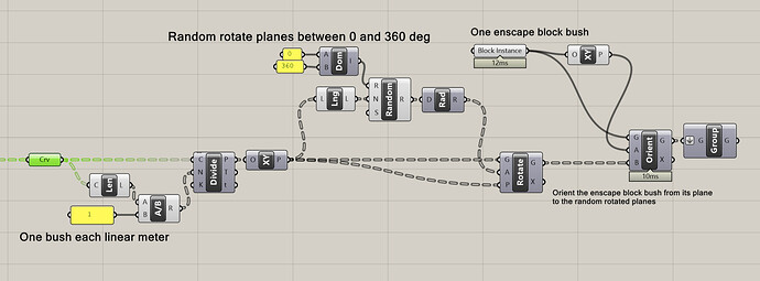

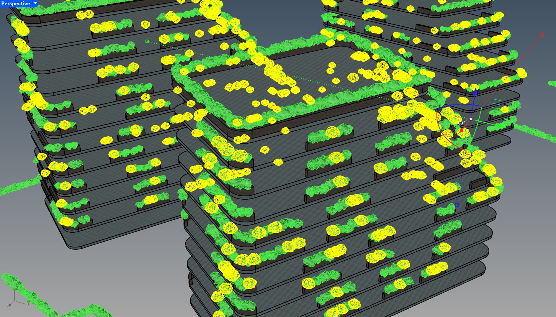

Here’s a typical case of 4600 Enscape plants placed to follow the planters of some buildings.
Using Grasshopper I can pick the top surface of each planter, then place the Enscape blocks on this surface, and randomly rotate them to get rid of repetition.
Afther this I can split those blocks into different groups, to have different plants.
If the buildings change in shape I can just rebake the blocks and I’m done.
Enscape does this using blocks with lowpoly meshes inside as placeholders, acting like proxy objects.

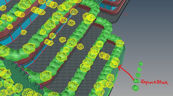

Here’s my workflow:
  1. I go trough the Enscape library and select my favorite plants. Save them in a Rhino file as a small library.
  1. Select, let’s say, 5 different bushes to plant the planters of my building.
  2. Starting from the curves in the middle of the planter i orient a single bush on randomly rotated planes once every meter.

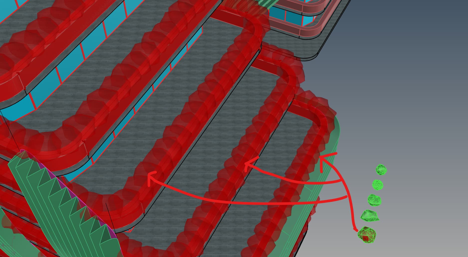

  1. I bake the bushes in one flat group. And then use this small code to split the group in 5 randomized groups:
#shuffles selected objects and divides them into n nr of groups
#-RunPythonScript (C:\RhinoPythonScripts\DivideIntoRandom.py)
# requirements: requests
from random import shuffle, randint
x = rs.GetObjects(message='Select objects: ', filter=0, group=True, preselect=True, select=True, objects=None )
shuffle(x)
n = rs.GetInteger(message='Number of Groups: ', number=None, minimum=None, maximum=None)
num = float(len(x))/n
l = [ x [i:i + int(num)] for i in range(0, (n-1)*int(num), int(num))]
l.append(x[(n-1)*int(num):])
for i in range(0,n):
    randomnumber=randint(0,99999999999)
    name = rs.AddGroup("NewGroup"+str(randomnumber))
    rs.AddObjectsToGroup(l[i],name)
  1. Then I simply select each group and run ReplaceBlock to change into those other 4 remaining types of bushes.
With this method or similar, I can plant hundreds of thousands of plants. And because the actual geometry and the textures are handled by the GPU in Enscape everything works very fast in both Rhino and Enscape window.

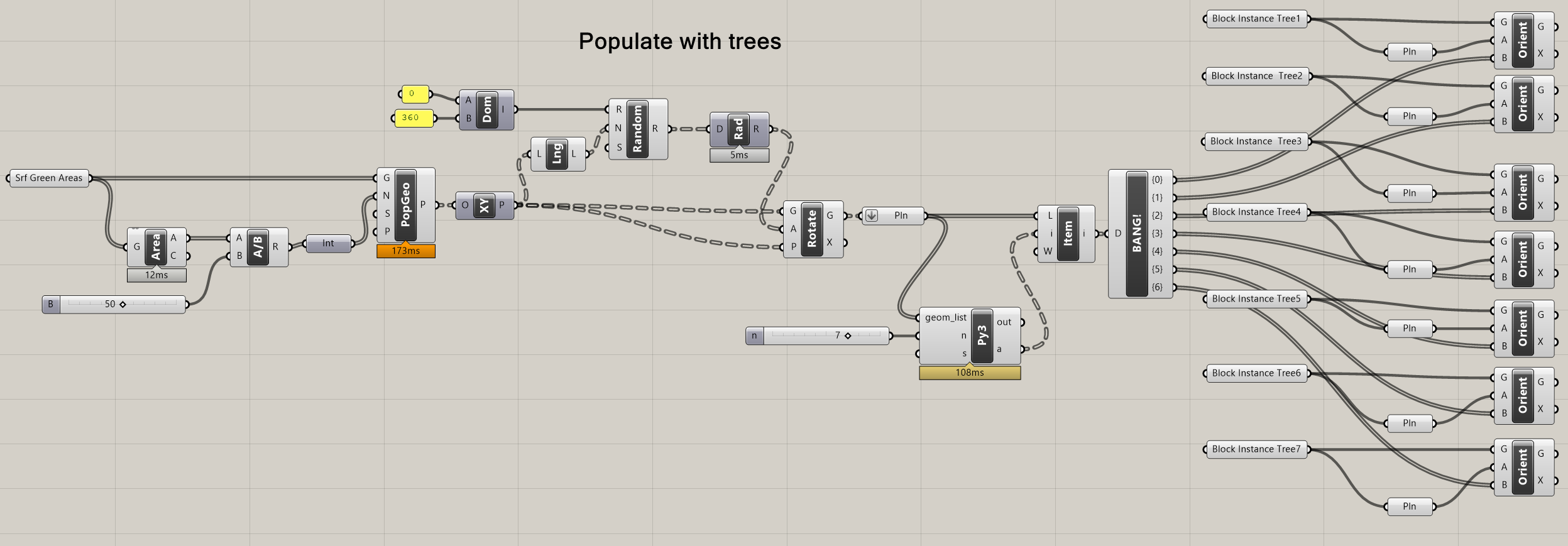

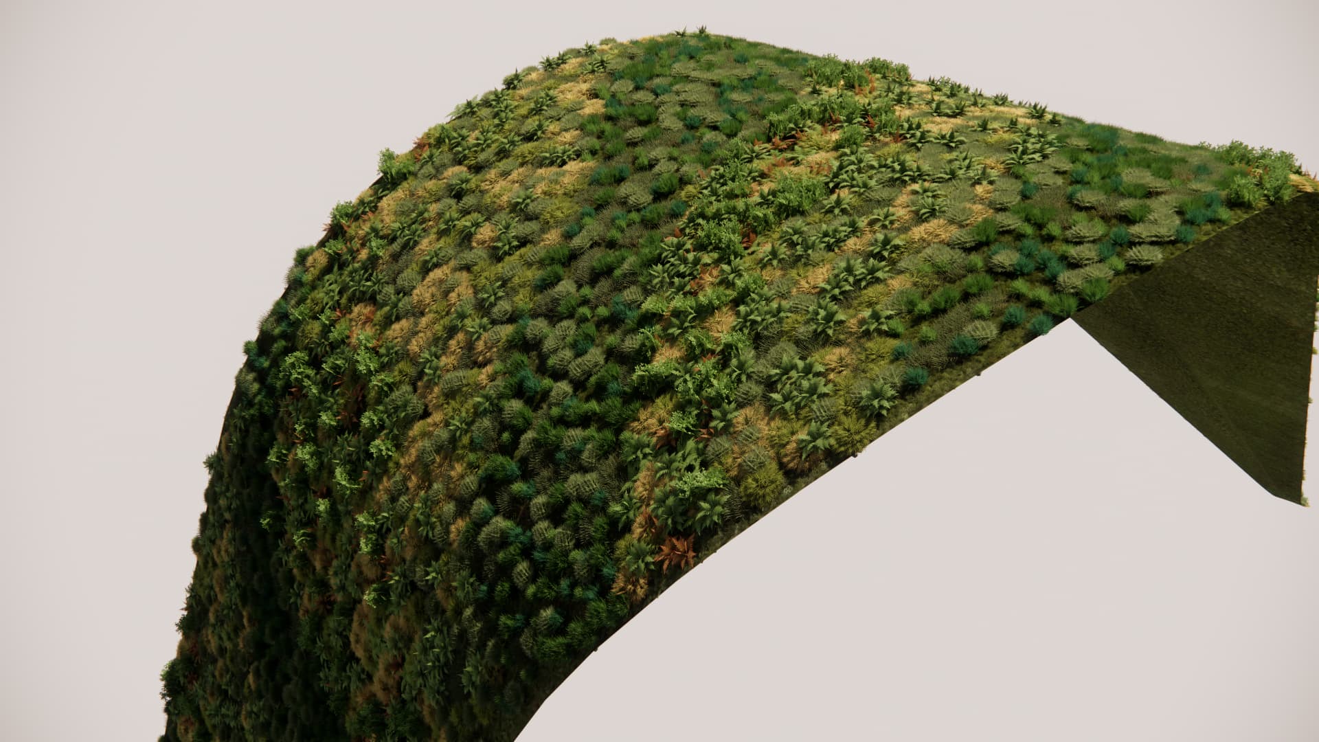

Another case: quickly populate with trees all green areas in a city. 7 different block trees from Enscape.
There is python script used inside grasshopper that shuffles an initial list and splits it into 7 sublists.
# shuffles a list and splits it into n sublists of indexes
# set geom_list as List Access and NO Type Hint
# use List Item componet to get the geometry sorted into lists
# use Bang to split the tree and get the brances separately

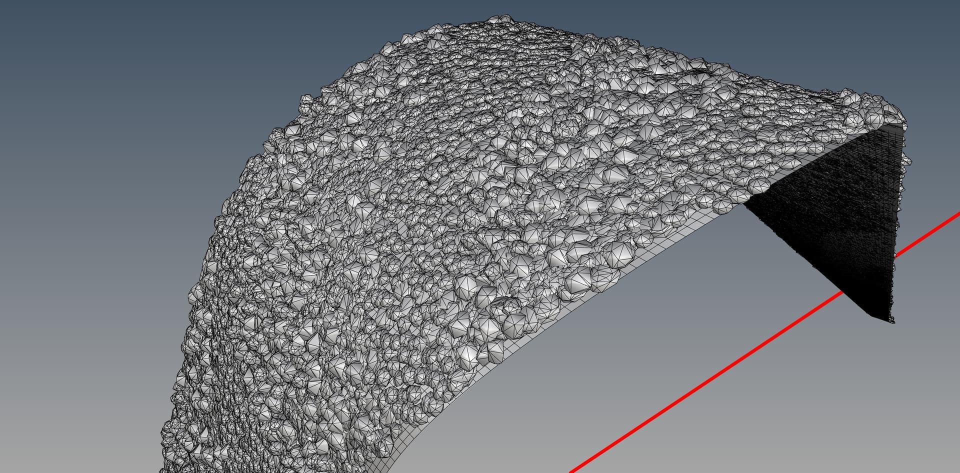

Grasshopper can also be used to populate all kinds of surfaces with blocks arranged in various patterns.
