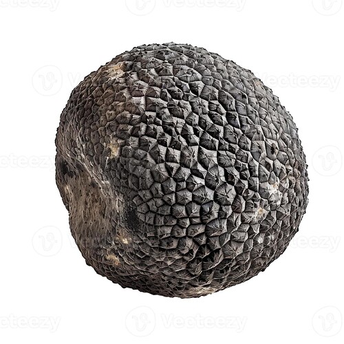

Truffle mushroom pattern on sphere
hello folks , im trying to create something like this , i just want the pattern , i dont realyl care about the overall shape(it cnabe just a sphere) any insight? thanks!
  1. Unwrap your mesh in Maya, 3ds Max, or Blender
  2. Paint the diffuse, roughness, and displacement textures in Adobe Substance 3D or Photohop
  3. Render with displacement, because of the strong three-dimensionality; a normal map won’t suffice
It’s just like unwrapping and texturing a pineapple or similar fruit with a very three-dimensional skin.

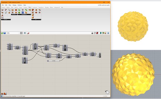

hi thanks for the reply , but i would really want to make this on grasshopper!
hmm, using grasshopper you probably wont make everything that is so irregular and uncontrolled , but if u just want some irregular cells, id say you can create the bounding box of the brep surface you are trying to make, then use the volume to generate a 3d voronoi shape and get the intersection between the surface and the 3d voronoi to get each cell, then you can make a mesh with the lines, then each “cell” you can use weaverbird or other mesh editor to create the barnacles like structure
Hi @amir_kharrat
A quick something to get you started (at least one way of doing it) - if you want to get the puffy looking barnacle-like shapes, probably you need to offset the curves normal to the surface/sphere and loft through them (and then onto the point).
truffle msuhroom quick.gh (19.1 KB)
HTH, Jakob
thank you so much jakob!
Hello Jakob, I tried making the final result more random, with more polygons in
truffle msuhroom.gh (11.2 KB)
some areas and fewer in others. However, the result looks very messy like this any ideas?
