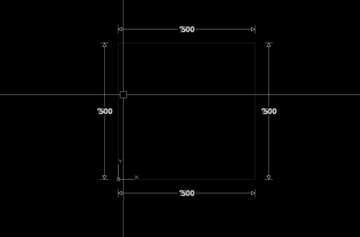

Hello hi,
I am trying to export dxf drawings from shape diver email export by using multiple dimension component
but nothing helps. I was using elefront in offline but for shape diver its doesn’t support. so it will be great if i get some help. thanks in advance
Please explain clearly which problem you are facing with exports, and include a minimal definition that I can use to reproduce it.

i have attached the definition
fab tools annotations are not export to DXF and please let us know the solution for exporting dxf supported annotations from SD interface.

we are working on ceiling systems and we want our client to download dxf from SD interface but dxf is not downloading with dimensiosn and text .

Apologies for the late response. There is an issue with the new export workflow when exporting text or dimensions entities. I have added some comments in your Grasshopper file with a workaround while we solve this issue.

Unfortunately, we have not been able to properly locate and prioritize this issue at the moment. We recommend to keep using the workaround proposed by Edwin above for the time being.
