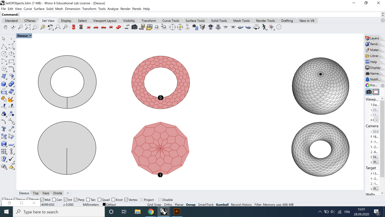

It is two lofted circles or revolved one:
For case 1 I am surprised that it returns a valid mesh.
Also works for donuts and spheres:
Same for hex grid:
It can be that updates for the clean seam is for the recent version, as I solved it for a student workshop half a year ago.

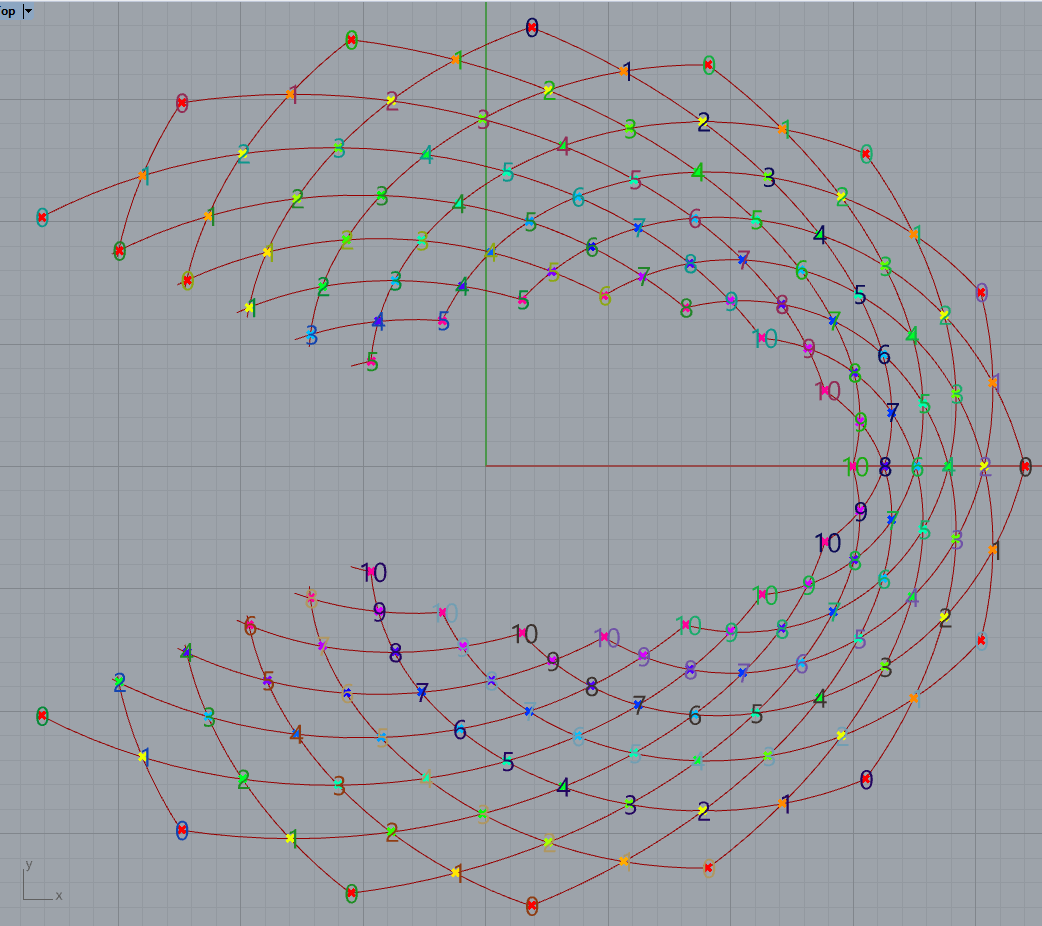

In response to a question in a necklace thread about using an ellipse as the basis, I substantially modified this model to avoid basing it on a surface:
Playfully, I added a feature to move the inner ellipse off center but didn’t realize until later that it still works when moved way off center, where I thought the tween curves would fail (but they don’t).
So now I’ve added the ability to move the inner ellipse in X, Y and Z directions and sorted the “intersection” points (actually CrvProx points). Kinda cool?
diamond panels_2020Oct3a.gh (30.3 KB)
I made a mistake sorting the points by Z because it obviously fails when the Z slider is set to zero (Doh!). Easily fixed using Sort Along Curve instead (yellow group).
diamond panels_2020Oct4a.gh (49.5 KB)
Then I added an optional “CLIP” toggle (light green group) that cuts away a portion of the curves and points based on the ‘clip’ slider (blue group). Sometimes it fails when the Z slider is zero…
Clipping adds some extra processing that isn’t needed when CLIP is disabled so if I were using this regularly, I would add code to disable the unused bits when CLIP is False.
