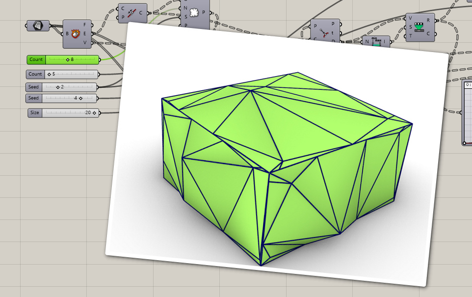

Hi friends.i tried to make triangulate surface through closest points and join them in triangle. I wish to make something like this
From yesterday I tried to make it in different ways but I couldn’t separate closest partitian list of 3 points.
Triangulate tower 1.gh (12.3 KB)
I also hope theres way of doing it without meshes!

To make 8 triangles it is faster in Rhinoceros.
Some test, no very beautiful !!
Triangulate tower 1.gh (18.0 KB)
As you seem desesperate :grinning:
Here a more beautiful version :tada:
You will need Rhino 6, MeshmachineStatic
Triangulate tower 2.gh (22.1 KB)
Omg, I just noticed u reply.I knew that its possible.And u make it possible,Thank u so much!!

Yes there is StaticMeshMachine as it is written in the discussion with the link that is given.

You must be on Rhino 5 and GH0.9, so it must work just in Rhino 6. You just have to add more multiplication components.

How does the multiplication component function in your script does it do ABC*D?
Can I have one component that does AB and have the result to be multiplied by C and then have the result of that going to another multiplication that multiplies it by D so it will be:
A
B=R1, R1C= R2, R2D=R3. then input R3 to T in the Move component?
Yes you can put multiple multiplication components. Triangulate tower 2.gh (13.7 KB)
hope this work :grinning:
