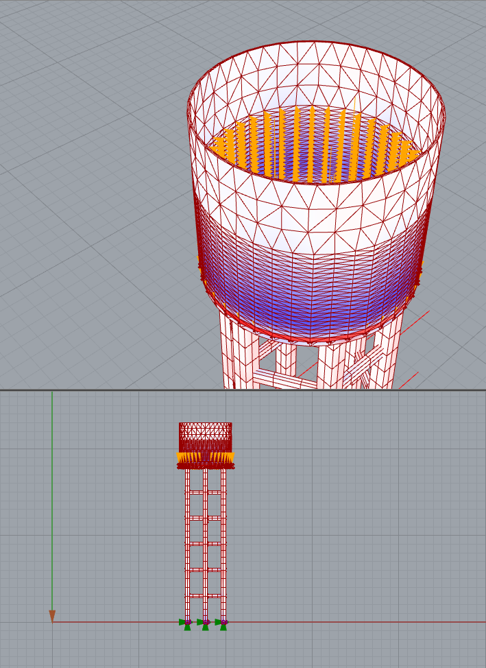

I’ve been trying to model a circular reservoir in Grasshopper and analyse it using karamba3D.
I declared the reservoir walls as shells, but after that I encountered issues while trying to apply horizontal loads on the shell. The water self-weight creates a triangular distributed load on the walls. Like in this picture:
But I couldn’t find a way to apply that form of load on a shell using karamba3D.
To “run away” from this problem, I divided the original mesh into smaller meshes and applied fixed distributed loads in each layer using the MeshLoad Const on the Loads component, the bigger load on the mesh near the bottom and the smaller load on the mesh near the maximum water level.
I imagine the way I did is precise enough, but I wish there were a better way to do it, I’m open to suggestions!

The direction of the loads wasn’t the problem, they’re already facing the correct faces:
The problem is the modeling of a triangular load on a shell, I tried to "emulate’ its effect by placing multiple rectangular loads in sequence.
But what I really wanted to do was using a component like Beam Loads (with trapezoidal load):
But it should be usable on shells, so I could get an effect like that:
Is it possible? Or do I really have to subdivide the wall into smaller horizontal rectangles and apply constant rectangular loads with decreasing values into each mesh/shell?
Dividing like that creates a loss in precision, I wanted it to be precise as possible
