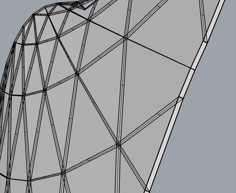

Looking to CNC a parametric wall out of birch using triangles as a blanketed form.
I’m finding difficulty though in lofting the triangles together to create uniquely mitered edges that respond to their neighbors at a width of 3/4". The connections are intended to be a butt joint aka wood on wood connection. Attached are my files.

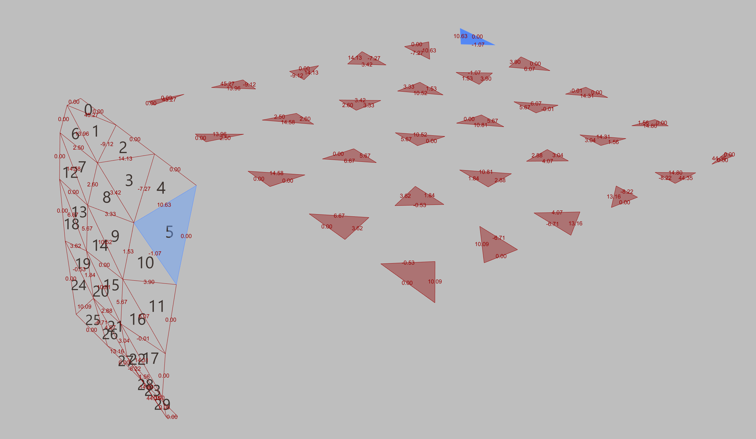

Instead of creating panels with gaps you’d have to create panels without gaps, join everything and use the Brep Topology component to extract the angle between two adjacent panels. Then orient all panels from 3D space to the XY plane.
Below is a simplified version with less triangles and the input curves of your surface internalised. The Rhino file is not needed for this definition.
The angles shown are the angles between the face normals. Negative values are concave, positive angles are convex. You’ll have to divide those by two.
My triangulation is different compared to what you achieved with Lunchbox and I don’t know in what order your triangles will be sorted.

Anyway, one way to create the panels is by extruding the edges a bit too far and use a C# script with Rhino.Geometry.Brep.CreateSolid
This works for the stripped example. I did not eliminate the intersections at some of the corners. This could be automated but might be an overkill, depending on your machine and CAM.

I took a stab at the problem. One way to ensure zero-gap is to join faces into a mesh and offset said mesh. This however won’t guarantee constant panel thickness. To do so, one further step is required:
. offset to a greater distance than the desired thickness
. make an extruded Brep of each face and its corresponding offset, using a loft to create the connecting perimeter
. trim the Breps with the face planes at the desired offset distance
In this visualization red indicates the non-planar surfaces
Unless you have a torsion-free geometry to begin with, perimeter faces might be non-planar, and to maintain constant panel thickness you will have some uneven situations on one side, like these:

Be aware that in yours and @Rajeev2 method the panels do not retain constant thickness (which I believe was required by Tristan). Just offsetting the surface and repanelizing it does not guarantee that the panels’ front and back faces are parallel.
See this image where I replicated it (the numbers are the angle of the unrolled panels’ top face normal with Z - it should be 0 - also see the non-horizontal condition in the right viewport):
This condition is still acceptable if the thickness is negligible compared to the panels’ dimensions; however, I believe it matters in this case.
The solutions with lofting create no-planar miter surfaces, which of course can be milled but I don’t think this is very efficient compared to cuts with a 5-axis saw.

The miter surfaces in my definition are planar. But if the backside is never visible why don’t you cut all parts with let’s say -20° or -30° and use some good adhesive to glue all parts together using a waffle sub structure?

This is a very laborious flawed effort using Anemone to trim scaled offset triangles. It has four flaws where it appears to me that adjacent triangles are so close to co-planar that their intersections fail.
The clutter at the bottom left of the first image is diagnostic output that could be hidden. My method for examining each offset triangle is to disable both loop components (start and end, orange group) and move the wires connected to FastLoopStart ‘C’ (Counter) to the integer slider in the yellow group. This allows me to access each triangle separately to see its intersections.
Triangular Blanket Extrusion_2023Aug24a.gh (51.3 KB)
It takes the loop ~21 seconds to complete so there is a delay when opening the file or changing parameters. Not shown (because I just wrote it) is a simple ‘“unroll” / layout’ group.
The miter bevels are so slight that it’s probably not worth doing, as @martinsiegrist said. Glue or thickened epoxy would easily fill any gaps.

I used this code from @DanielPiker, posted here:
To produce very different code that is fast and looks accurate.
Triangular Blanket Extrusion_2023Aug28a.gh (49.3 KB)
As an afterthought, I added back components I didn’t use (yellow group at the bottom) that shows “dihedral angles” between faces, which range from -32.934998 To 17.201252 degrees with an average of -1.705997 degrees. The sorted list shows quite a few that are ±5 degrees or more.
I also modified the ‘“unroll” / layout’ group to use a grid:
P.S. Come to think of it, those “dihedral angles” in the yellow group are angles between face normal vectors so miter angles would be half of those values? The range is -16.5 To 8.6 degrees with an average of -0.853 degrees?
