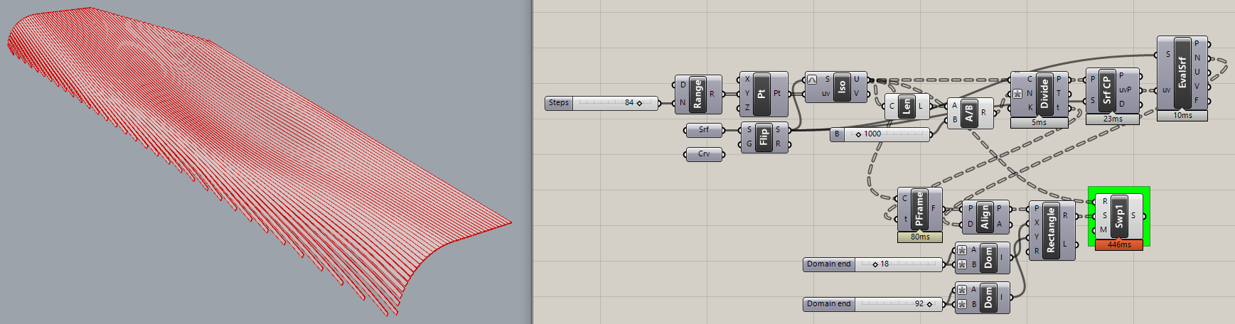

@TheCyclist, @Max3 @Joseph_Oster I give up with T&G, I thought it would be easier but it’s not. So quickly I’ve tried to do Matthias Pliessnig’s approach to one of my surfaces but I need a help on a few things.
  1. I wasn’t able to control the direction of curves. I used Unit Y but it’s not parallel to starting point/line. Blues what I got but the magenta direction is what I’m looking for. I don’t know how to get that direction in Grasshopper.
2)rotation of the frames. they don’t follow the construction curve I use. (those circled areas also weird)

Well, your surface is poorly formed in several respects. It is a trimmed surface which makes it a problem to split with isocurves. And it has a kink (hard spot) in one of the long edges. These two factors create a LOT of extra work.
Your cross-section curves differ in length by quite a bit so spacing fixed-width strips evenly doesn’t work well without large gaps. It’s really quite a mess and I’m not sure it’s worth the trouble to pursue further.
P.S. And your unit values are extremely large!? Your surface is ~27,000 units long. :frowning:

I can’t look at this again today. It’s a pity to do all this work and get a shoddy result, as I knew I would. I hope you’ll read all my comments on this thread and rethink your surfaces. Matthias Pliessnig’s look great because he created his base surface CAREFULLY.
When the surface is badly formed, the result will be ugly.
One of the troubles with a surface 27 thousand units long is that it’s very difficult to see perp and surface frame icons and know how they are oriented.
Good luck. This (below) is the wrong way to go about this. Deeply wrong!
Concept_Study_2020May20a.gh (158.4 KB)
This is what I came up with…it’s really messy. Cleaning up the surface will help greatly.
