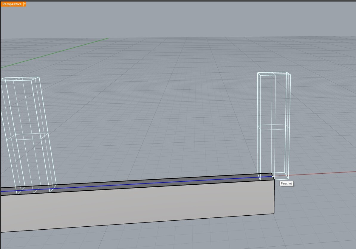

Hmm. That script is very close. But going from the array object’s center still puts the final copy half the object dimension off line of the span, and though equal, the spacing is still incorrect. Just like using the regular array, If I can’t move my cursor point to the outside of the object, I have to guess if I’m close enough.
That’s exactly what I’m looking for! I did not have the options you showed, because I missed the updated version later in the thread. Now I have it.
However, I’m still not getting it to work. When I drag towards the end after setting the base point, I do not get the end snap visible in your video. (I have snaps and ortho on.) How are you getting it?!
just slide a bit (hold down shift) to get the direction you want, hit ‘Tab’ to lock the directional
constraint & now you should be free to click on any point/corner to snap to
Thanks so much! “Tab” was it! This script has easy-ified my life a lot.
