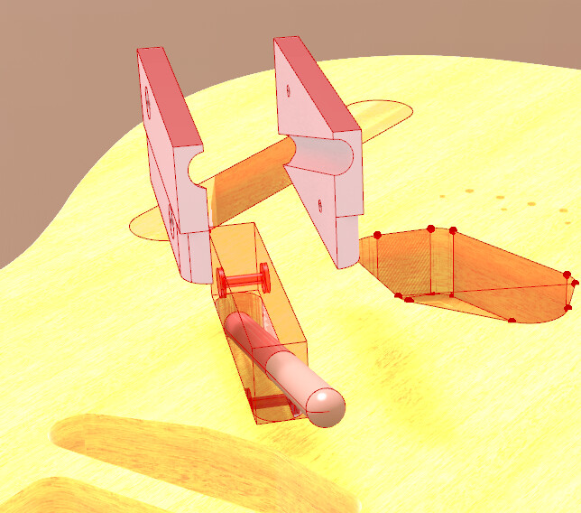

Today I designed a jig to drill the cable channels at specific angles… First tests I did showed this was prone to error and it was easy to damage the edges of the cavities…
Only the diagonal channel jig is made here but the concept is solid. The jig goes in the cavity, you drill straight into the hole from the jig.
I will cnc the jig as a 2 sided part that clamps the drill and fits into the different cavities. This was I dont have to drill the hole in the first place :wink:
Finally a nicer view of the part split in two…
Not sure if you noticed but the drill was not alligned to the diagonal cavity box/jig. Now it’s fully aligned, holding screws inserted also.
Hopefully the holding screws are easy to source… But not impossible to make.
It was impossible to make this a one sided cnc job because precisely of these screws. Also I want to add a guide positive and negative rail feature to the two inner surfaces of each shapes to align them better and for added rigidity not needed but fun to try (for a future project).
Clearance of the walls that go in the cavity will be a 0.1 mm job - still thinking of an efficient way to do that.
Finding the right plane to orient the bounding box of the diagonal ovoid cavity was a bit of a challenge but made everything easier thereafter! Thanks Diff-Arch again what a lesson!
Without it you get this
With the plane you get this:
After that I tried forever to get the normal (the perpendicular right?) to that box’s orientation but gave up and used the shorter line of the bounding box to create a vector for perpendicular screws and separating/exploding the parts (for the easier to see display of both parts in the first picture).
So, this jig part is really important - unplanned side project but not that hard to design now i got the idea. It will make channels drilling 10x easier and faster to drill, prevent drill breakage, prevent guitar body damage on the side of the cavities, consistent or custom angles.
