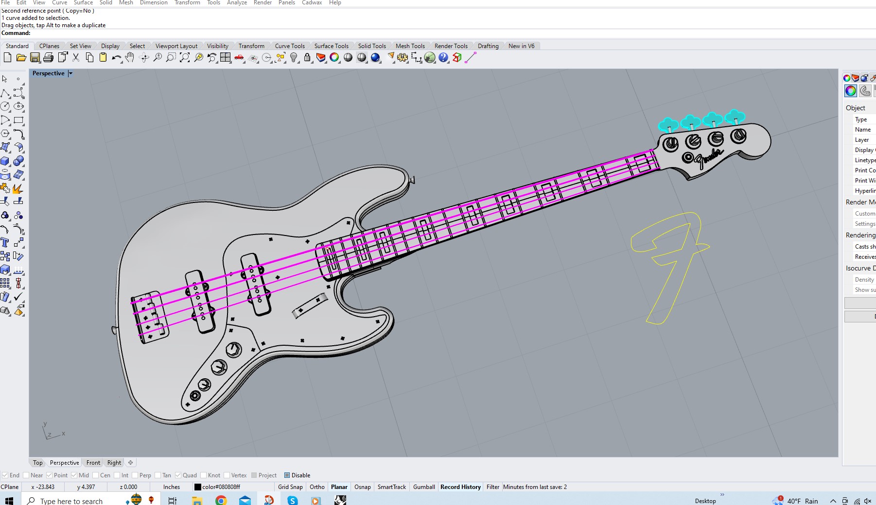

Nice Job and yes sir the neck volute can be tricky! Here’s one I did as a reverse engineer practice of my ‘69’ Jazz bass using Rhino5 I cnc milled it in individual l parts and assembled. MOP inlays, 14kt gold frets did it as a two piece neck back side white wood fretboard rosewood
damn! How does it play?
That’s a great idea for reducing costs in prototyping too… :slight_smile: Do it kid scale!
