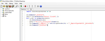

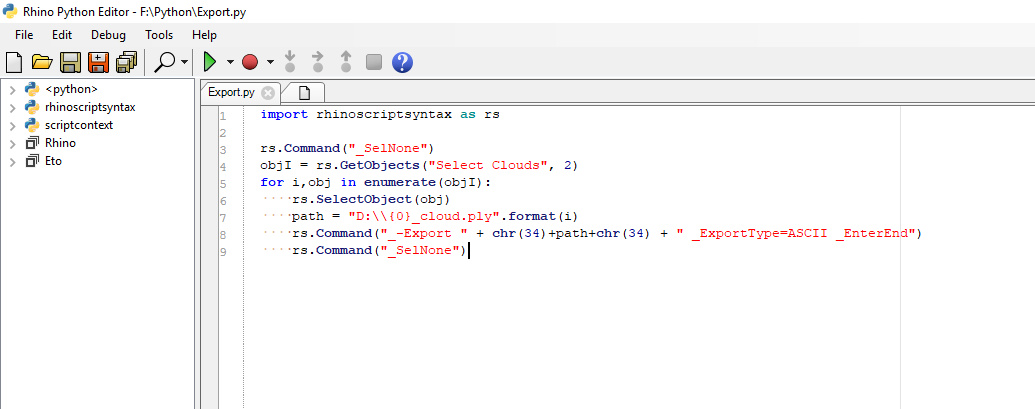

The file writing plug-in failed
Hi, check it out
Point Clouds.3dm (50.2 KB)
Export.py (310 Bytes)
A problem only for me?

There’s a fix in the works for this. In the meantime, if you set the export to binary then it won’t bail out early on you.
