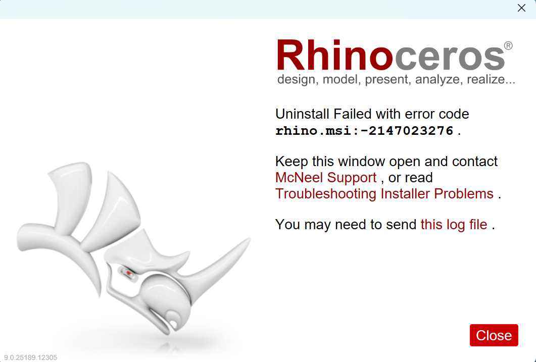

Okay, I’ve repaired all .Net related installs. Then I went about updating the Wip and got prompted with the message that the Wip could not be removed. I tried to uninstall it and got the following:
This is the log file: Rhino_WIP_20250723102059.log (28.2 KB)
And the link to the troubleshooter is dead:
Can anyone help me with this? :index_pointing_up:
If I can’t update the WIP, it’ll expire next month.
I tried the uninstall function for this troubleshooter, which I forgot was there (thanks support) and now I could uninstall the WIP. The issues disappeared on the newer WIP install.
