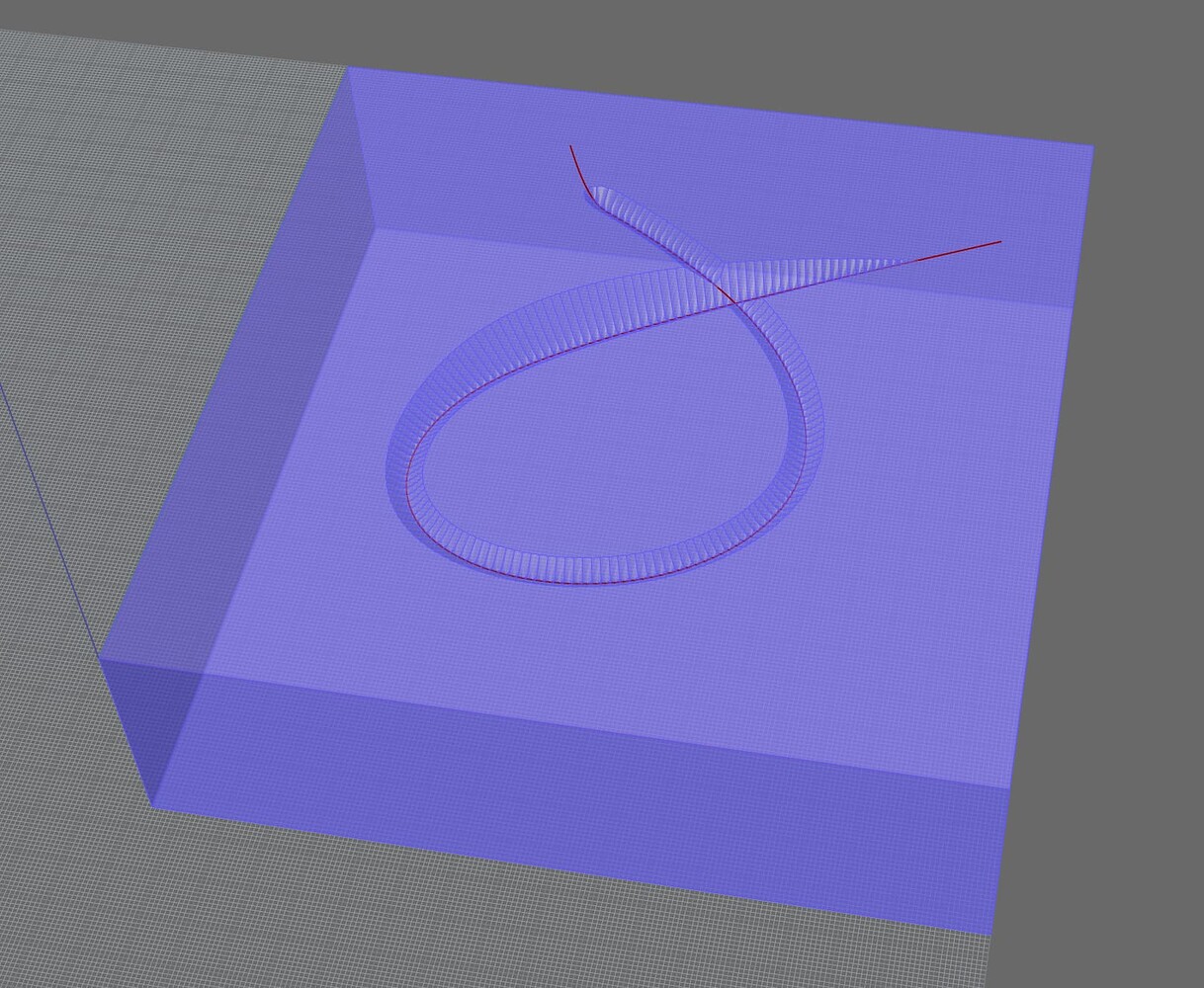

xi = 0
while xi <= count:
    subtract = rs.AddCone(planes[xi], R/2, R/2)
    diff = rs.BooleanDifference(brep, subtract, False)
    if rs.IsBrep(diff):
        brep = diff
    else:
        brep = brep
    xi = xi+1
Anemone FastLoop isn’t as fun to watch as Anemone Classic but appears to be slightly faster than your Python loop.
Anemone_FL_2025Jul1a.gh (16.2 KB)
P.S. Anemone FL is faster as ‘Count’ goes up :red_exclamation_mark: ‘Count’ = 400 takes 45.2 seconds in Python and 38.2 seconds in Anemone FL :bangbang:
