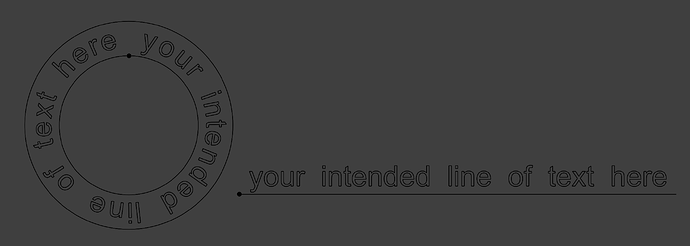

You also can give it a try with Grasshopper, and for you reference.
TextOnPath
TextOnPath.gh (12.6 KB)

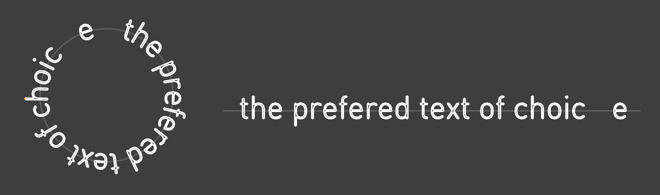

no it does not if you use the option rigid and if you not already have deactivate option stretch.
then see that the base curve has the same length as the circumference of the circle, use the command Length to read it out.
if you turn on history before, you can even move around the text and adjust it in the base curve and see the update on the round shape in real time.
maybe if the seam of the circle is where you want it to avoid confusions.

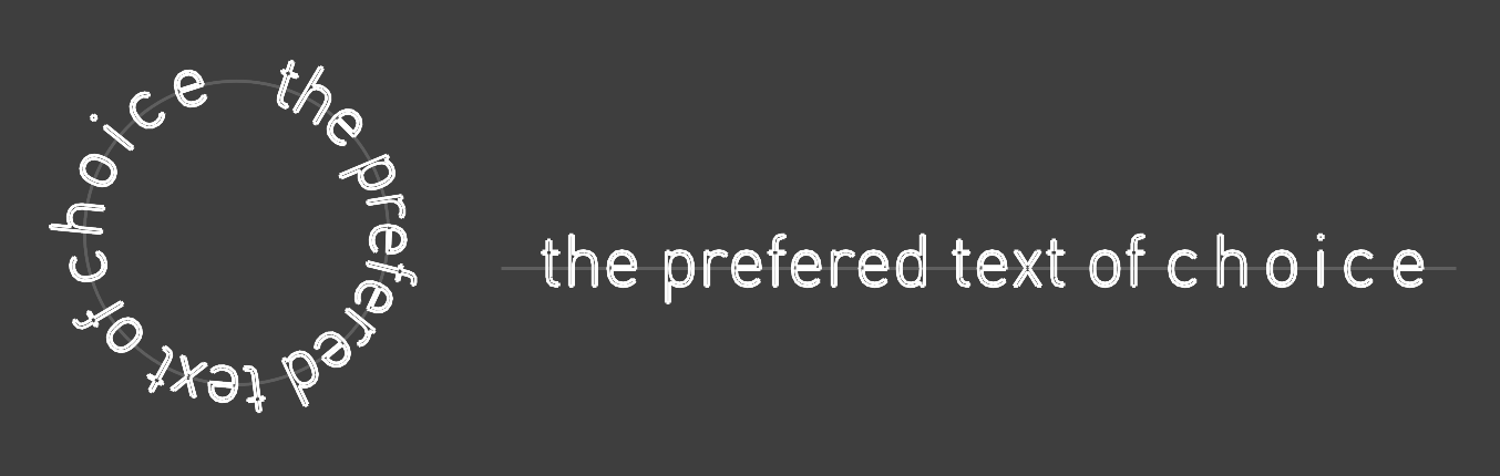

did you try the command distribute for this exact matter? for a few letters that have to be placed exact to optically match your needs even with kerning in illustrator you still might need manual adjustment between the letters. so does illustrator really help that much here, idk
kerning was actually supposed to be implemented in v9, i see a checkbox there but it does not do much if at all anything. kerning is definitely a hot wish which i would love to see soon.
edit: fun fact distribute also works along the other axis, illustrator cant keep up with that goodness come on :smiley:
