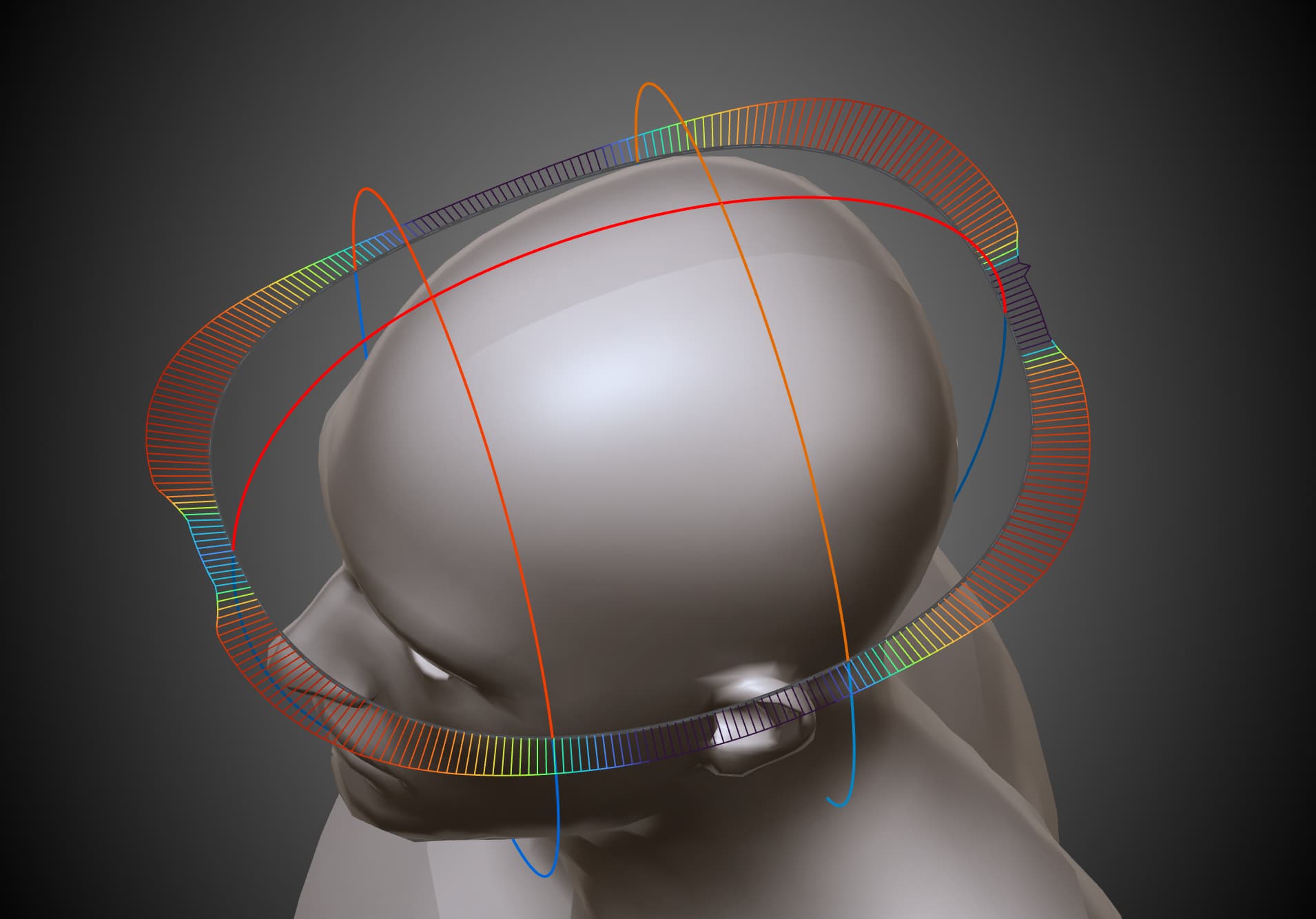

I’ve rewritten Rhino’s curvature analysis tool for my specific needs using Grasshopper and Python. I’ve taken advantage of Anthropic’s Claude for AI-assisted coding to expand what’s possible with this enhanced visualization method. The AI written GH Python coding was a rewarding experience. This took about 20-30 iterations of adding on features and testing.
The integer-only scaling limitation and fine line width of the Rhino native tool was my initial motivation in rebuilding this function. The standard tool forces values like 125 or 126 with no ability to input 125.5 - and the visual jump between consecutive integers is dramatic. This SuperComb implementation allows for much finer, smoother control over line length and display.
The color-mapping functionality adds another dimension entirely. The comb lines can now be related to customizable color palettes through two methods:
  1. Dynamic mapping: Adjusts the full color palette to the min/max values present in a curve.
  2. Fixed or referenced mapping: Assigns colors to specific radius thresholds defined by inputs.

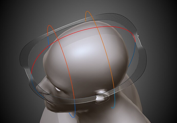

One interesting discovery was the ability to flip the magnitude display. My first introduction, back in the 90s, I found it counterintuitive that tighter curvature (smaller radius) generates longer display lines. I adapted to this CAD convention quickly, but I’ve never viewed any one system as the gold standard - it’s about adapting tools to what works for my exploration process.
For work like helmet design, I’ve added toggleable radius labels showing millimeter measurements. The density of these labels can be adjusted from sparse reference points to comprehensive coverage. ( This inspired the physical 3D printed gauges in this post Radius Gauges, 3D Printed )
You can maintain the classic fine “comb” appearance or thicken the lines for a gradient effect that reveals broader curvature transitions across complex forms. The Human LineWeight node is used to accomplish this, if there is a new native Rhino function that will display line with weights I would be happy to incorporate it.

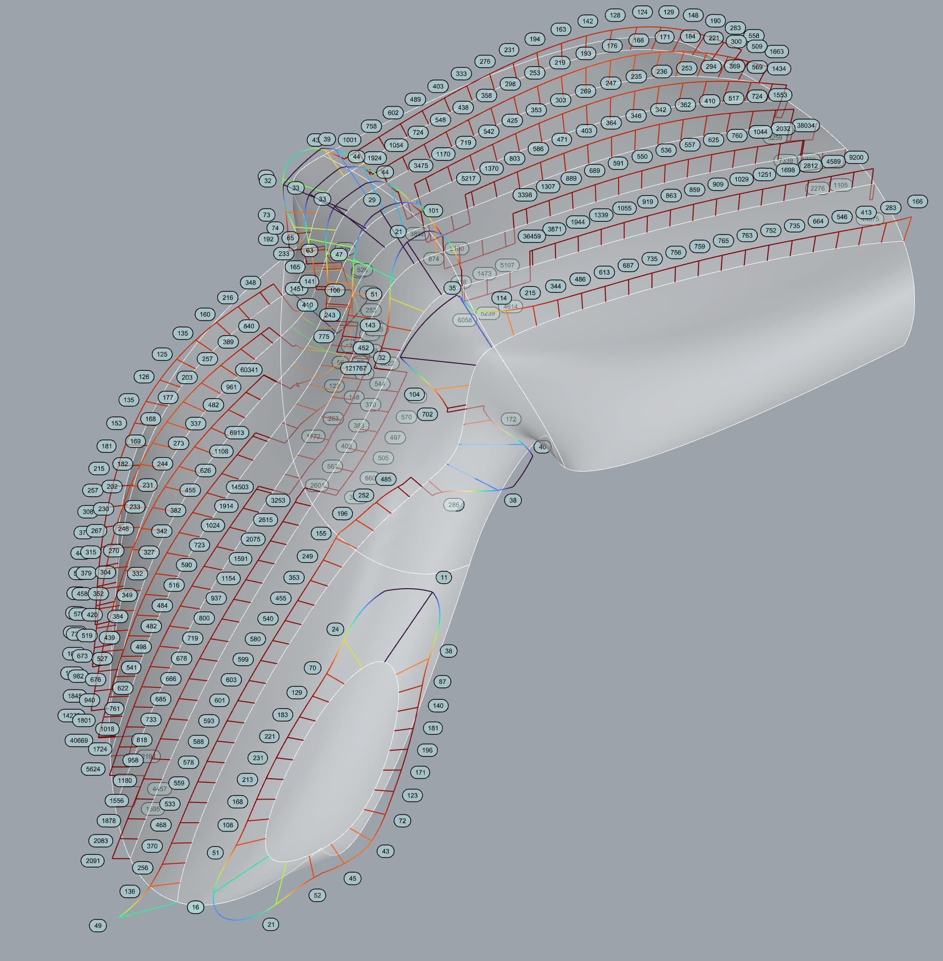

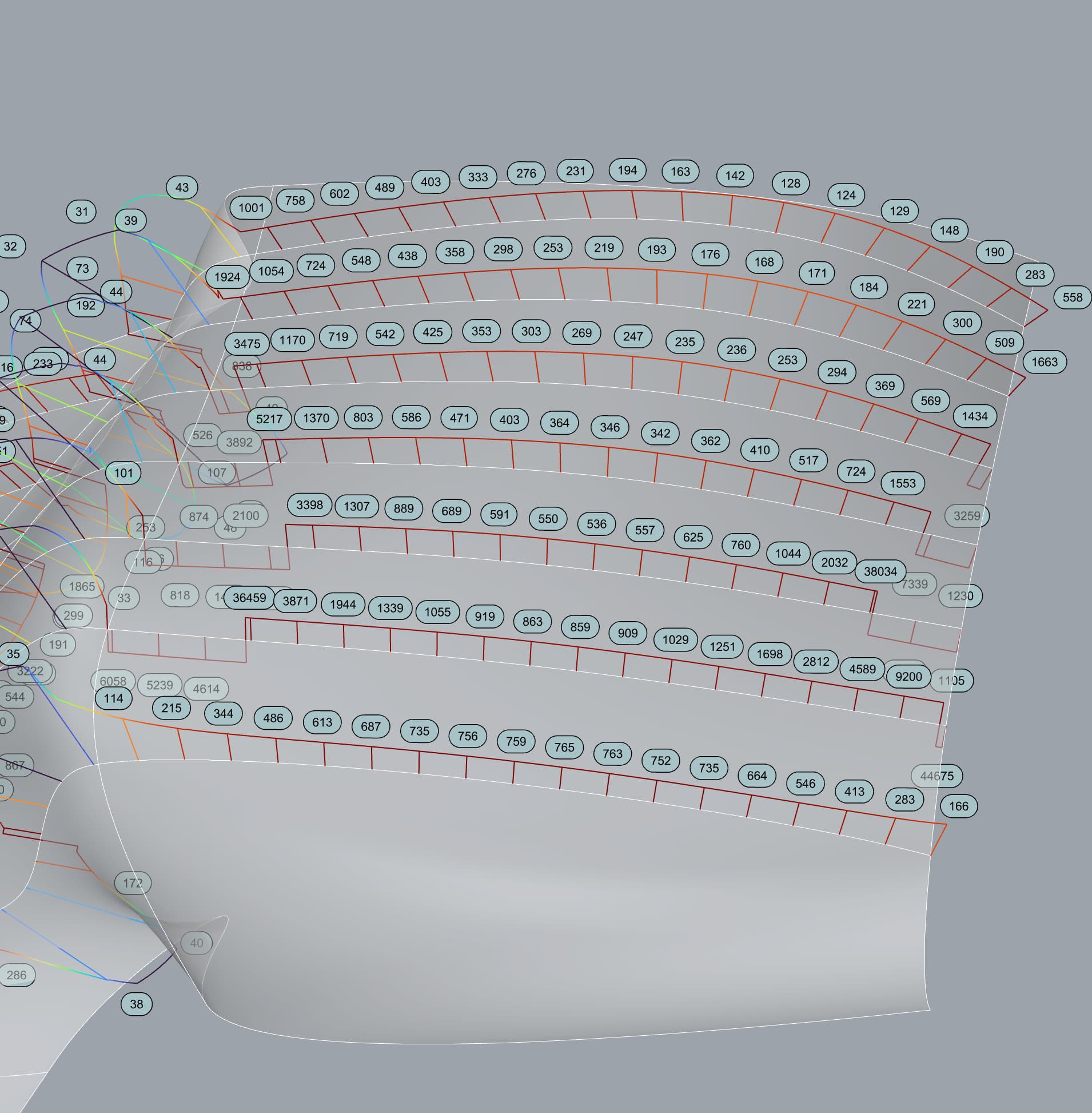

Annotated radial dimension dots, constant spacing, sparse.
Annotated radial dimension dots, constant spacing, dense.
Annotations matching comb line placement, coase resolution in tight radius curvature.
Annotations matching comb line placement, Sparse in larger radius curvature, more dense in smaller radius curvature.
