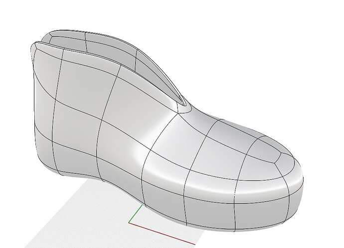

First time try to model a shoe with subd and i got stuck with this problem: cant achive a better topology, nice faces and isocurve that goes in a ring not intersecting each other
can some one pls geve me an help? is it just a manual work of small add and remove edges/faces?
Can u pls sugest me a workflow that can prevent this type of problem in the future?
thanks to everyone

do all your topo repair in box mode, it will maker it a lot easier
depending on what you are trying to accomplish- this may work
LeTry7-kfix.3dm (477.9 KB)
it also may make sense to retopo this manually and build topo that flows a bit better.
make paperdoll flat pieces with topo flow you want-, then project them to this model.
see this video-
I had a go at a manual re topo-
you can refine from here obviously, but it’s a very simple, very clean topo that you can build from.
the problem with quadremesh is it makes some crazy edge structures that can be hard to work with.
when I use that tool, I reduce the quad count to the very very minimum and then refine the part from there-
feel free to use this, copy it or ignore it completely. :wink:
