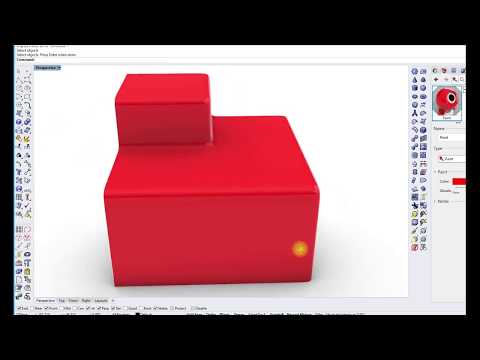

I started with several identical strips, then rotated and positioned them to make the rough shape- then bridged to connect them in places and then started shaping the vents-
here is my model with the wires turned on so you can see the patch layout- and the model if you want to dissect it or make improvements-

Bridge is great, moveUVN also, insertedge for ridges works great. Things I’m currently missing: OffsetSubD - I’m missing the ability to add more than one edge in order to avoid a lot of InsertEdge work afterwards (to get harder transitions).
Softtransform: Needs to be a “mode” with some sort of visual - and easily scaleable - marker on the size of the affected area. Maybe the gumball “sphere” could be scaled to show the affected area? Maybe turning SoftTransform on/off could even be part of the right click menu on the gumball instead of a stand-alone command?
Split subD along edge: Maybe this is already possible (in an easy way, not extracting faces or by extracting the control polygon), but I want to be able to split a sphere into two semispheres by doubleclicking the equator edge and calling SplitSubdAlongEdge (or something).

This took some time, mostly fixing surface errors from trying to push things into places they don’t want to go.
Biggest frustration was fixing vertex points that didn’t match up, skewed quads that required fixing, a few inconsistent normals, figuring out whether to use a crease or not, offsetting the sub-d surface to a solid and finding holes where the original surface wasn’t correct.
Cool stuff…being able to take sub-d and convert to mesh and fix the mesh and then convert back to sub-d – this was essential for my workflow to be able to get a clean surface in sub-d.
It would be great to see the “bridge” command have an option for adding segments in different directions, no matter the edges picked.

I agree with the ability add edges in the offset…I’ll write that up!
I agree soft transform needs some help and IMO needs falloffs and UI to show influence.
Split, it’s written up already as “unstitch”
Thanks for the notes!!
-K
nice work!! Bridge has to go in 1 direction right now in order to have the edges line up… but I’ll discuss with the devs-
