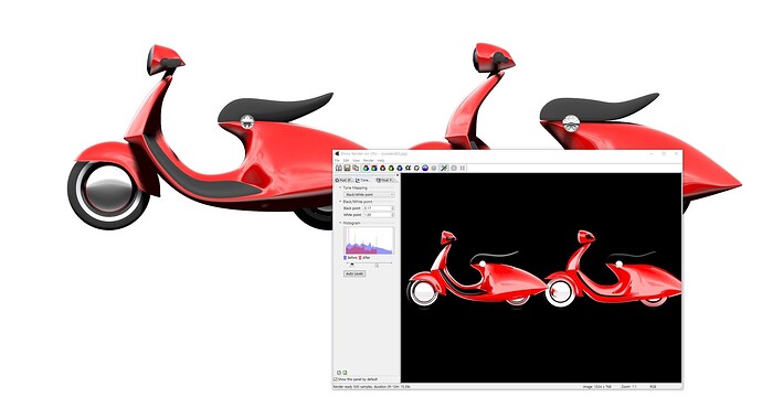

    I am wondering if the decal is not displayed in the rendering image.
    Watch how decals work on Rhino’s official YouTube channel and head-light go on
    How did you work on the decal?

not quite sure what you mean here… can you clarify?
just a material applied with planar mapping specified. not a decal.

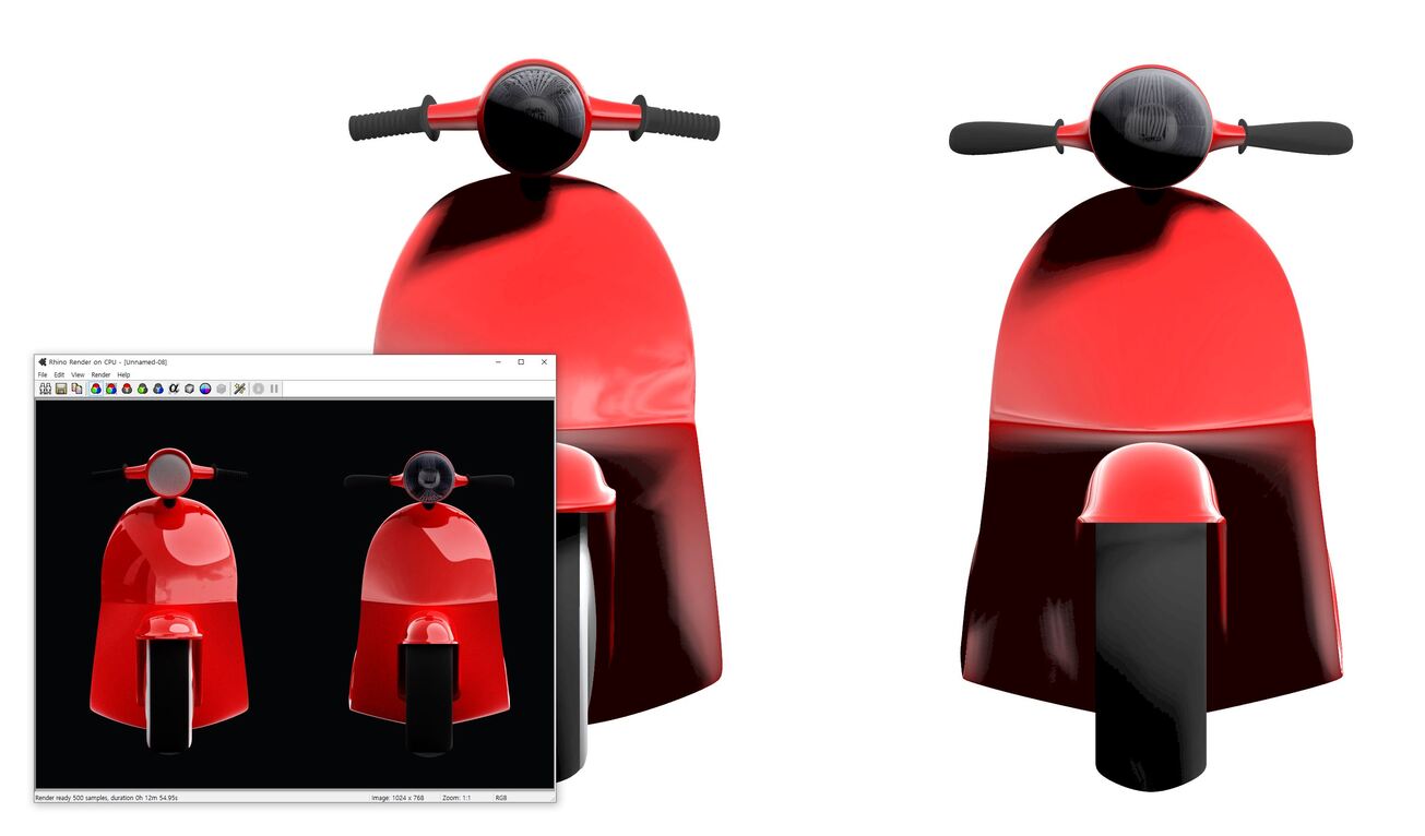

False color is good working. Rendering to 3d modeling and 2d pictures~ feedback :slightly_smiling_face:

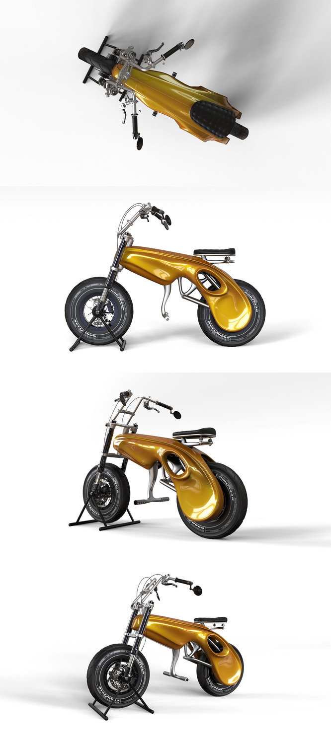

Hi All
So I spend more time on this than planned, because it was so much fun. Suspension, brakes, tires, rim and hub motor are hack’n’slash from various motorcycle models on the web; body, frame, seat etc. are of course Rhino sub-d’s. Not the look I’d personally go for, but I thought it would be fun to go all-in on the dynamic curves for this one :slight_smile:
-Jakob
