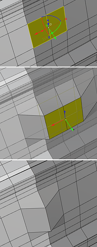

If you are dragging on the grayer side of Reflect mode, you get unwanted results or your subD object just disappears all together.
can you post this file please?
So far it happens to any file when you pick more than one face adjacent to the symmetry after applying reflect.
Also as a user, I expect to move either side of the reflect with same results. Right now if you drag the reflect side, it does not translate to the original subD object.
the dark grey side is the “no touch side” try doing the same thing on the light grey side-
