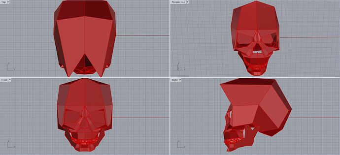

Sub D challenge 3!
Thanks
Tests Video :…https://youtu.be/2e69s3xTb1E

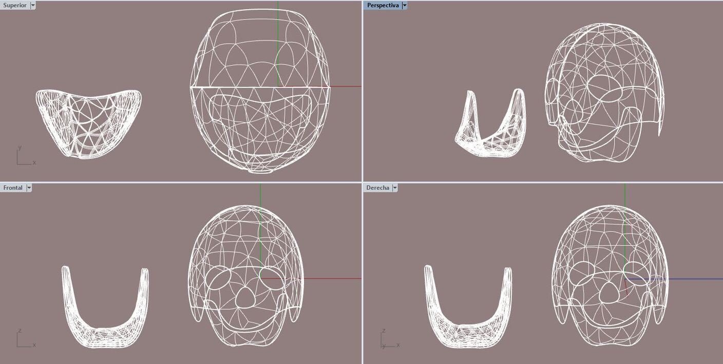

can you post your wire frame?
Hello
Thanks for your reply,
Here is the wireframe.
** Honestly, I still think I’m learning to model with that new Tool, and then sometimes I think I still have a chaotic Process, ---- going from Mesh to SubD and from there to Poly again and back to SubD sometimes, which I finally have so many options, I don’t even know which part is which, and I select the best one, and I try to follow what I like the most.
(Sure, I have SubD layers, another Poly, and another mesh).
Because it looks like this in the video, I’m not sure apply several steps, back and forth … haha.
I would really love to come back to this, when I have more free time,
because it is interesting when one approaches the real model.
(I don’t like anything even that wireframe / nothing real yet,
but it was very fast)

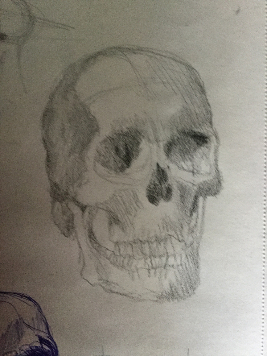

—Imagine, the “hand” sketch is part of a Facial Anatomy course for artists, --years ago–
and I still like it much more! (It’s mine, of course)-----.
…I see a clown on the wireframe, not a skull

interesting… how did you get to that mesh with all those triangles? I’d aim for quads where ever possible

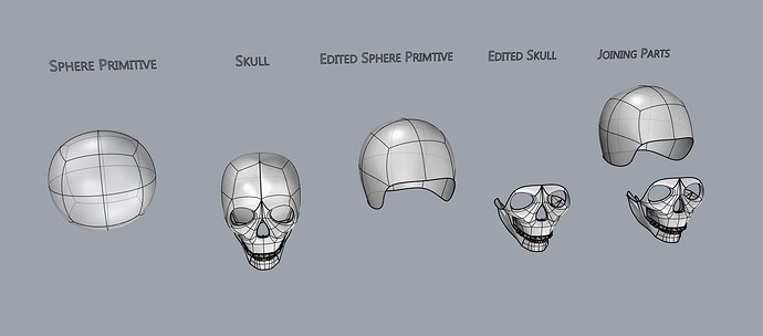

Nice challenge Kyle…thank you for posting.
Biggest frustration was doing tweaks using control points. I don’t know if I’m seeing a bug possibly with the reflect command or just bad modeling on my part. The top of the skull (dome) I originally created using a ball primitive (minimal surfaces) and modifying for the head. Late in the model, an area of the head towards the front would crease when I moved a control point at the jaw and throw off certain surfaces where vertex meet, which would require deleting a face and reworking. Anyway, maybe someone else has had this problem.
Good stuff:
  • Liked workflow starting from primitive form to more complicated modeling in areas of detail
  • Teeth detail…while not necessarily skull realistic, was easy to distort/distress with simple tools
  • Liking control point manipulation of surface features, allowing to quickly move areas. Exception was a control point located at the top of the head on the reflect axis which would jump out of place unexpectedly.
  • Small file size
  • Nice end results
Tool notes/annoyances:
  • Creases seem to come and go…randomly it seems, but probably not.
  • Trouble picking Sub-D edges using Bridge tool…selection doesn’t always work
  • Sometimes after using Bridge command, screen freezes and cannot rotate, move for a few seconds
  • Insert Point to Mesh or Sub-D command doesn’t always seem to work.
  • Reflect command seems to work pretty well, when I Remeshed the original model, the result was not exactly symmetrical.
Might be helpful to have:
  • Ability to see both Smooth / Non-Smooth sub_d objects simultaneously – maybe already exists (split viewports?)
  • Remesh Selected Sub-D Surface ie. Single surface is Remeshed to Specified #
  • Remove Point to Mesh Sub_D (obvious request…opposite of Insert Point to Mesh)

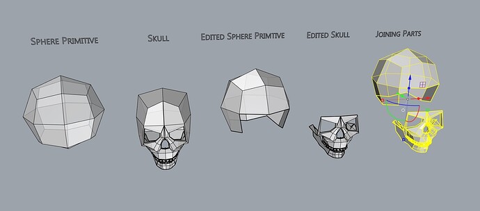

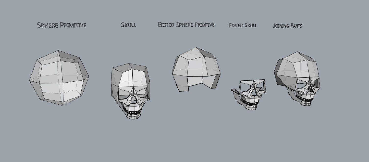

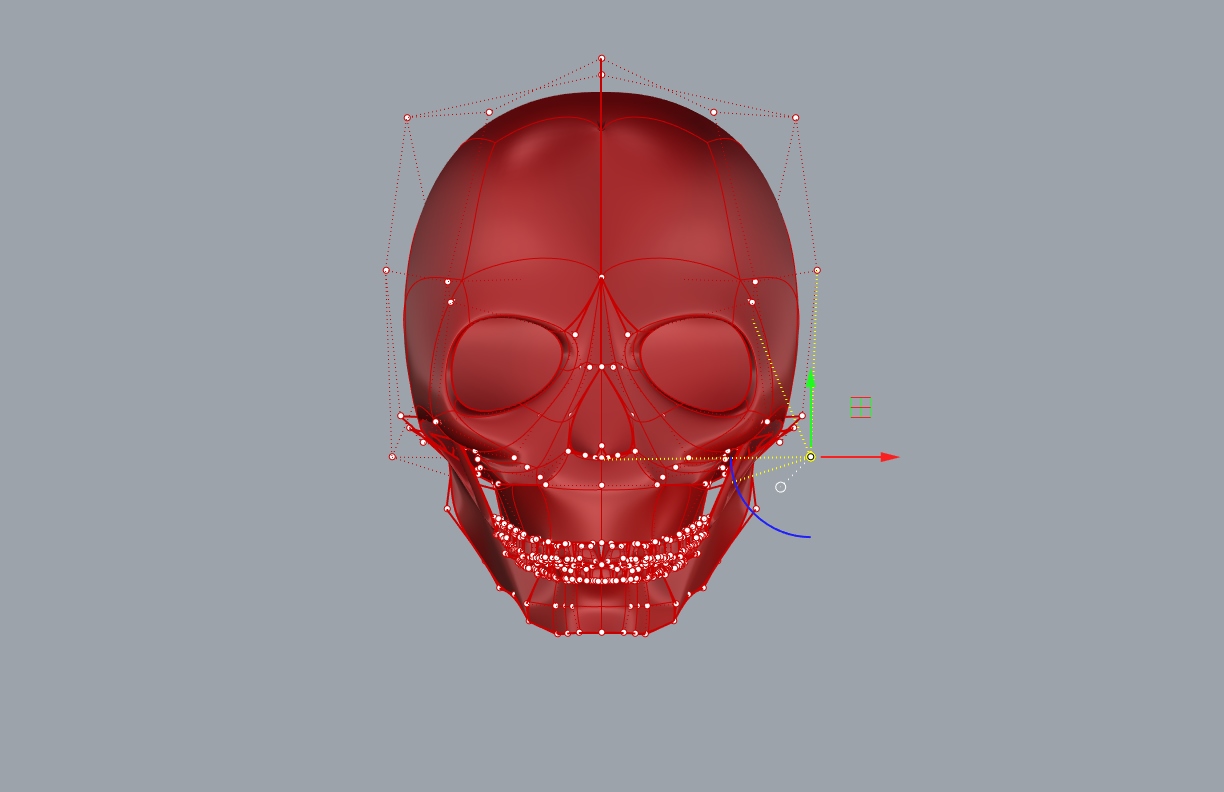

Started off the skull as sphere primitive.

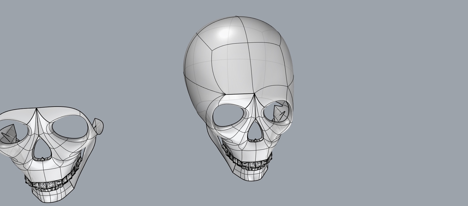

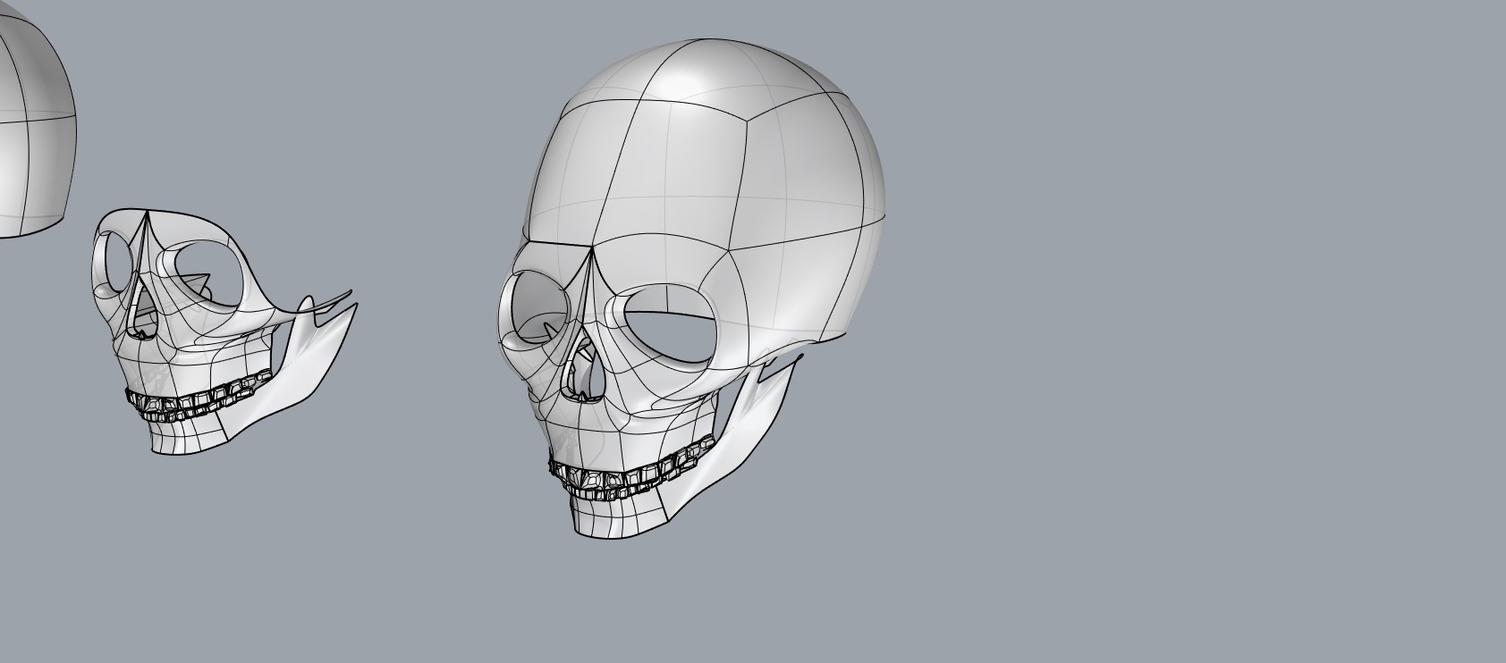

The annoying point at the top of the head was a battle I lost…I would fix it, and it would reappear.
The vertex at the top of the skull seemed to flip into a different state at some point when moving control points in another area of the model.
Moving control point connected to jaw
Results in the a point creation at the top of the head and other surface anomalies

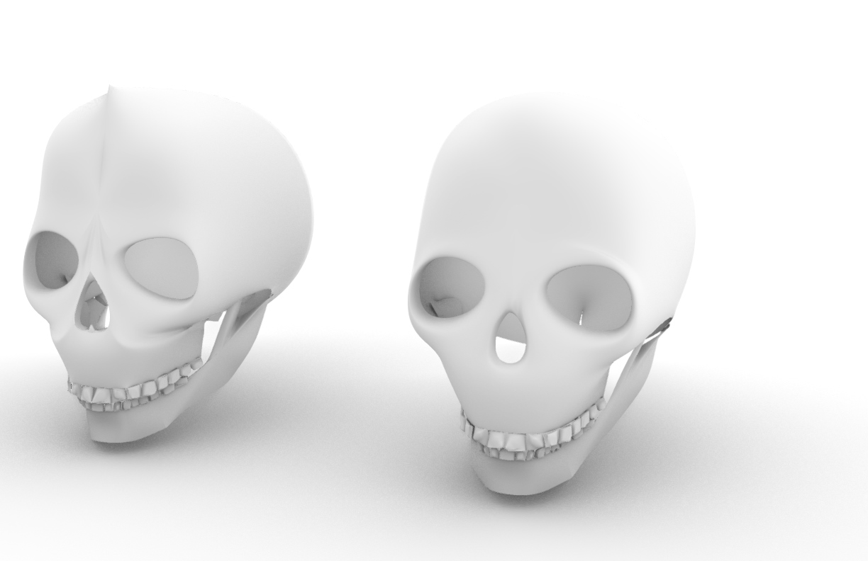

Original model on left, model on right filtered through Quadremesh. Point on top of head less noticeable on Remesh.

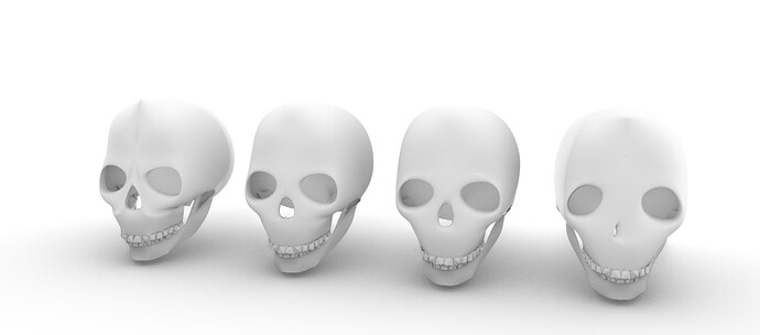

Quadremesh left to right. Original, Target Quad Count: 500, 200 and 100. Noted that the Quadremesh picked up the point on the top of the head at 100. The resulting Remesh of the original is not exactly symmetrical if looked at closely.
The original Sub_D model on left has a weird top of head…this seems to have flipped on it’s own after moving a control point.
nice!! I think the point on the head is a result of an unwanted crease, or a point that needs to be stitched. You can crease a single point, and I believe that is what I am seeing. There are some tools that crease by default (and I’m trying to get that changed) so you may want to occasionally select all and uncrease to make sure they are gone, unless you specifically want them.
Typically I do not use creases, but use a tight bevel instead to get a “corner”
However you covered a LOT of ground here and hopefully gained a better understanding of how to make a very complex model like this.
>> you generally can select and delete a point as needed, it just creates an ngon<<

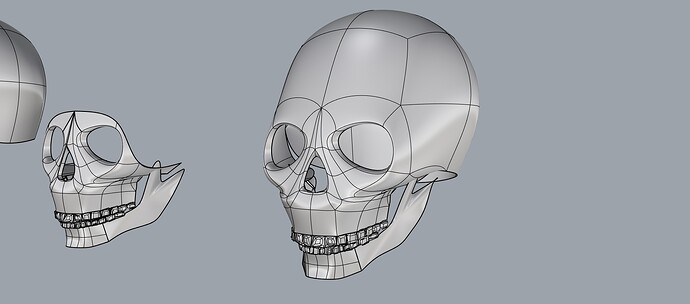

Here’s a solution I tried with the crease created at the top of the skull. Prior to doing this, no matter how I tried removing the crease, the resultant model had a crease in a different area. But, even this method generates an unexpected crease on the left side above the eye socket.
Apologies if too much info…want to make it clear as possible. The results of the Join command continue to feel a bit random.
Haven’t used the “Join” command yet, just positioned parts.
Using command Join: (Sub_DJoinedEdges=Smooth) – crease created above left eye socket, but not above right eye socket.
So, I backed up and tried the Join command again and got different results. And with selecting the area just below the eye sockets and above and “Remove Creases” command it appears correct.
Appears correct after using “Remove Creases” command.

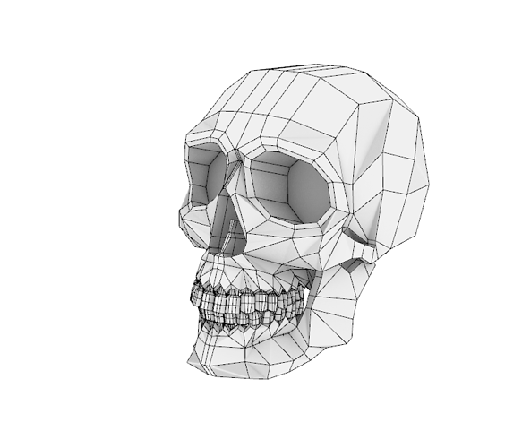

And of course the rough mesh:
As you can see there are many things that could have benefited from more tweaking, but I put a time limit on the build so this is as far as I came in three hours. (You can clearly see in wireframe that the chin is off, but it doesn’t look too bad in smooth mode) My motto for modelling is the same as for nurbs, if the controlpoints are nicely distributed the result looks best AND is easiest to tweak.
I started modelling the eye socket and then worked out from that, then the nose cavity, stiched that to they eye socet, then part of the back head, then the “gum” for the teeth, the bone bridge that the jaw rest against and then stiched all that together. Added teeth and made a mirror of that for the jaw, hid the head part and deleted lots of faces and completed the jaw. Then I reflected the parts. I prefer modelling one side and then just do mirrors to have a look at the whole, and delete those as I go along.
