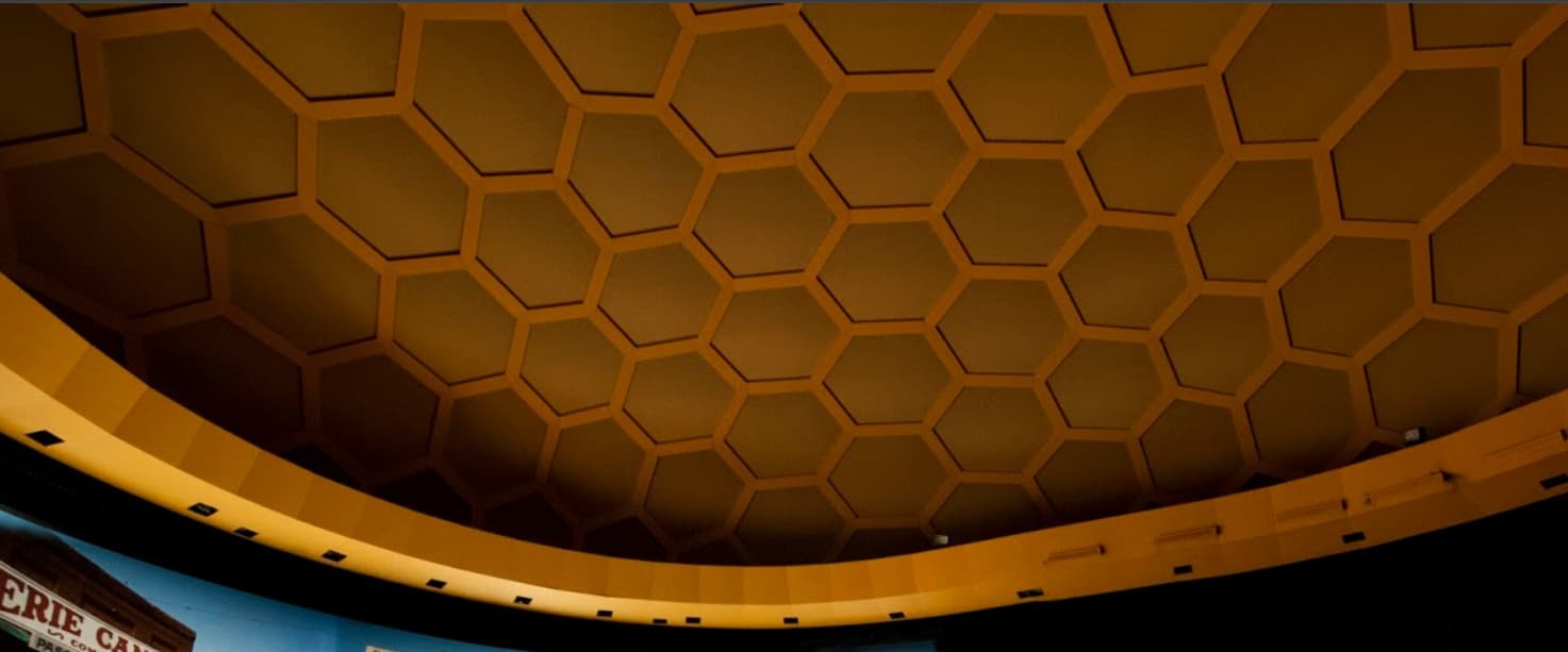

I tried this on a polyhedron with significantly higher face count and got this far after letting it run for a minute:
I am hoping to get a squared multipipe effect as shown in this image… it’s the roof of a movie theatre.
Is there any other approach?
Thanks for any help.
Hi @DanielPiker
I don’t think your image or suggestion will result in the proper shape. You’re going to have little cutoffs on each corner ruining the shape of the dodecahedron. I made a set of these by hand many years ago, the offsetting has to be done from the center of the dodecahedron. You merely filled in the end with a triangle where all the corners should meet up, you need to extend the center lines up to the corner not end them at the junction.
