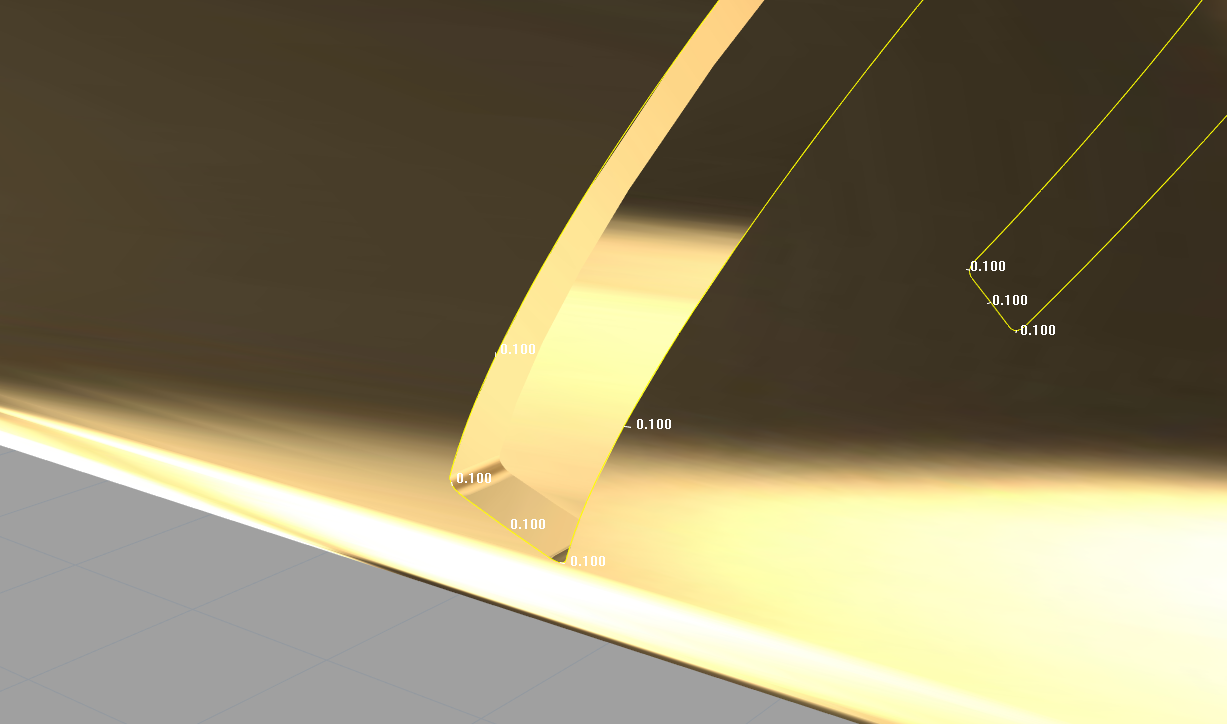

Hope someone can help to understand why my 3d object is not filleting the way i want it to.
I just drew a tube and cut a rectangle shape using “wirecut” out of it.
Now i would like to smooth all edges with “filletedge” at 0.3mm
it should be very easy to round the edges, but the fillets always stay as a surface.
Like this:
I attached my sample file for better understanding.
I’d really appreciate if someone could help me to understand, how i can round those edges correctly.
Thx,
Ron
example.3dm (15.7 MB)
Do you have TrimAndJoin=Yes in FilletEdge? It looks like you may have it set to No instead. It appears on the command line after selecting the edges to be filleted.

All the edges filleted with 0.3 mm radius for me. No need to make any fillets larger.
I copied the base object to a new layer then:
FilletEdge
Selected all the edges using a box with the cursor
Enter
Enter
example fillet edge DC.3dm (15.3 MB)

For this problem you don’t need to make a fillet of the inner radius first. In this example making all the fillets at once works.
