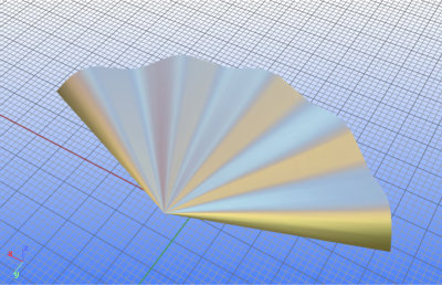

Loft works
shell

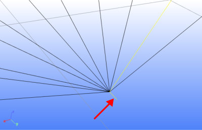

Your fault is at the marked lines. Take all straigt lines, explode them and throw away those little lines. When you now loft the lines, you will see there are more options in the loft command.

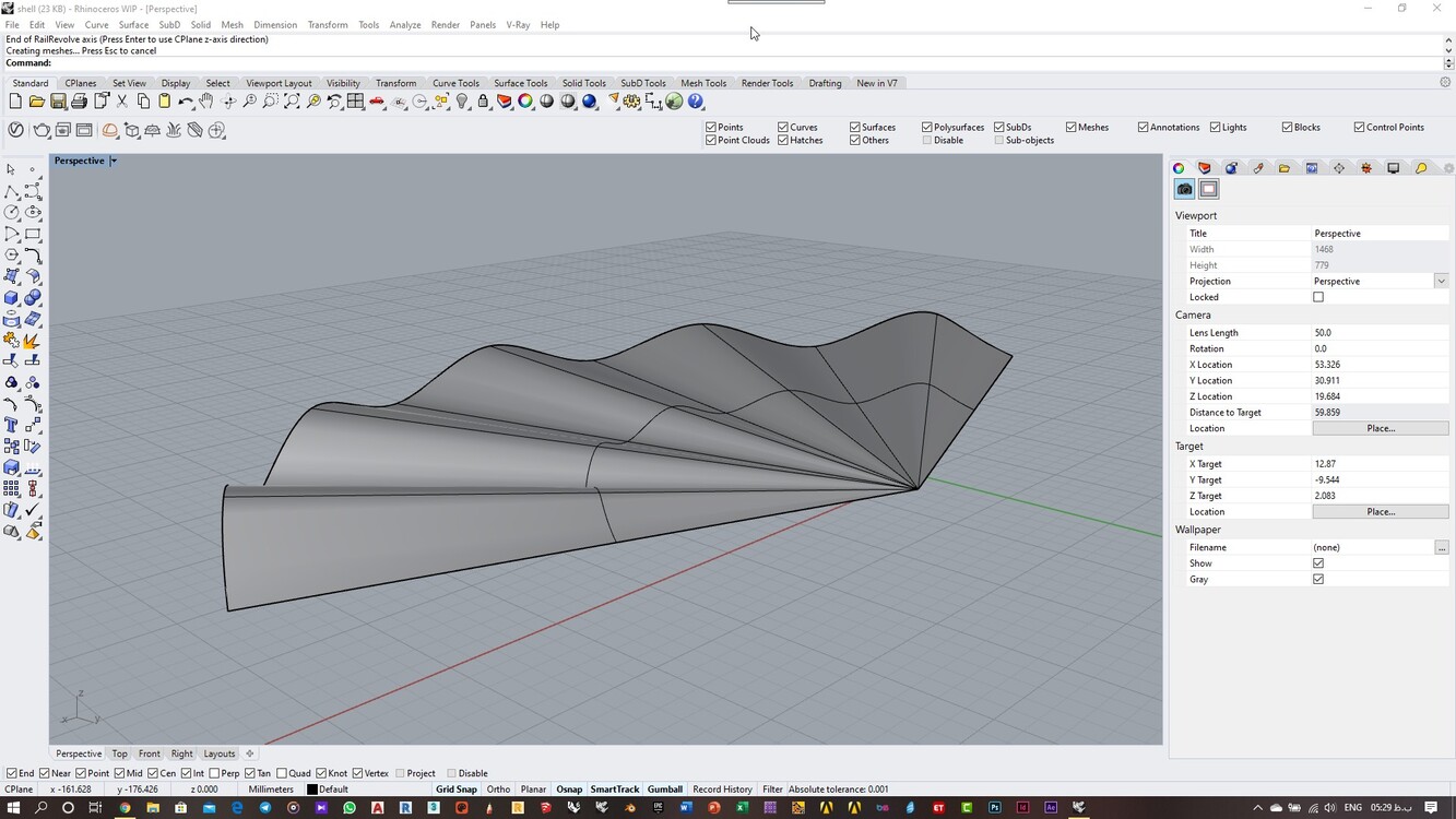

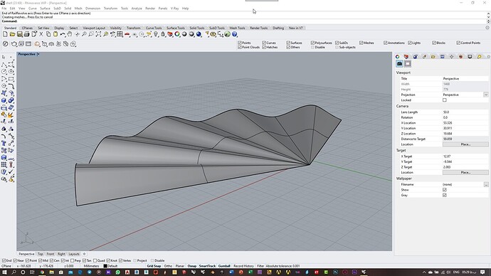

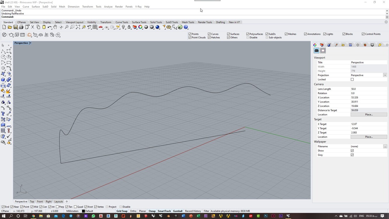

for this file , you can use railrevolve .
first, delete the lines and remain only the first one then run “railrevolve”
