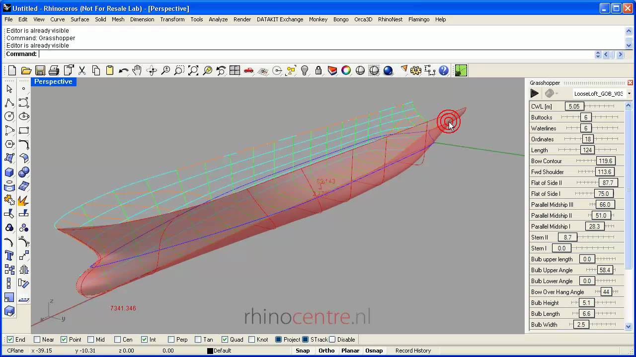

There wasn’t much in that file that you posted. 3 curves and 3 planes that didn’t contain the reference pictures.
At any rate, just by checking the link that I posted in your first thread, I see that there are several videos available. There’s also a PDF and example file. Did you go through these?
Anyway, here are more links with information. RhinoCentre also published a grasshopper definition that you could adapt and use.
https://wiki.mcneel.com/rhino/hullmod
http://www.food4rhino.com/resource/free-rapid-ship-hull-modeling-and-fairing-script
I don’t do hull modeling and it would be interesting to hear from others that do this for a living to hear if they also use a setup like this.

Here is a file showing how to use loft for this hull. The bow is made using loose loft and the main hull is a normal loft
ShipHull.3dm (144.3 KB)
It is a good idea to make curves that match. That is most important if you are going to use loft to create the surfaces. You need to understand that just making curves with the same number pf points is not enough to make the curves matching. The knot structure needs to match also. In the file I made all the curves as copies of one curve (your original curve at the bow). That guarantees all the curves will match.
I would recommend that you use as few planar stations as possible to create the basic shapes.
If you have simple surfaces with few control points it becomes possible to point edit the surfaces to refine the shape. You can use history to project other curves into the surface to use as guides for refining the shape while point editing. You can also use curvaturegraph as a guide to help keep the hull smooth when editing.

I think what you are seeing there is just the coarse render mesh. You might want to set the angle tolerance in the mesh settings smaller or just use a very large number of minimum starting quads.
You have done pretty well at making curves that match well.
If I were doing this I would try to make the profile curves as close to parallel planes as possible and more evenly distrubuted. That will make it easier to keep the hull flow lines from being wavy and bumpy.
ShipHull2.3dm (79.7 KB)
Also if you are going to make this all one surface including the bow , I would make the bow so that it extends a little past the centerline and then trim it back to the mid line and then use Mirror for the other half.

The simple settings are just a slider - you want a denser mesh so that it more accurately represents the NURBS geometry.
There is good information on mesh settings in the Help for the detailed settings(hit F1)
Did you happen to use the “loose” style when you lofted the curves? The loose option produces a smoother surface but the surface does not pass through the profile curves. The “normal” loft is what you want to use to get the surface to be exactly on the profile curves.
You might try lofting the curves with history turned on. You can then move points on the profile curves and see what it does to the surface. You can also use curvatureGraph on the surface since that is the curvature that counts in the end.
Hi Jim and Martin,
I do not agree to use the normal loft as it will result in hours on fairing. Use the loose loft method means that some of the loft curves will be outside the final hull, pulling the surface to the required place. Only the last loft curves and maybe the midship section curve will be on the final hull shape. Loft the whole vessel at one go with record history on. Use less loft curves as is mentioned in the pdf tutorial Powerful Ship Hull Design in Rhino with Rapid Hull Modeling Methodology.
As the final shape should match the original linesplan , do the following: create ribbons (Rhino function _Ribbon) on some of the original curves, per curve one red to the inside and one green to the outside. Make the height of the ribbons a certain percentage of the breadth. Now you can play with the loft curves to match the ribbons.
Good Luck,
Bas Goris
RhinoCentre.nl
Who are you not agreeing with? I was explaining the difference between a loose loft and a normal loft, A normal loft will produce a surface that the curves lie exactly on the surface. A loose loft the surface will not pass through the input curves but the surface will be smoother.
It is not impossible to get a fair surface with a normal loft but looking at curves in the picture you posted lofting curves that are organized like that will likely produce a very messy surface using normal loft. With curves arranged like that the only hope for a manageable surface is to loft with the loose option .
