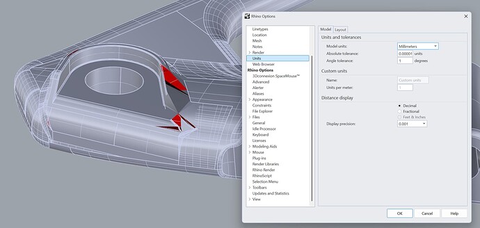

Hi, I am unable to import sldprt files made in the newest 2025 Solidworks into Rhino. I get a message in the command line that says ‘can’t open that file’. Files made in the older version of Solidworks can be imported without issue.
I am working on a window computer with Rhino Version 8 SR15.
Any ideas on how to solve or work around this issue?

I can import SW2024 but SW2025 *.sldprt fails.
Unfortunately *.step is causing issues all the time with trimmed surfaces.
Also the filesize of the same geometry exported as *.step is over 3 times larger than *.sldprt

the thing to keep in mind when working with Solidworks is to make sure your SW tolerance and your Rhino tolerance are identical in both directions. SW tolerance is insane… it’s like 4 decimals if not more, and as far as I know there is no way to change it so you have to crank Rhino up to full mach crazy in order to match.
Thanks for the hint about the tolerance but this looks just as bad with 0.0001 units absolute tolerance…
The same dropout with 0.00001 units absolute tolerance:
I mostly need the files as meshes for alignment of scans in Artec Studio and for CFD which also means we need to remesh or shrinkwrap…

Solidworks does not have a user definable tolerance like Rhino, so you’re kind of stuck in that regard. There are a few options to try changing in SW when exporting to STEP - split periodic faces, etc. Doubt that’ll help with the fillets though.

For the type of model you are working in there is nothing that is easier and quicker than true fillets, but your real problem is a terribly messed up STEP import.
First of all just by looking at the fillets in your picture I can tell that was not modeled in solidworks. Solidworks makes fillets that are almost identical to the fillets made by Rhino’s FilletSrf command.
My guess is that this was modeled in Catia or ProE and imported into swx. That is where many of the errors may have been introduced and then more errors were introduced with the swx STEP translation to Rhino.
Your best bet would be to get a STEP file created by the original program where the model came from.
If that is not possible then I would change the tolerance in the STEP file that came from swx. To do that open the file in a program that has a search and replace function like Wordpad. Search for the word “uncertainty”. You should find at least one line that looks like this:
UNCERTAINTY_MEASURE_WITH_UNIT (LENGTH_MEASURE( 1.000000000000000082E-05 )
Since the file looks like its in Millimeters you want to change that to
UNCERTAINTY_MEASURE_WITH_UNIT (LENGTH_MEASURE( 2.54E-03 )
There may be more than one such line. Replace all instances and the save the file with a new name. Then import the file into Rhino8 and see if a lot of the errors go away.
Also, in Rhino you should set the units and tolerance to match (.0025 mm) and then import the file into Rhino. Do not check the join box in the STEP import dialog box.
After the file is imported into Rhino and you have just loose surfaces, you can select all and try to Join the model. If it joins correctly you are done.
If you have naked edges after the Join attempt, then run the DupBorder command and copy those curves to the clipboard. Then undo back to before you ran the Join command and paste in the curves that you copied.
Now you can go around the model where the curves are and fix the errors. You may be able to easily replace defective fillets with FilletSrf if you use the exact same radius.
You may want to make the curves that mark where the bad edges are a distinctive color and make them display thicker so that they’re easy to spot and find.
Don’t join any surface until after the surfaces and edges are fixed. Joining surfaces with defective edges may cause neighboring edges to go bad.
Edit: If in the process of untrimming and retrimming surfaces to fix them you find that the edges are farther away from the surface than the .0025 mm that you set in the uncertainty line of the file, you may want to start over and set the tolerance even looser. Pull curves to surface and use CrvDeviation to determine how far the edges are from surface.

Thanks for these instructions. The file was not created in Solidworks. So far, the software the partner has used remains unknown.
I replaced 3 instances of the uncertainty entry and the result looked a bit better with 2.54E-03 again a small bit better with 1.0E-02
I need the files for alignment and CFD so to be honest a shrinkwrapped mesh is perfectly fine. I’m just a bit frustrated that it doesn’t work with the NURBS model.
