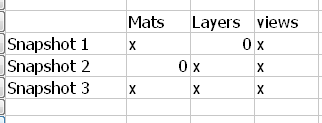

Maybe it would be helpful to get a table UI and the user can click per right mouse button on a set and update this only. Attache a raw description screenshot.
For example at Snapshot 3 I could update the materials only.
Yes, I think that’s a good idea, and will avoid duplication.
I don’t see why you would need to have different views and layer states setup independently, when there could just be a series of snapshots. Assuming setup and saving snapshots is as easy a NamedViews.
