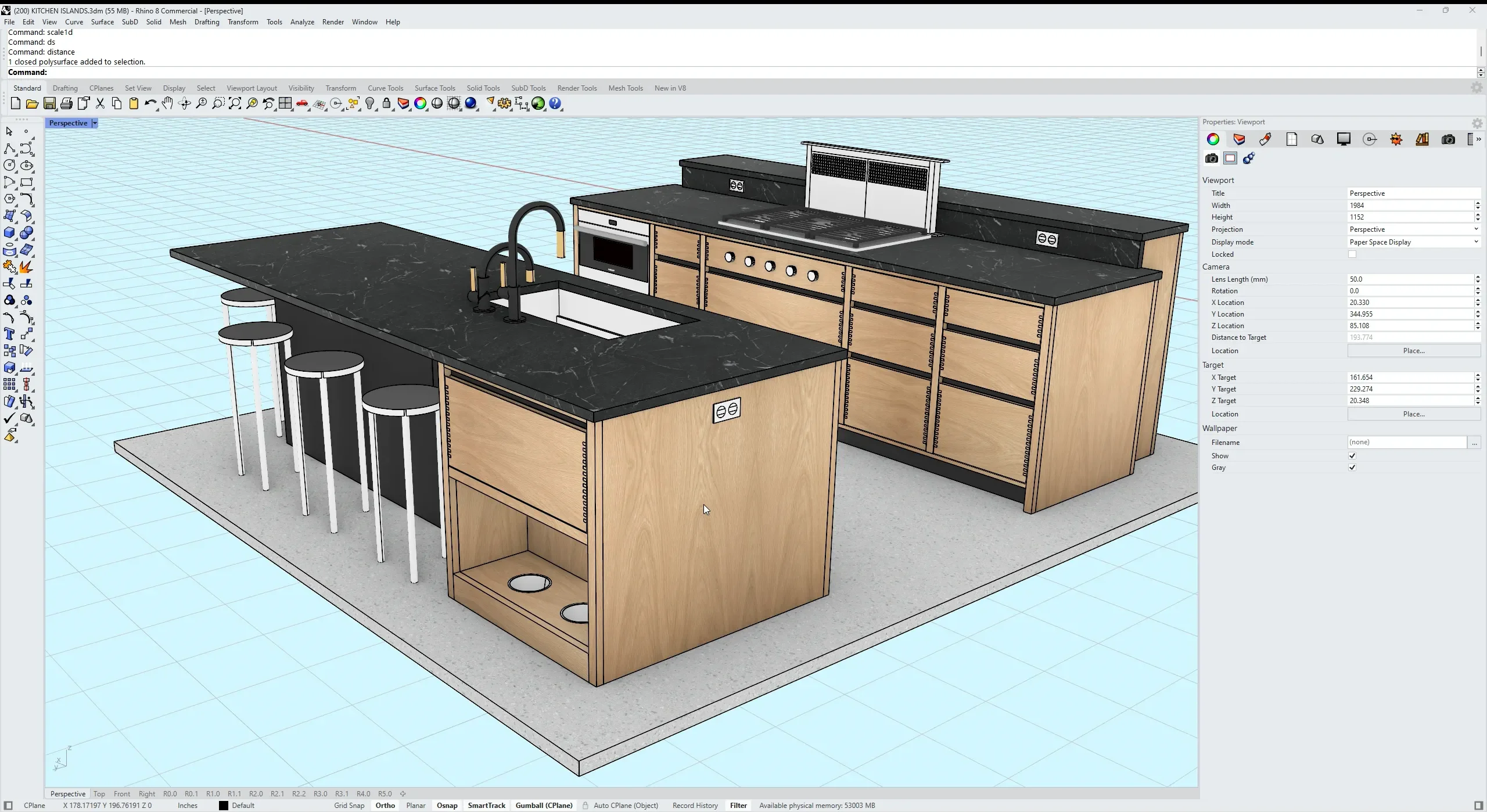

Was in issue in Rhino 8 Beta and still is an issue in Rhino 8 Commercial. When using distance, move, scale 1d, tab, etc etc, cursor trys to snap to occluded objects despite the option being toggled off.

It says the current state is DISABLED. Been happening in every file for over a year. It doesn’t happen if I just draw a simple cube with a curve behind it. It takes a pile of occluded geometry to confuse the snaps

Hi Brady - the culprit in Rendered modes is the ground plane - if that is on, the depth testing is messed up - it will be fixed in 8.2, but in the meantime, turning off the ground plane should sort it out.

Hmmm. Just tried turning off the ground plane in rendered mode but it didn’t fix anything. In fact, the modified rendered display mode I use the most never had the ground plane turned on in the first place.
Hi Brady - m… in your file, here, the GP setting exactly corresponds to the snap problem… I wonder what else is going on - can you please export the display mode you use and post it here?
Also, @brady1 - please try toggling the GP from the GP panel and not in the display mode settings…
Here is the display mode I use the most, but the issue was also happening in normal rendered mode even after turning the ground plane off

Hi Brady - this should be fixed - I believe you can now get the SR2 service candidate release via Options > Updates and Statistics page, setting the update frequency to Service Release Candidate. And Update Now.
Hi Pascal,
Just downloaded SR2 and the problem still persists. Screen recording and system info posted below.
