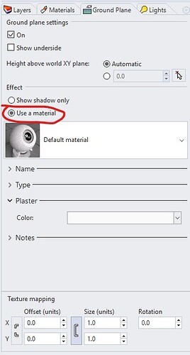

Has anyone solved this problem? I seem to have the same bug in Rhino 7 on Windows. I set the ground plane to use the “show shadows only” effect, saved it, and closed Rhino. When I reopen it, the setting reverts back to “Use a Material.”
I suspect this has something to do with the block… or not? Does anyone have any ideas?
That setting is part of the Rhino 3dm file itself not a global setting. See if you can change it and then use SaveAsTemplate to save a new template 3dm file with the change. If that works, you can then change the template file you are starting with by overwriting it.
Yes, i believe it is part of 3dm file but still. When I save one small file, it remembers this setting so when I open it, the ground plane is set as it was after saving it.
But there is another file (with many blocks, materials ets - whole detailed bike) that, when I open it after saving whith setting “show shadows only.”, It opens back with deafult “Use a Material.”
Saving this fail with corret setting does not work either. And even if it worjed, the file has 176MB with bunch of layers etc… which does not make sense to save it as a template.
I have just found the bug, at least part of it!
In that file, I have had attached Solidworks parts and assemblies as linked blocks (to be able to update them when I change them in solidworks without replacing them in rhino). When I deleted those blocks, the ground saves correctly!
