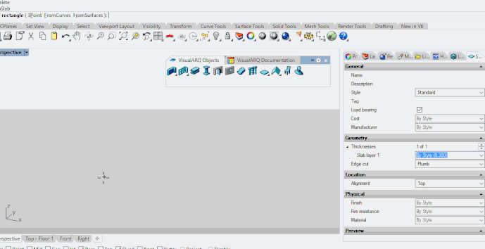

I’m following the ville savoye tutorial and got my first problem.
When creating a slab from a curve, I can’t pick either the direction of the extrusion (goes the negative way) nor the thickness of the slab (default is 0.3, I need 0.1). Trying to type the desired value doesn’t work in the commande line or in the slab layer property.
Never mind, I ended finding the solution but I find It quite counter intuitive. Why can I not choose the thickness when I create the slab? (Forgive me but I use Maya, Modo and Lightwave and the aproach is very different, I need to get used to the way Rhino and visualArq work.)
Hi @marchermitte you can change the slab thickness when you insert it. The slab thickness is defined by style, but it can be changed by object individually:
Ok, thank you. For any reason It didn’t seem to work the first time I tried. NOw It does, I might have tried in another menu (properties?)
