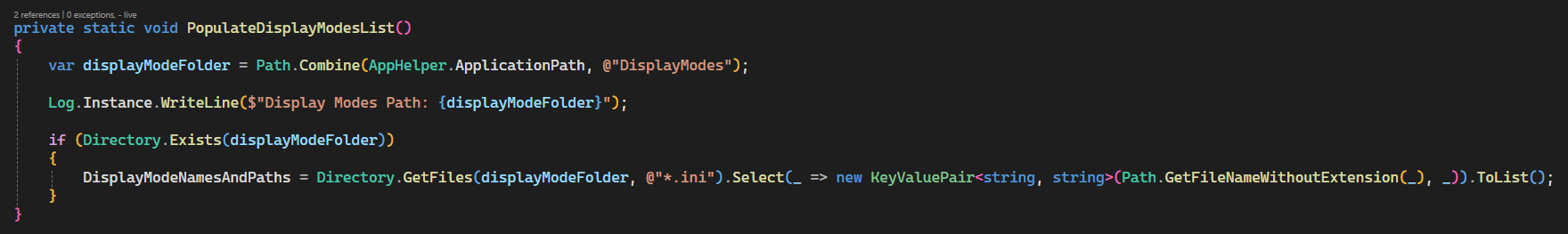

  1. The third question on Display Modes, we handle by deploying the Display Modes that we’ve created from within Rhino to our install folder, and then check for and import them at run-time. You can create the display modes, and export them as *.ini files.
I’ve written this code to dynamically get a list of display modes that we want to look for on startup:
And we load the DisplayModes like this:
Hope this helps.
