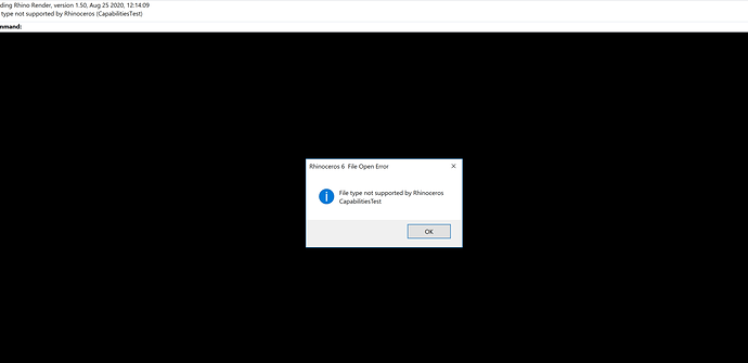

I have a problem with using my custom skin. I am using a downloaded example
Customize skin - Rhino Developer - McNeel Forum (github.com)
Changed app name to my own, built as .rhs, but i guess i do something wrong in registry
i have even followed the guide Using Schemes to Start Rhino [McNeel Wiki] but still the same error
Hi @aleksanderdynarek,
Make sure there is no space between /Scheme= and the scheme name.
For example:
C:\Program Files\Rhino 7\System\Rhino.exe” /scheme=MySkin
now it doesnt show any error like file type not supported, but doesnt show any result either
i am using yours example from github, no chanes yet, just to test
