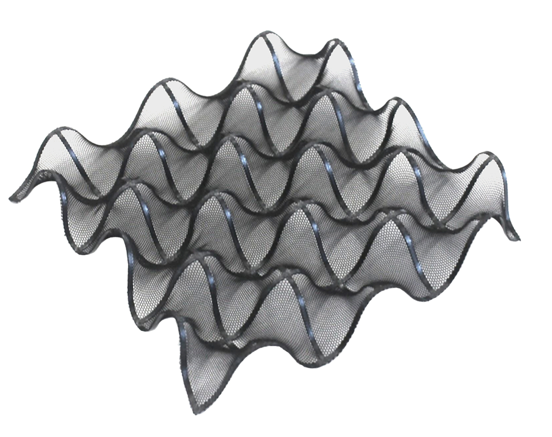

I was wondering if is there any chance to simulate(even unnacurately) the behaviour of a textile of any fabric like lycra to see how it folds after you 3D print over it.
I attached a youtube link for the behaviour of the textile I want to simuate. I am relatively new with kangaroo I read the manual and made several examples to make tensile structures but I dont know if there is any way to simulate that behaviour with kangaroo. The idea that I had was to simulate the fabric and see if can get one of these results before physically doing it.

The 3D printed boundary must have the same length both in 3D and 2D. The textile is just pretensioned. The final shape is an equilibrium one.
The only difficult thing I see is to do this without any anchor points.
Here’s a starter. It needs a nudge to start the buckling out of plane
For more accurate simulation of the boundary you might also get better results with the beam elements, since they also model torsion.
For more complex boundary shapes, you could model these as flat shells with bending resistance and then minimise the membrane. I used this approach back here (though using Nucleus, but same principles would apply with Kangaroo):

As you found - it will work without the remeshing step, but I added that because if the the quads are all diagonalized in the same direction and treated as springs, it can introduce a slight directional bias to the fabric tension, which might not be what you want.

Hi Daniel@DanielPiker , thank you for the starter. This is very similar to my current research. May I ask you for some hints on the more complex pattern simulation?

From my understanding, the core of the simulation is the angle constraint. I assume the internal pattern may affect the exterior pattern as well. One proof is that I feed the crease as following.

I was wondering is there a better way to make the crease affect the system as a “whole”? Or do you think there is something I can implement? My simulation result is the following and you might notice the edge is not curvy as the 3d printing file(which is 3d scanned after printing).
