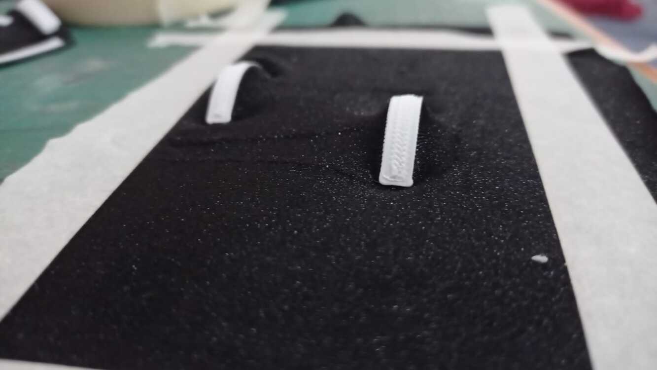

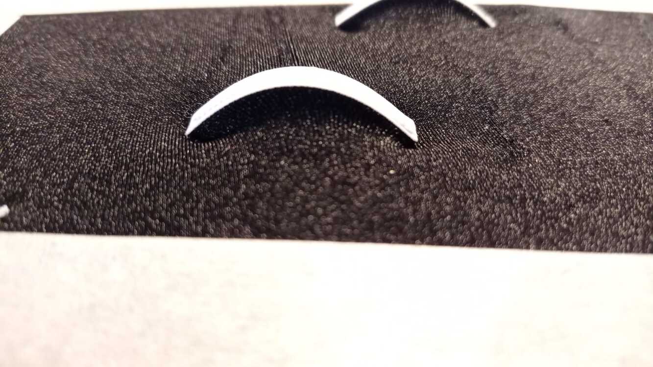

lately, I have been making some experiences and tried to 3d print simple lines over some
stretched lycra fabrics.
I want to create a model that will simulate the bending result (adding reference pictures),
but currently, I am a bit clueless about how to do so.

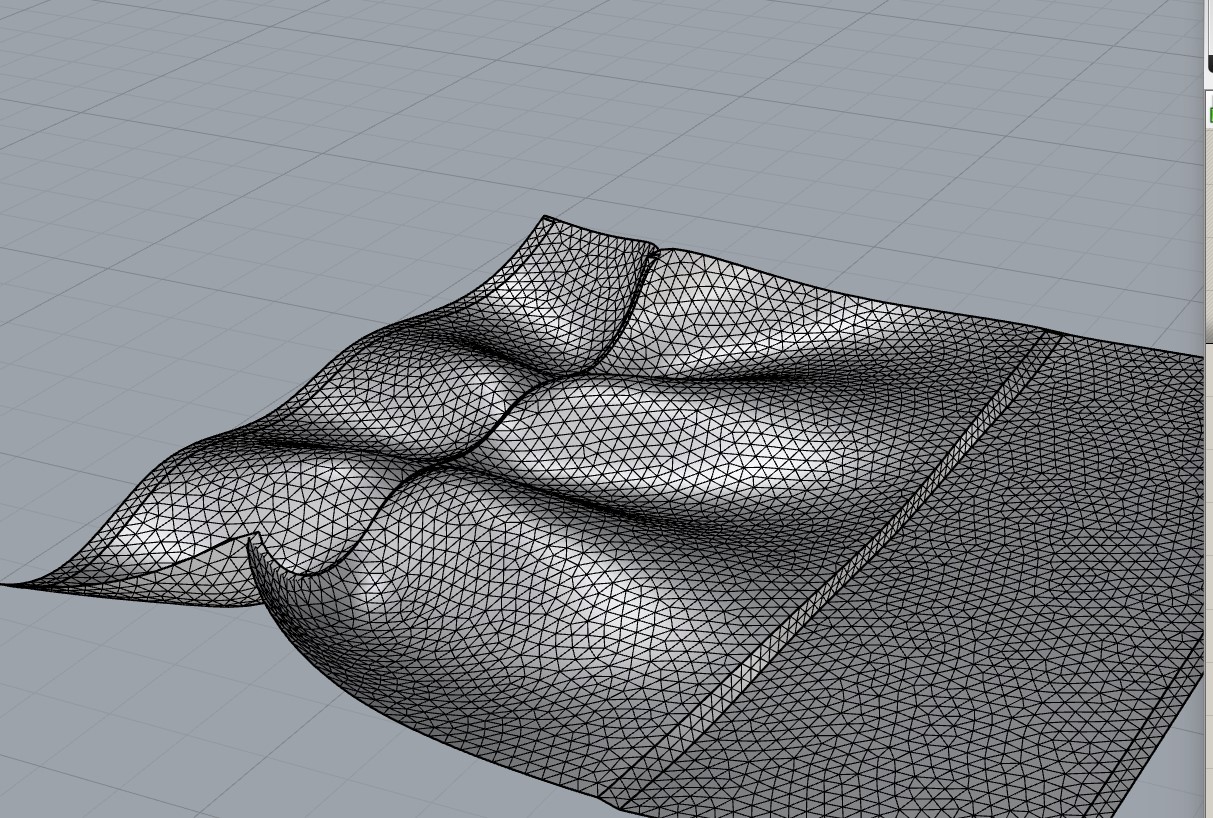

One way could be to make it all one mesh, and treat the bending parts as shells, and for the rest reduce the rest length by some factor to give tension like this
fabric_buckle.gh (21.7 KB)

I’ve been trying to use this example to simulate buckling of multiple lines but not sure how to automate it, at the moment only the first two are taken into account- do you have any tipps? Thanks a lot in advance!
fabric_buckle-ak.gh (15.9 KB)
