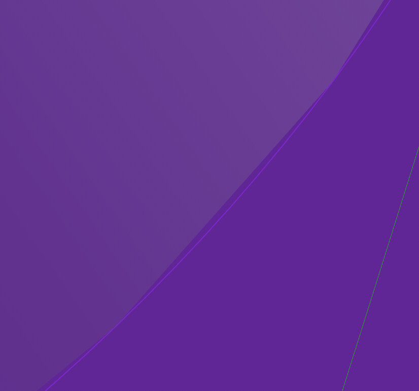

I hate to bring it to you, but it is again meshing settings in your document that cause the bloat. The three selected parts in the screenshot below take 85MB of the file size…
Now, if I set document properties meshing settings to Jagged & Faster I end up with a 1.7MB file.
Even setting it to Smooth & Slower saves the document as only 2.3MB
My guess is going to be that you have a template set up such that it uses insane meshing settings.
Each time you see something like this happen, please first check your document meshing settings, followed by a check for custom render mesh settings on objects you just pasted from another document.
Holes still look good with Smooth & Slower
And IMHO even with Jagged & Faster, although there a bit of jaggedness is visible
But mostly only when zoomed in very closely
