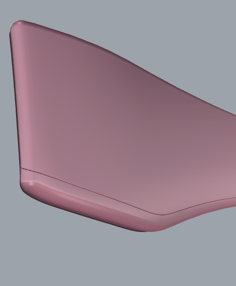

It seems that Shutlining is now buggier then ever… I can’t get it to work on most of the objects I tried it on, I have to copy/paste to/from v5…
I join an example where the mesh is just not rendering when I apply Shutlining to it.
sl.3dm (2.5 MB)
Hi Marc - I’ve had good results so far and I’ve been using a fair bit - I’ll check your file… thanks.
Looks OK here at .007:
Are you not getting that type of result?
Thanks for looking into this Pascal.
When I tried on this object, and several others in this file, the display for the object would turn to wireframe, like it didn’t even tried to modify the mesh…
I am on WIP 2017-03-28, I’ll update and check again.
Yep, on 2017-04-04 it works nice and fast!
