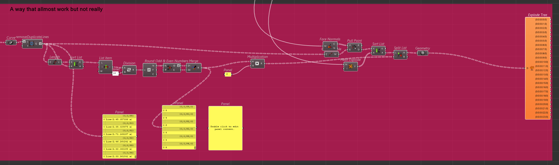

I am as well traying to select/ group some faces along curves but this workflow is not working for me. I tried some things but it doesn’t work. I will be really grateful if someone can help. In the photos I will show how faces I would like to group. PS. sorry for the messy script.
mach mesh faces on both sides of an axis gh.gh (138.9 KB)
This is a newer version of the script, but it still doesn’t work the way it should. I tied sorting the mesh faces to the curves with closes point to the midle point of the axes and then splitting the faces list with an index du to the number of segments x2 I have splitted the voroni curves / axes. Fore some cases it works but for others it desn’t
mach mesh faces on both sides of an axis gh.gh (135.7 KB)
Just in case anyone is interested here is the answer.
