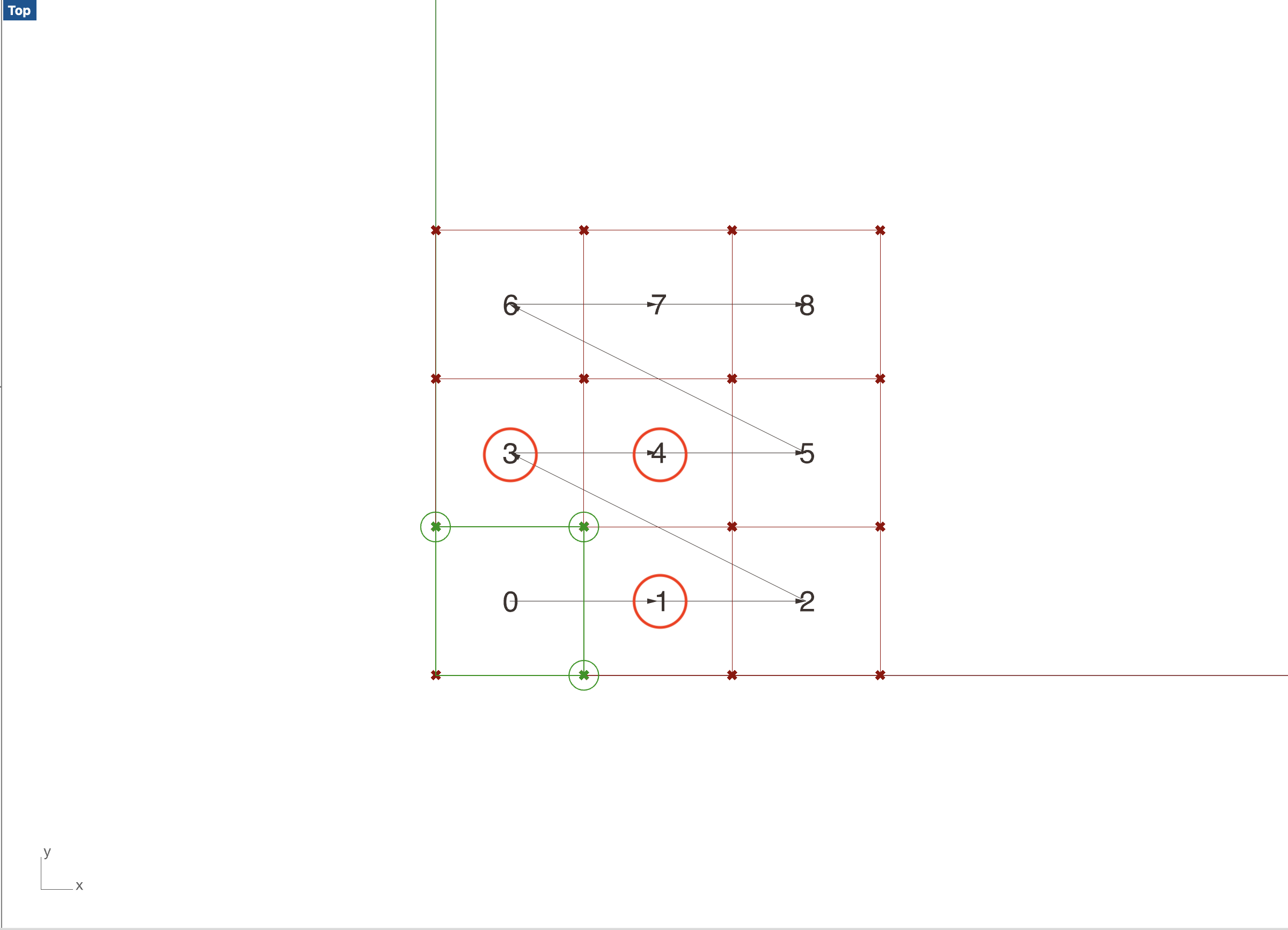

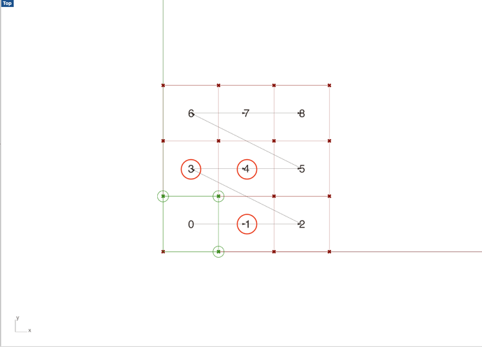

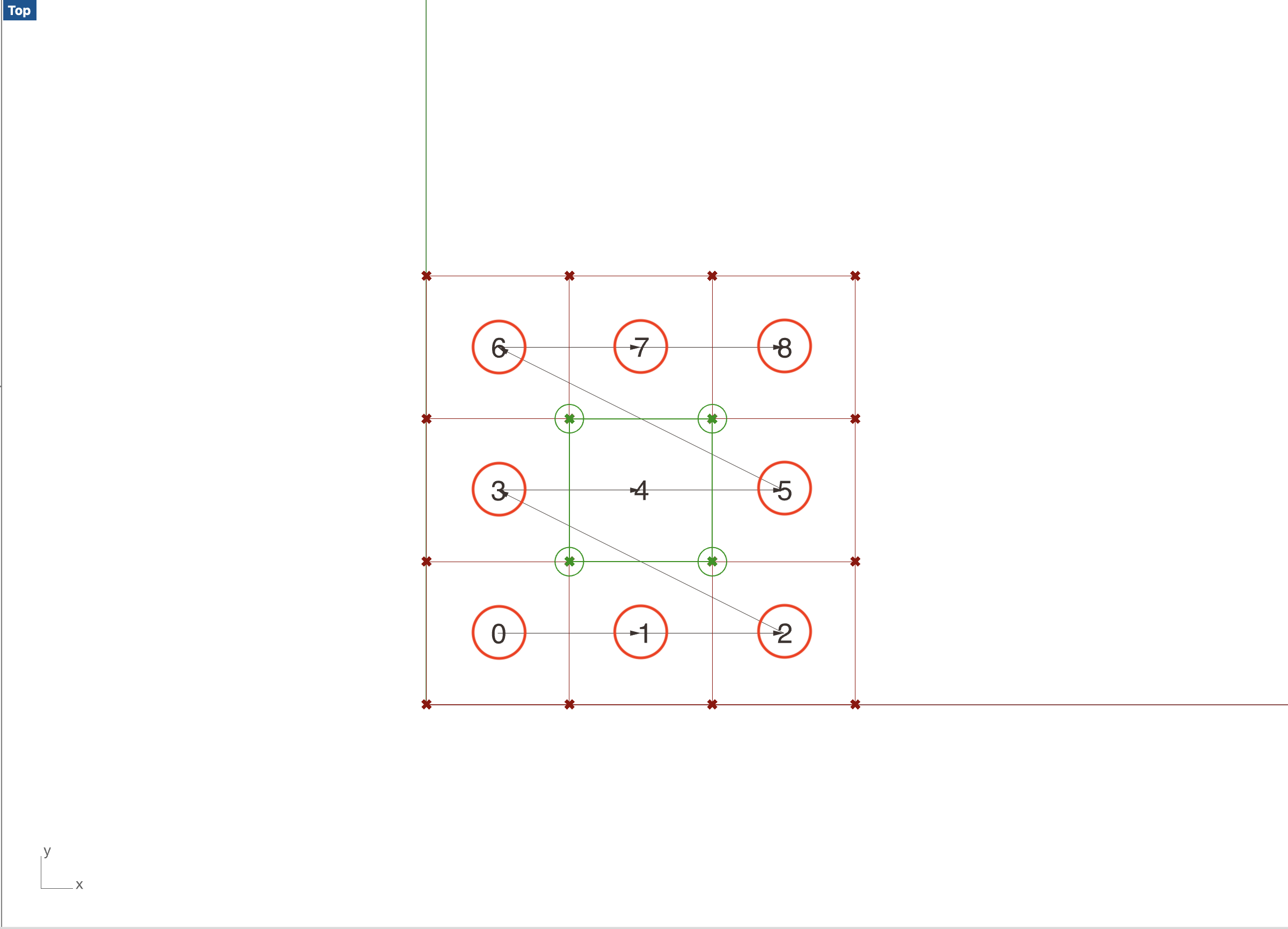

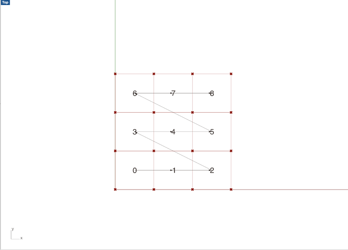

I have what should be a fairly straight forward task.
I have a list of closed curves (main list), and I want to test each curve within the main list to find the other closed curves that share a coincident vertex (neighbor curves). In the examples below if I am testing curve 0 the neighbor curves would be curves 1,3,4 and if I’m testing curve 4 all curves are neighbor curves.
The goal is to be able to call on any single curve from the main list and be returned a list of its neighbor curves. Eventually, I want to create a “periodic table” of these curves where each curve in the main list can be grouped with only its neighbor curves.
Attached is a simple example. I’m not including the .gh file because the example file is arbitrary - the curve set (main list) I will be working with is much more complex.

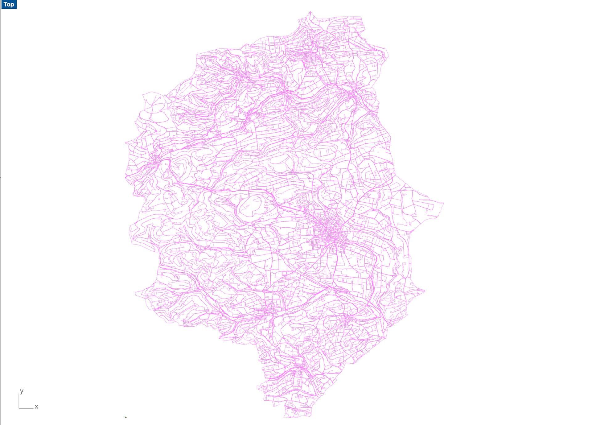

Your simple grid example is useless for the real problem you want to solve, which involves coincident edges on 12.5K of irregular shapes (closed curves) spread over a vast distance. (working far from the origin can cause problems for Rhino/GH)

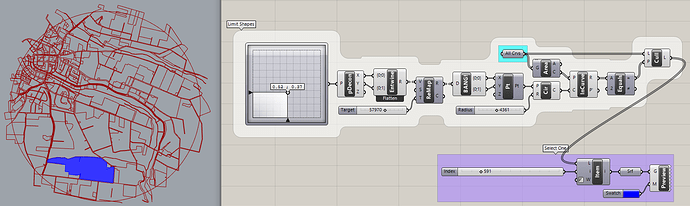

Here is a way to select a subset of your 12.5K curves:
coincident_edges_2022Oct5a.gh (267.1 KB)

You can internalize a subset of your curves and completely ignore the Rhino file:
coincident_edges_2022Oct5b.gh (423.3 KB)

Thanks @Joseph_Oster, I had been creating sub-selections by calculating the area of all curves and then using the ‘point in curve (InCurve)’ component to reduce the total scope, but this is a much faster solution. I’m looking at the other replies you and @HS_Kim sent, thank you for your help.
This is what I had been originally working with. The portion of the definition that actually tries to do what your definitions are doing is grouped in purple and is tweaked from another post I came across and doesn’t actually do what I was trying to do, this will be much more effective to work from, thank you!
ARCH1105_Site_Sorting.gh (276.9 KB)
ARCH1105_Drawing_Medebach_Landuse.3dm (14.0 MB)
