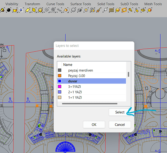

I want to know that in Rhino, how could I select any objects (_SelColor,_SelLayer.etc) from selected area? In AutoCad I just select the wanted area and then command quickselect but when I try to do it in Rhino I could not find it. Any solution?

No it’s not about dimensional area or like this. More simple. Click and select objects and then between them I want to select the objects that the same color ones or in same layer ones.
If I use SelColor or SelLayer command it selects from all drawing.

I think it’s something like _Lasso but using previously drawn input geometry… and then not just selecting everything inside the boundary, but selecting it with various filters.
in that case, Window select the blue area, Invert, Lock and make your selection.
Hi @Zambak
I think the tools are there. Look at Isolate/Unisolate, Lock/Unlock, Hide/Show and combine them with the various selection filters and selection methods, especially SelBoundry if your desired area is more complex than a rectangle. Eg. using Isolate, you can isolate the geometry in a given area and then use what ever selection method you want (eg. SelSmall as shown here) on only the visible geometry. Then Unisolate to bring the rest back. Also, you can use Named Selections to create saved sets (and you can add to those sets as you go along).
