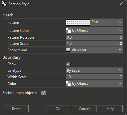

Does anyone have a successful and efficient workflow for setting lineweights to sectioned VA objects?
The two methods I know of don’t appear to be working at all and are the following:
VAobject Section Style → By Layer → By Rhino Layer Dialog
VA Section Style by Layer (Great!)
If you direct a VA object to set it’s section style by the layer the object sits on, the hatch pattern will work with some consistency, but section line weights will not.
Additonally, withing the R8 section style dialog, you can set the lineweight as a “Scale” or as a “Linetype”, which allows you to target a set of a user created linetype from the properties window.
This would be ideal, as it would mean standards across types would be more easily matched and there’d be less fumbling in VAObject menus trying to remember which object you need to modify. You can just go to your layers or to your linetypes and keep it all organized there.
VAObject Section Style → Custom
This allows you to directly set an objects section style via custom properties per object or object layer. More cumbersome to operate since you have to jump between objects to control them, but still workable (if it worked). For example, if I have a concrete slab and a concrete wall, and I want their section properties to match because they should both be recognizably the same material type, I’d rather do that from one location.
Here’s the catch: as far as I can tell, none of these methods work. I have been unable to successfully change the lineweight of a sectioned object (and then print that lineweight) by any method.
Am I missing something here, or is this feature simply not working?
Hi @Clayton_Muhleman the Rhino 8 Section styles dialog doesn’t have the property for a boundary print width. There’s a scale attribute and linetype thickness for the section boundary, that could be used for that, but it currently works for display only, and doesn’t apply to printing results. It’s a pity, but it makes kind of useless to assign the section styles of VisualARQ objects “By Layer”, which would be the most convenient and desired way, because you have no control of the boundary print width.
However, I think this has been improved in Rhino 8 SR14. (I have not tried it yet). Check this out: https://mcneel.myjetbrains.com/youtrack/issue/RH-80568

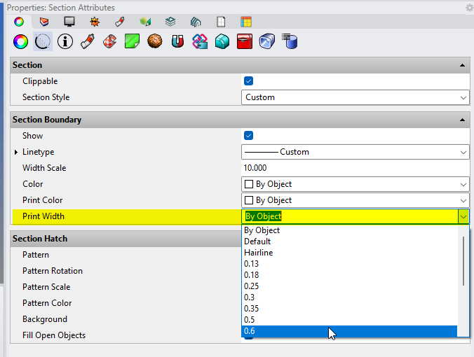

In the meantime, as you well know, in VisualARQ 3 we have integrated the Rhino section styles into our dialogs, and have added a Print Width attribute to have control of that missing attribute in Rhino8.
You can find it in the VisualARQ styles dialog:
And also in the Properties panel (Section Attributes):

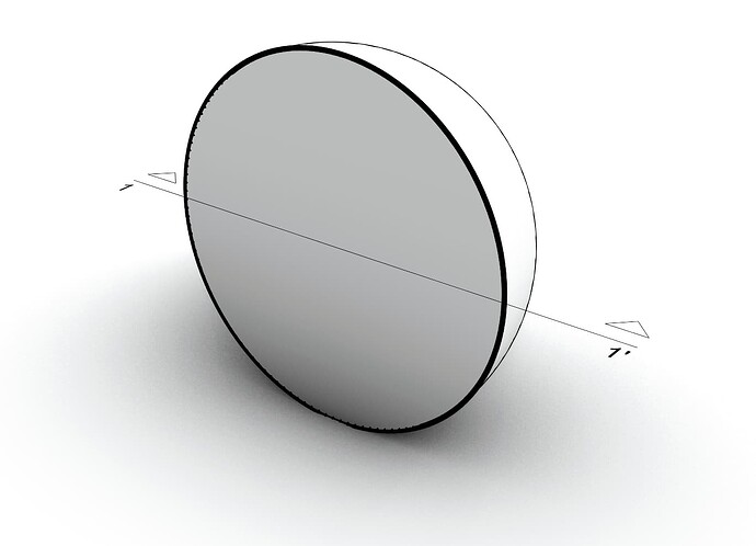

I’m trying this with Rhino (8.15.25007.13001, 2025-01-07)… using different display modes (Wireframe, Technical, Shaded…) and printing to raster or vector output. No success!
In my test, I have two curves, the straight one has a print width of “hairline”, the other one a Print Width of 1mm, (just to compare).
Then I have a cone, that has as section style a boundary with a “Width Scale” set to 1, and the linetype has a Width of 1 millimeter.
I’m sectioning the cone with a Clipping plane. So VisualARQ is not being involved at all here.
There is no way to make the sectioned boundary of the cone be printed with the same width (1mm) as the second curve.

The section Print Width attribute is currently missing in the Plan/Section View Sytles Overrides. We can implement it, including the “by Object” option.
@Sebastian_Wimmer this has been fixed in VisualARQ 3.3. You can download the latest RC here: -3-version-3-3-rc3-released/201601
@Sebastian_Wimmer we have added the Print Width attribute for plan and section view Overrides in VisualARQ 3.4 RC1: VisualARQ 3 - Version 3.4 RC1 released
