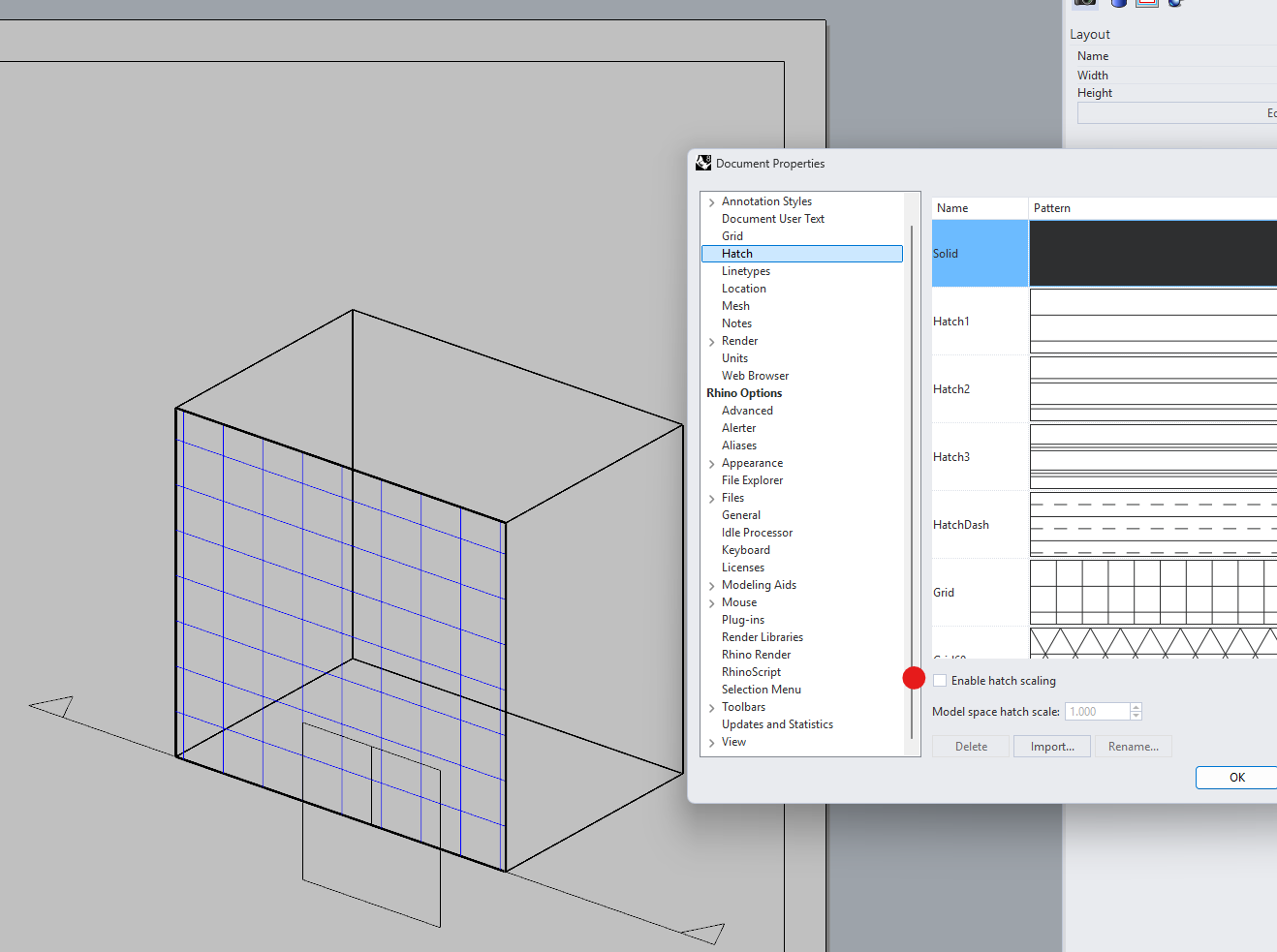

Hi Gabrielle,
Most likely you need to uncheck the Hatch Scaling.
If you are having an issue please post a small example file.
