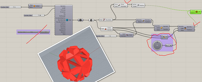

Hello everyone,
Any help would be appreciated.
What I am trying to do is to offset the face boundaries, rotate and scale them by the face center so they remain in place and then loft the original with the scaled lines.
I believe I must be doing something really wrong with the data trees.
Thank you for your time.

Hello Kim,
Thank you so much it works great.
Wasn’t as complicated as I was thinking in the end.
