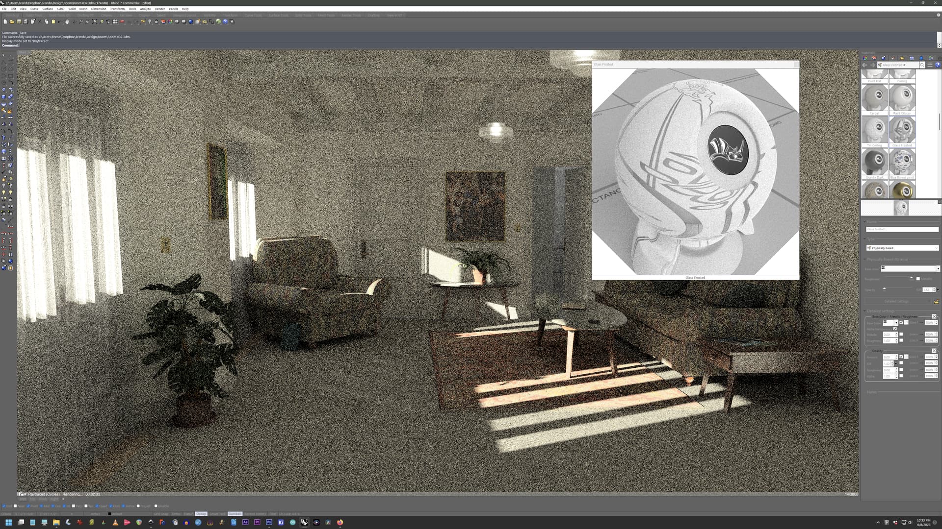

The problem is: I don’t have a good room to shoot it in. I’ve been working on a room background.
The room design was based from a photo, but it’s quite different, now. Noting that I didn’t make the plants or the Standford bunny, the latter of which was originally scanned anyway.
The fun thing is, I’ve hidden 4 graphic Easter Eggs!
  1. Cornell Box: Painting on left (Rhino Cycles Cornell Box)
  2. Utah Teapot: On coffee table
  3. Stanford Bunny (downloaded and inserted) on far table.
  4. Painting of Euclid: Far center
It needs a little more work. It still needs: Something near chair, and something on near table. Because the sun is so bright, now I have lost the frosted windows on the French Doors. The drapes now need to be more transparent to once-again let the French Doors to be see, but then, more sun will come it, and that will have to be lowered.
Also noting: the painting on the right is a Thomas Cole, which no one could afford.
Technically, this temp image was rendered with 9000 passes–and smoothed with Denoiser, which will only denoise bmps, because it throws errors.
The sun is set over 100,000 intensity to give this effect. I had problems making the lamp bright enough, so for now, I put a point light in it, which I hate because the light has no penumbra. The surface lighting on the lamp bulb is over 50,000, which might be out of integer space–unless it’s a long variable.

I fixed the drape transparency. I don’t like to use transparency because the renderer darkens light transparencies. I might try the PBR mode.
The sun going though a transparent PNG doesn’t seem to work, but the Environment lighting going through a transparent PNG does. In other words, the windows have a white patterned frosted effect, which with other lighting become projected in the room, but not with the sun.
Drape Transparency is up to 97%
So Sun brightness is down to 50000.0
Without a point light, Lamp Bulb Surface Emission bulb is an astounding: 900000000.00, hope it’s a long or a float!

Added book by the chair.
Added Magazines on they table. Made with a “Magazine Cover Creator.” The magazines were placed in editing 4x4x4 cage (cagedit) and then bent for gravity. It needed something. Fortunately, they are illegible at a distance, because the month is the same but…
Lightened the wall paint intensity all the way, whilst still keeping any color.
Rendering, now… Let’s see 1000/9000 passes in 3h 2 min. 27 hours for 9000 passes?

This is the current color-corrected draft image. I also used a nVidia’s denoiser on it, though there is 3000 passes, which is about 1/4th of what I run my finals on. I’ve seen noise to 12,000 in some high-contrast images. So, 12,000 might be the placebo line.
The plants need subsurface scattering.
I like how the bumpmapped woodgrain came out. The carpet is really a Rhino material of cloth. The schoolhouse lights were from the bank building, and they were very difficult materials to develop. The table lamp, with it’s small surface area is just apparent–at astronomical emission values. Paintings are a bit red. The wall gradients, which are not easy, come out excellent. The teapot gloss and couch diffuse/albedo shows a nice range of surfaces. We see a bit of radiant splash from the couch on the right wall, carved out from the lamp’s light. We see cooler lighting through the doorway from the environment map and lack of warm sun. In the 4K image, we can see the brushmark bumpmap on the glossy trim.
Noting: Near ceiling light is off because I had accidentally applied a wood-grain texture to it. LOL!. The beam going across had flat finish, which is fixed, now.

Nathen, sorry, I think that the frosted texture may be part of the problem. I am going to have to vectorize it, then turn it back into a bitmap for the noise effect. Let’s see…
I redid the texture, it works somewhat.
Preliminary on “Custom” and not PBR is: Adjusting the transparency from 0% to any other value turns the transparency on/off in a 1-bit binary way. The same thing seems to happen by varying the texture transparency in PhotoShop. If I lower the transparency to 90% in PhotoShop, the stenciling effect is completely gone.
This is disappointing. What I want is the clear to be clear and the rest to be say 75% transparent.
Showing 100% Opaque alpha texture:
So far, the PBR also thinks that the 90% opaque material is totally transparent, BUT, get this, not in the preview.
Showing 90% Opaque alpha texture:
So, it looks that the rendered material preview works right–but the render only understand on/off opacity.
The preview understand 50% opacity, too.
The issue exists both in the PBR and the Rhino transitional/legacy materials.
This is a sample texture. It should be 50% transparent at its most opaque areas, and totally transparent in the others, as PhotoShop understand it.
Which means that light coming through it would be more bright than not, but still have some modulation from the image.

I wouldn’t use a transparent image for transparency, but just a grayscale image. Does the attached help?
opacity.3dm (837.8 KB)
Well, in real life, the glass pattern is clear, and the rest is sandblasted or acid etched.
It seems that transparency .png thing doesn’t work right; perhaps it’s acting strange because the sun is so bright. It’s like as soon as you make it a little transparent, it’s all the way transparent.
I think I have it working. What I did: I made the transparency into a Rhino surfaces. Then, I could adjust the transparency and color for the sheet.
Also, added frames, enlarged Stanford Bunny, changed door hand material to match, turned on closer light, turned book, applied glossy material to beam.
I want to do the final at 8k render at either 6,000 passes desnoised or 12,000 passes. That will take either 3 days or 6 days on my machine. Sigh. The RTX 4070 and 4080 sirens are calling me toward their expensive, rocky, credit-card debt shores.
