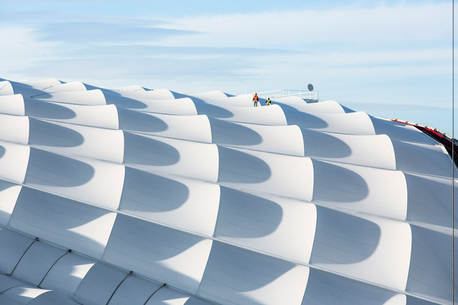

Hello, i’m trying to reproduce this shape of roof for the modelise the velodrome stadium in Marseille (in the second photo), if you know the process or a tuto on youtube it will be very helpful. I’m a begginer on grasshoper, i’m student in third yr of architecture. Thanks for you help.
Here’s {just} a ‘study model’:
rf.gh (54.1 KB)
Note:
I did not take care of the ‘edge’ condition where panels meet the borders of the roof shape:
Sorry for the mess, 'gotta run.
